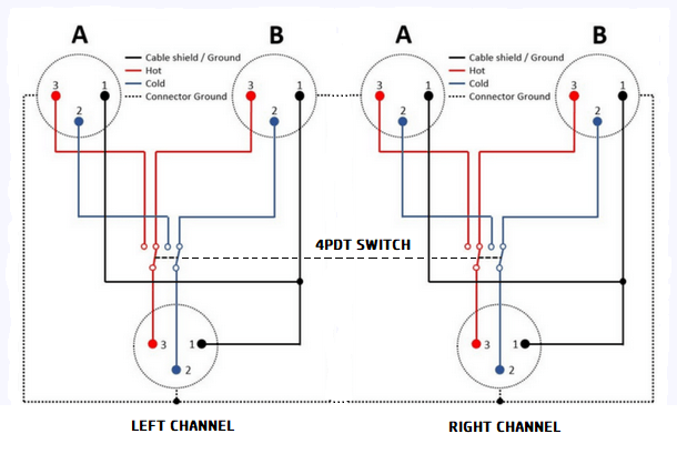

The conundrum I have is that I want to take my main L and R from the Behringer and direct it either into the 2 inputs of the 2i2 (that feed into the Yamaha mixer via its L and R line out), or straight to two XLR inputs on the Yamaha mixer (for applications that won't require the audio interface).
Everyone I've talked to pointed me towards a 4PDT switch - so I got one of these:
https://www.amazon.com/dp/B07VG81BKQ?psc=1&ref=ppx_yo2ov_dt_b_product_details
I'm simply trying to route 1 stereo XLR source in and toggle ON/ON between 2 stereo XLR outputs. How can I wire this up?
Thanks!
This is the wiring diagram of a two channel XLR A/B switcher using a 4PDT switch.
