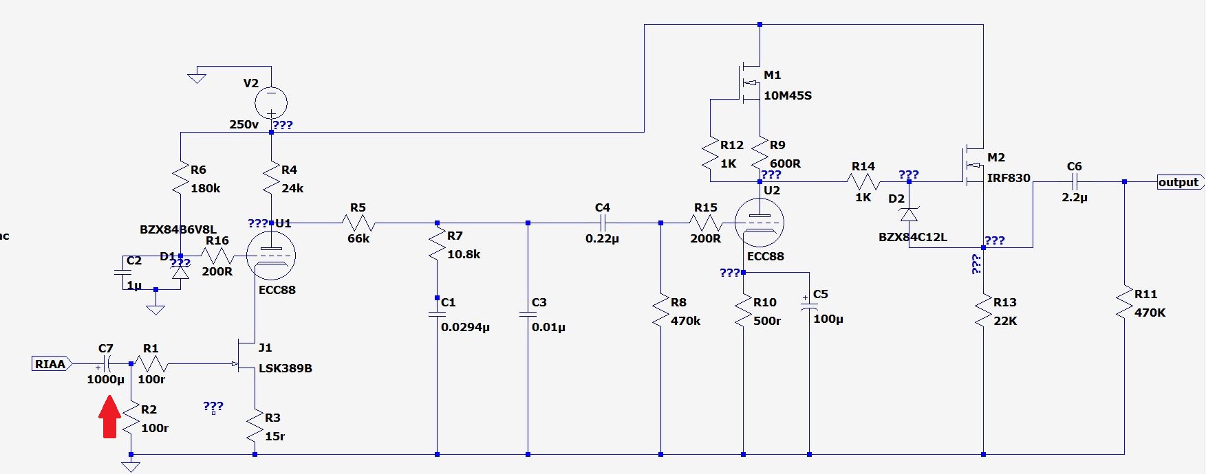

Here it is. Also, I don`t get a spike if I use a Step Up Transformer on the input, without capacitor.

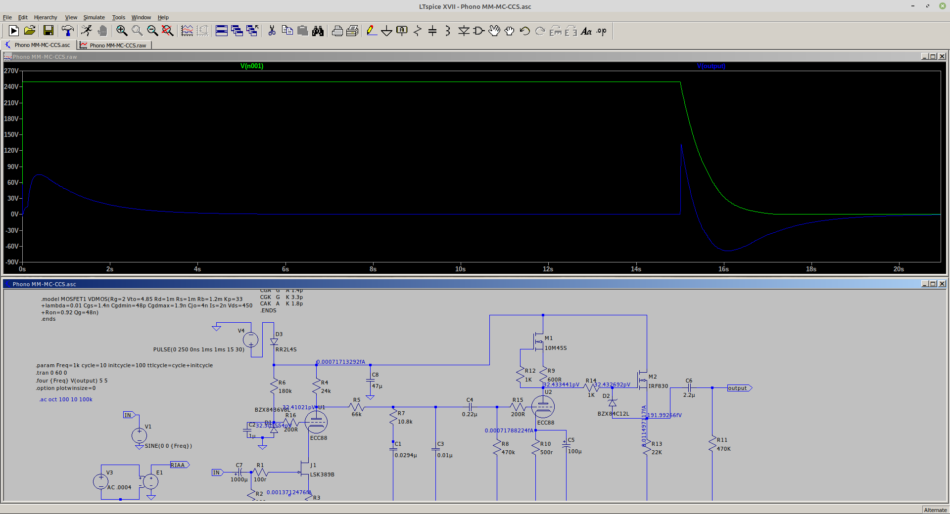

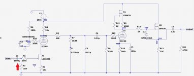

The other issue was the 40V DC voltage spike at the output, when I power OFF the unit. This was fixed by adding a input capacitor. I`m trying to understand the cause of the voltage spike and if there is another fix. I have a mute circuit but the relay does not switch off fast enough to block the voltage spike.
Thanks for suggestion. I wish I was that good in LT Spice and understand how to do it. I can put bits and pieces together, but my knowledge is limited.
I`m attaching the simulation file. Maybe someone can have a look. Thanks.
View attachment Phono MM-MC-CCS.asc
Since your simulating replace the B+ supply (250v) with a pulse source. You can then see the effect of turning on and off the supply.
The problem seems to stem from that when you turn off the supply U1 is taking a constant current. Thus any supply changes appear on the plate of U1. This drives U2 out of conduction causing the big spike. This is bad too as any hum on the supply will get directly into U1 plate and to the output. Maybe split U1 plate resistor and decouple. Actaully seemed to oscillate when supply turned off. Did not find a good solution. Making C4 smaller may help a bit.
