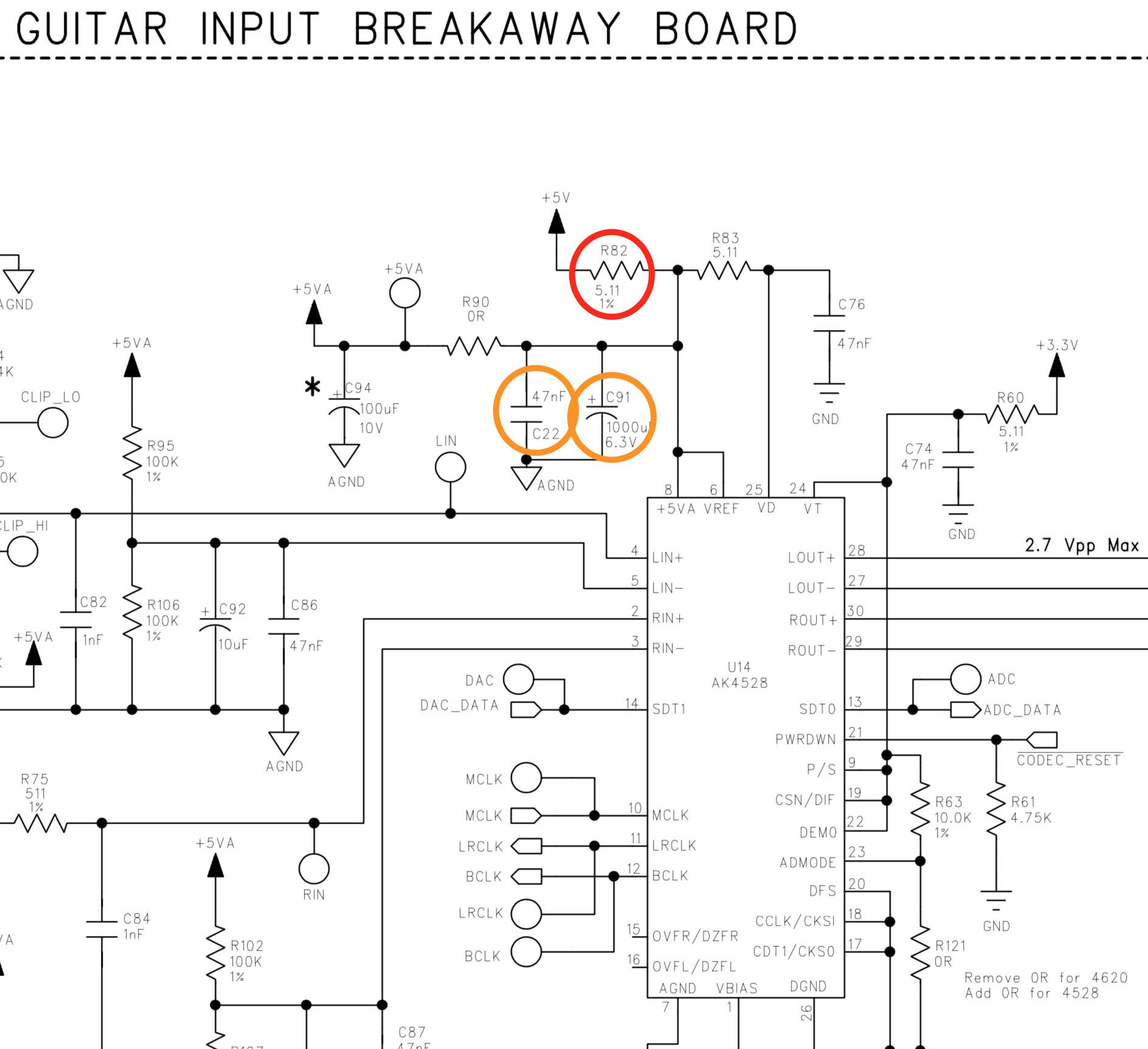

The amp is a line 6 lowdown 300pro. (I'm attaching the schematic).

I looked over the preamp board (page 1 in the schematicl), and found a smd resistor that was fried (R82). I couldn't tell why it had fried.
I replaced it with a regular resistor of same value (5k1).

If R82 burned it is getting loaded possible by the IC U14 or anyplace where the voltage +5VA it is feeding and it is in every place that you see the tag +5VA. You said that you replace the R82 smd resistor with a regular one. Does it get hot? If it get hot means something it loading it. You can do a test by removing the jumper R90 zero ohms resistor and see if still R82 get hot. If still get hot it is possible that U14 it is bad. If does not get hot then the loading it is coming from the left side components. I would check voltages at the Q6 and Q7 emitter pins.
Are you sure R82 is 5k1? Looks to me like 5R11 / 1% -- its the Vref for a bunch of +5V, aside from the 4528.
If it was > 5k there wouldn't be enough voltage in the area to kill it.

You have 4 things to check as one is shorted. U14, C94, C22 or C91. The 5R11 resistor is burned if one of the 4 is BAD.

Thanks for all the info everyone. Most helpful. I checked the four suggested by Audio1Man and I noticed tracing back from U14 via the vbias pin that C96 was shorted - would this have caused R82 to burnout? C96 also has damaged casing.

Good news: I replaced the following components (R82, C22 & C91) and now have a working amp again!
