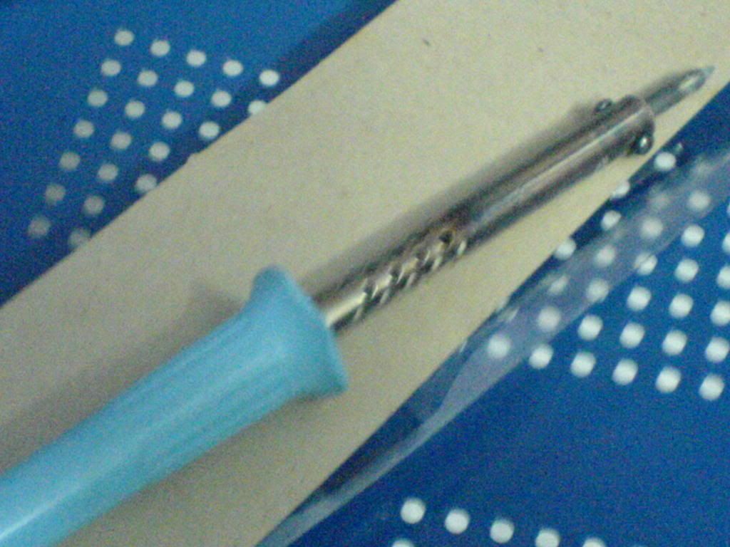

Hi, I want to change the internal speaker cable for my speakers. However i have never done soldering before and now i am having trouble soldering the 14 gauge wire to the tab of the binding post. The problem i have is that the solder does not melt ! First i tried to tin the wire, but after heating the wire long enough that the insulation melted the solder does not get sucked into the wire. This is what i did : i touched the soldering iron on the underside of the wire and touched solder to the top of the wire. Is this the right way ? Am i doing something wrong or the soldering iron not good enough ?

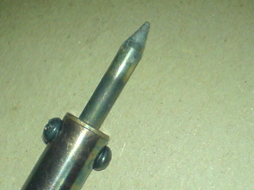

This is the generic 60W iron that i bought for $6. When tinning this iron the solder sticks to it like glue and not flow.
You say that when you try to 'tin' the iron, that the solder "sticks to it like glue, not flowing", that's indication that the iron is not hot enough.
Very typical for a cheap iron, very bad (no) temperature control.

Hang on guys, he's having trouble tinning the iron. If the iron can't melt the solder, he's going nowhere.
Buzzy, it seems your method is OK. I had one of those irons once. One problem is the 2 grub screws. Remove one, and tighten the other, pushing the tip firm against the bore of the barrel. You might then be able to melt the solder to tin the tip.
IIRC, it's only 15 or 20 watt, and took about 15 minutes to come up to temp. Only just big enough to solder small components on PCBs with no crosswind!
Go for a Weller or Hako if you plan to do more soldering. Personally, I don't like crimped connectors.

Where did you get the solder? I purchased some solder from an electronics store last year that was the worst I had ever used. Went down to RadioShack and bought their solder in a tube and it worked fine. I now buy it by the spool from reputable vendors.
A 60 watt iron should be more than enough to do what you are doing. I however, have never liked a round pointed tip for my irons. I prefer a tip with flats. Let the tip corode every where but the very last bit of the tip, around 3/16", helps the heat transfer.

And maybe you should clean your solder tip ... damp paper napkin will do .... when the tip is hot

Geoff H said:Hang on guys, he's having trouble tinning the iron. If the iron can't melt the solder, he's going nowhere.
As far as I can see, he doesn't mention anywhere that he cant tin the iron. On the contrary, hes saying he can heat the wire up hot enough to melt the insulation but not the solder properly.
Aside from a couple of issues with regards to technique maybe, there is the simple fact that this iron may NOT be powerful enough to get the job done.

Fifth element, quoting Buzzy in his first post.
"When tinning this iron the solder sticks to it like glue and not flow."
The iron should be hot enough that the solder should remain "fluid" on the tip, and fall off the tip if tapped or wiped.
I always apply heat on the lower side of multi strand cables, and apply solder to the top. The heat draws the solder through the stands. If the iron is hot enough, and has enough mass in the tip, it's done quickly, and doesn't melt the insulation.
