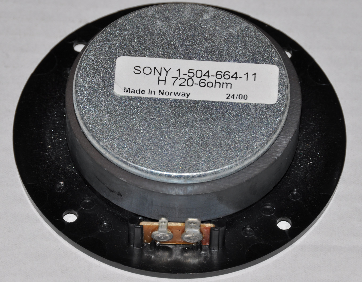

Hi all
Today I fried a tweeter in one of my Sony SS-X7 speakers. It was stupid acting with provisional connectors and my prototype amp that somehow caused extreme noise that made my tweeter die.
I don't know whether Sony will support me and sell me a new tweeter for replacement.
On the backside the tweeter reads:
SONY 1-504-664-11
H 720-6ohm
Made in Norway 24/00
Do you have an idea where to get such a tweeter?
Does anyone recognize this tweeter as a brand X model Y one?
Cone diameter is 1 inch (~25mm).
Magnet has 72mm diameter.
Inner screw mounting diameter is 50mm.
Outer mounting screw diameter is approx 94mm.

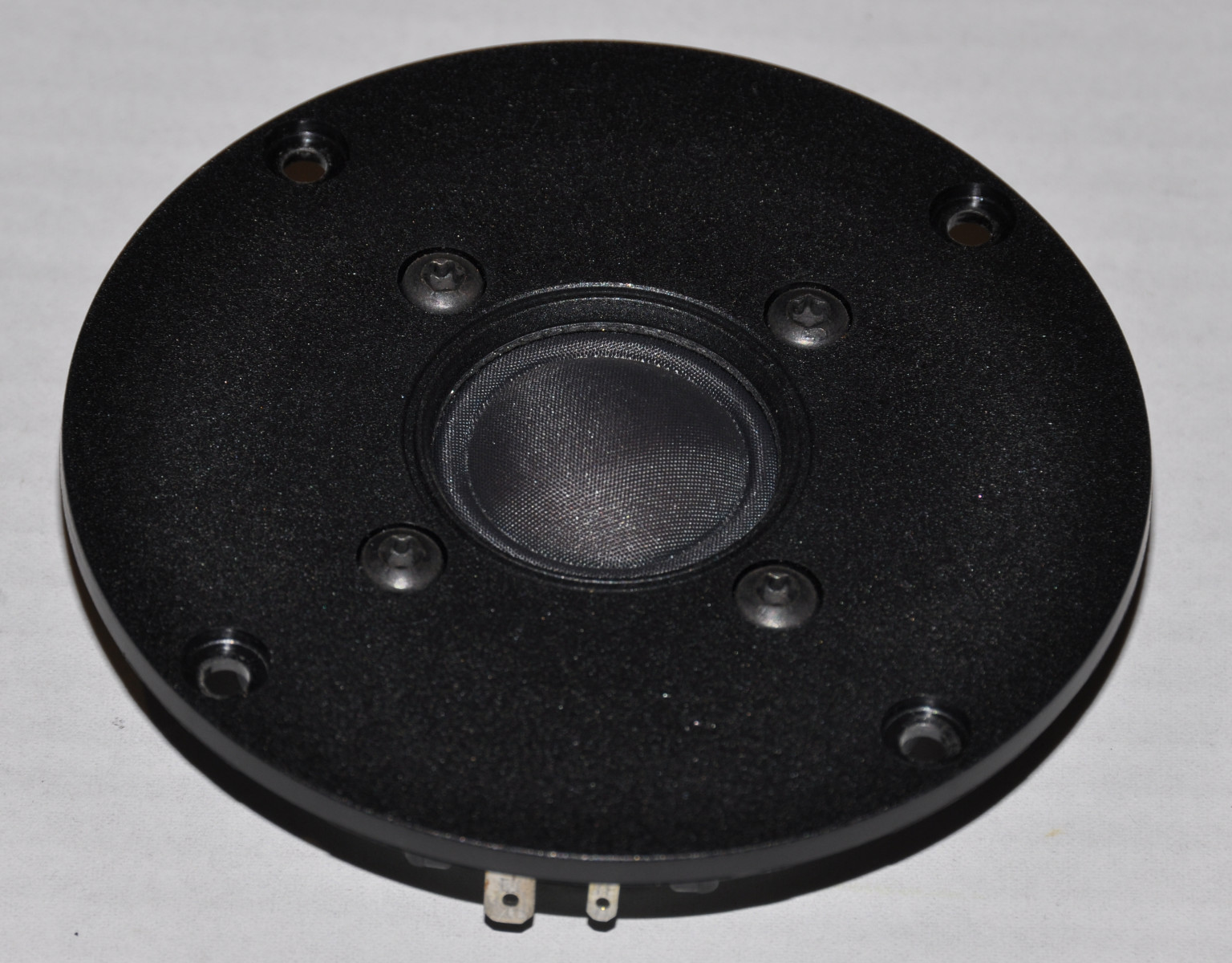

Norway means SEAS, fabric dome, no rear chamber.
These look to have a different faceplate, look closely at the profile around the hole.
Take the dead one apart and tell us whether there is sticky fluid in the magnet gap.
I checked for distributors in Germany and found Intertechnik.
The model numbers there are different what makes it very confusing.
But I saw one that has the terminals the way Sony has them.
Lautsprecher Shop Intertechnik - KT25F | Tweeter :: Seas-Prestige :: Loudspeakers ::
Could this be the one that Sony used?
edit:
Yes! Yes, yes, yes! I measured all distances and it seems this is exactly the tweeter Sony used! 🙂 🙂 🙂
Thank you so much. Without your help I probably wouldn't have found out.

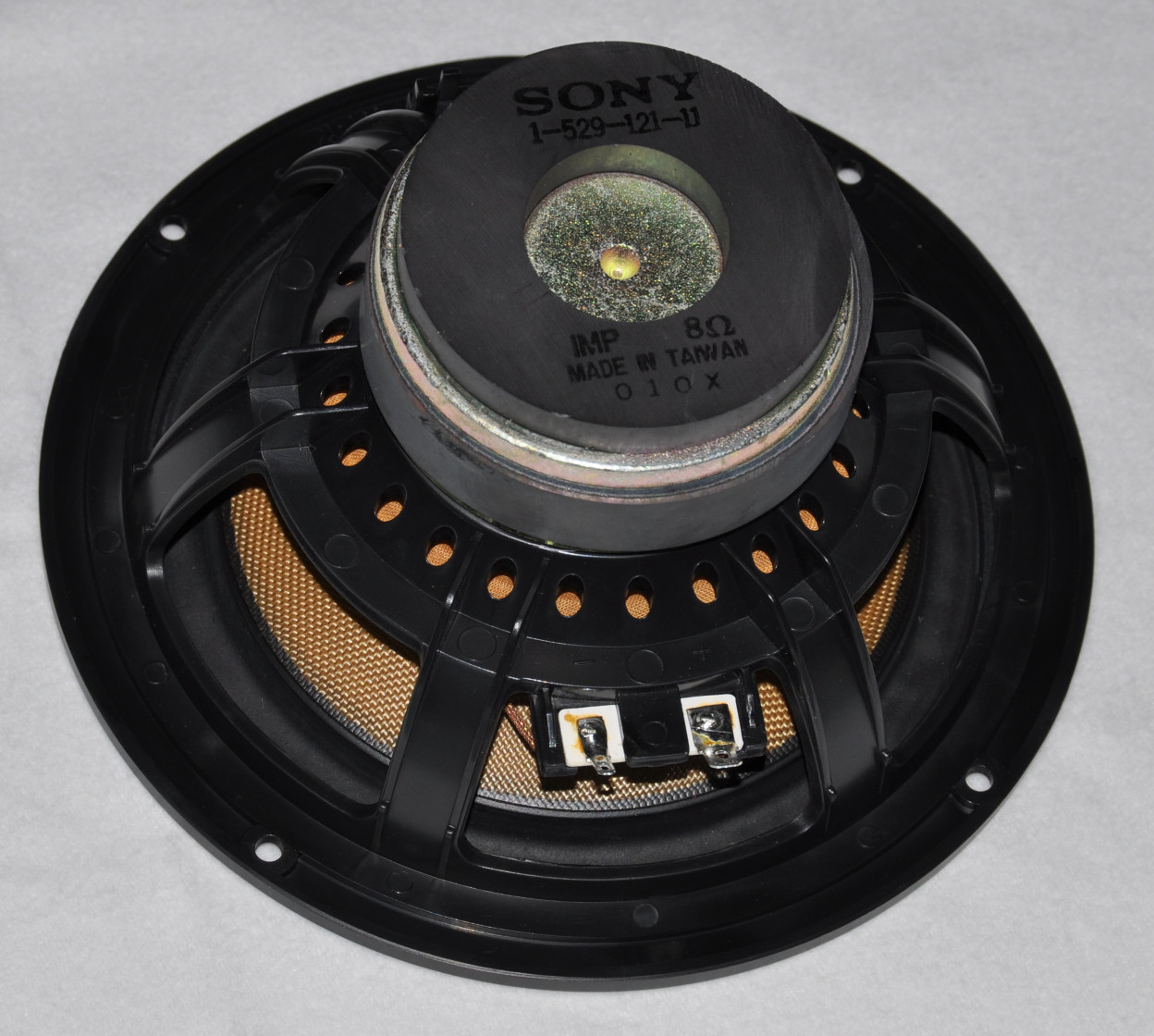

I took out all four low/midrange chassis to measure their Rdc (which was okay) and took a photo of one.
Does someone recognize this one as well? 😉
Surprisingly they have 8 Ohm impedance and cheapest plastic housing. The magnet doesn't look too powerful to me. Can something like this sell as a single part on the HiFi market?
I like the sound of the speakers very much, except the deep bass. I find the bass to be surprisingly deep but boomy and blurred. That's why I used an active crossover and a separate DIY 15" sub all the years.

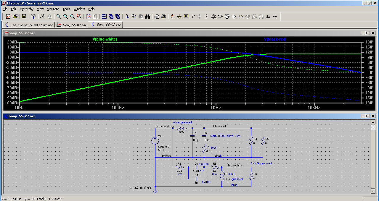

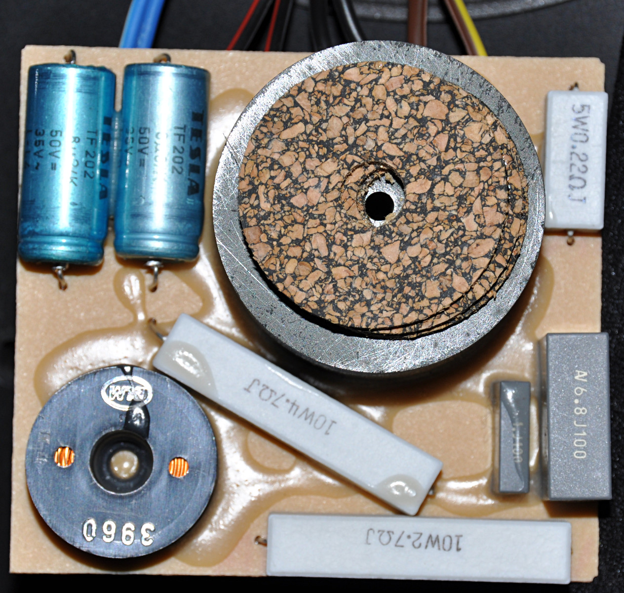

Normal looking schematic. 2nd order with Le compensation. Nothing you do here will alter bass Q much. You'll need to look for a mechanical solution to your problem. Have you tried drinking straws in the port?
Ok, thanks.

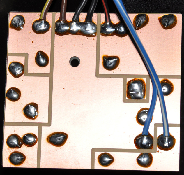

What confused me was that components didn't look like what I calculated. The film capacitors look like a much smaller value, some 100 nF not uF but they could and should be uF. And the inductor for the HP looked like a much smaller value but calculation said it should be this big.
The R-C parallel to the low/midrange is for compensation, right?
And the 2.7R in series with the tweeter - could it be to match the more efficient tweeter to the less efficient low/midrange?
