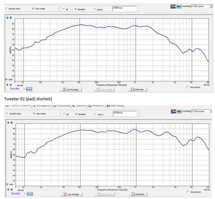

N noah katz Member Joined 2004 2020-12-02 6:47 pm #21 2020-12-02 6:47 pm #21 Test conditions were not great, too many nearby surfaces. I did measure the tweeter with just a 4.7 uF protection cap and the results were pretty much the same above XO.
