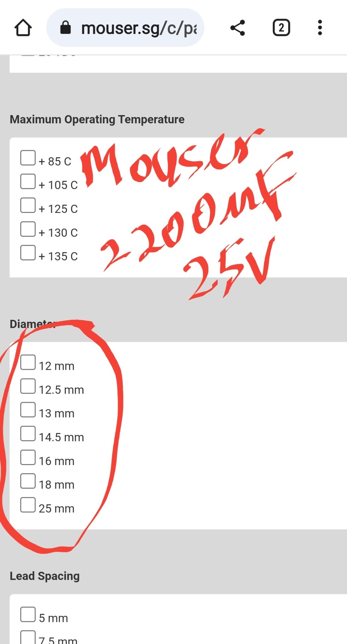

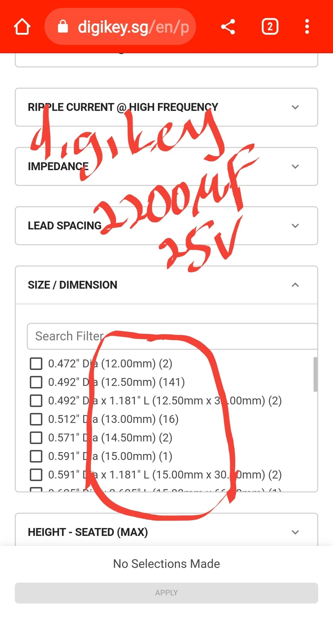

Searched mouser and digikey ... even 2200uf 25v at minimum 12mm diameter which makes them impossible to be used 😪

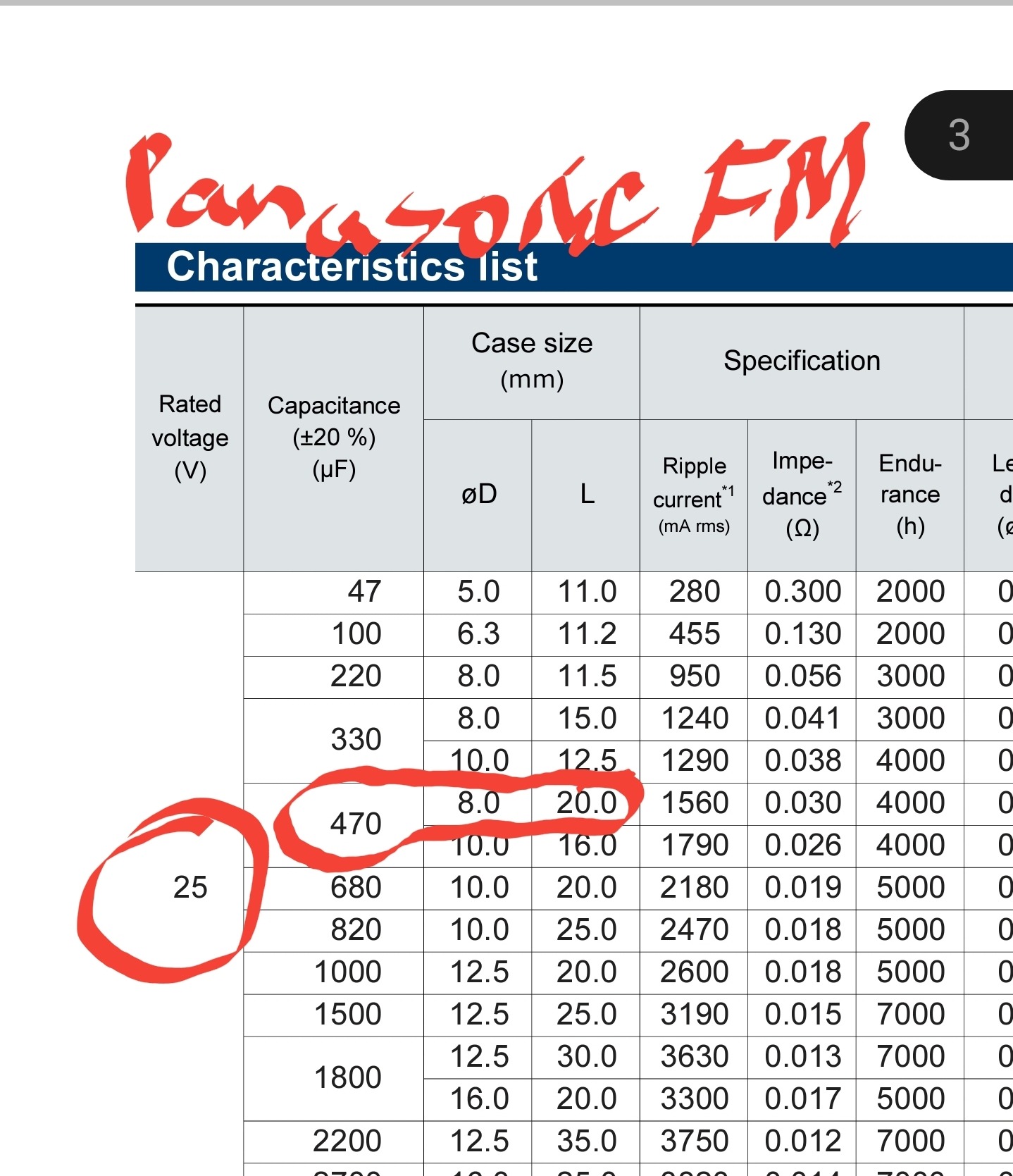

Max of 470uf for 25v at same 8mm diameter 🤒

Suggest that you use DIgikey's tool to characterize the capacitor needed, that is much easier.
https://www.digikey.com/en/products/filter/aluminum-electrolytic-capacitors/58
