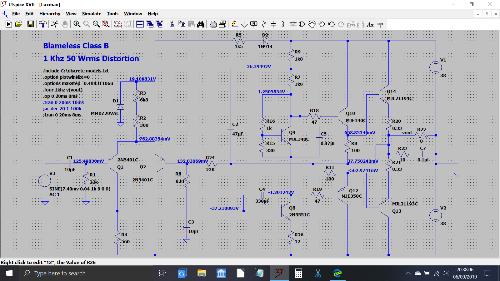

I've just done a quick hatchet job on Doug Selfs amplifier which is actually very similar in outline to yours. This shows the voltages in a simulation and curiously the offset is not quite zero even when the preset is turned all the way down.
Just a bit of fun trying this 🙂

Having a selection of transistors to match is one way to get a better result, however it still may not be quite as you expect because the circuit itself isn't properly balanced. Ideally you want a pair of transistors to give no offset when the preset is in the middle. Why in the middle? Because that is in the centre of the range of adjustment that the manufacturer designed into the amp.
The ideal match to give no offset under those conditions will almost certainly not be a pair of devices that match electrically. Many amplifier are designed with DC precision in mind these days... this is not one of them 😉
In the simulation of the amp, if the preset is centred and matched devices used (and they are 100% matched because the simulation model of the part is the same) then the offset is over 100 millivolts.
The 25mv offset (even 80mv) isn't going to cause any issues.
You could always alter that resistor in series with the preset to give you a tiny bit more adjustment range if you really want to see 0.00 offset. Or you could try a slightly different zener voltage or 😱 you could also remove the other channels transistors and try and get a better match using all four devices to play with.
