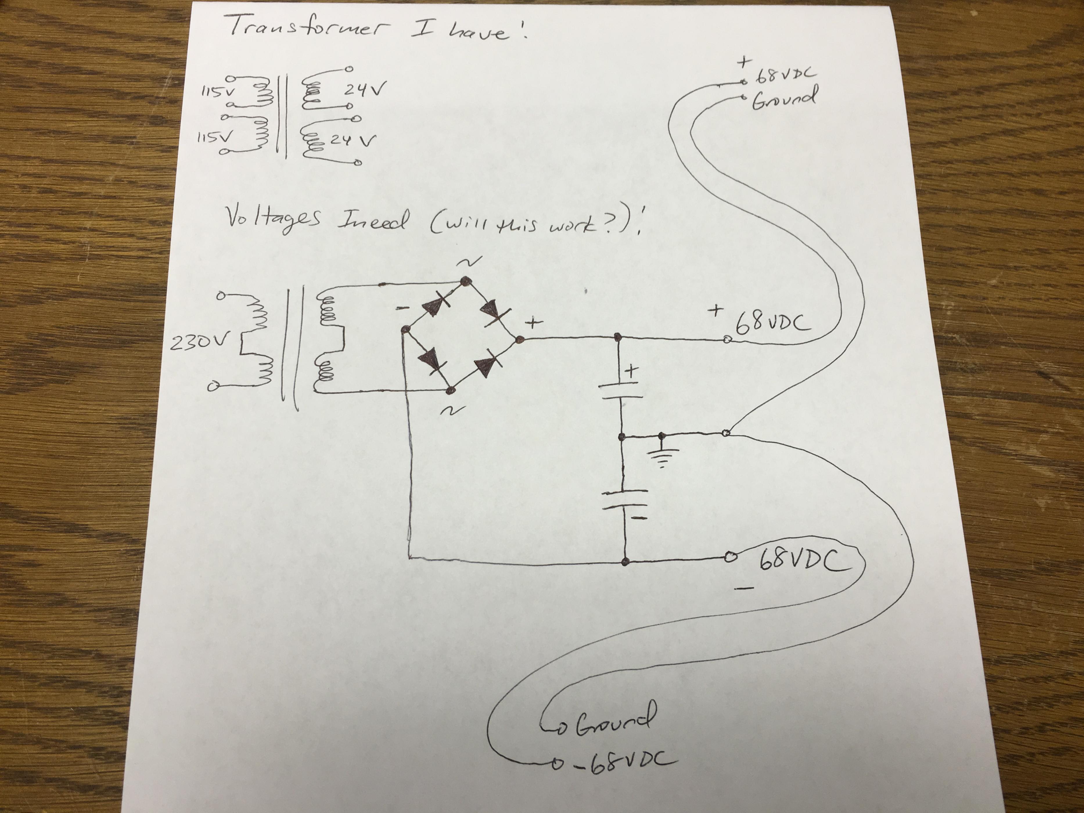

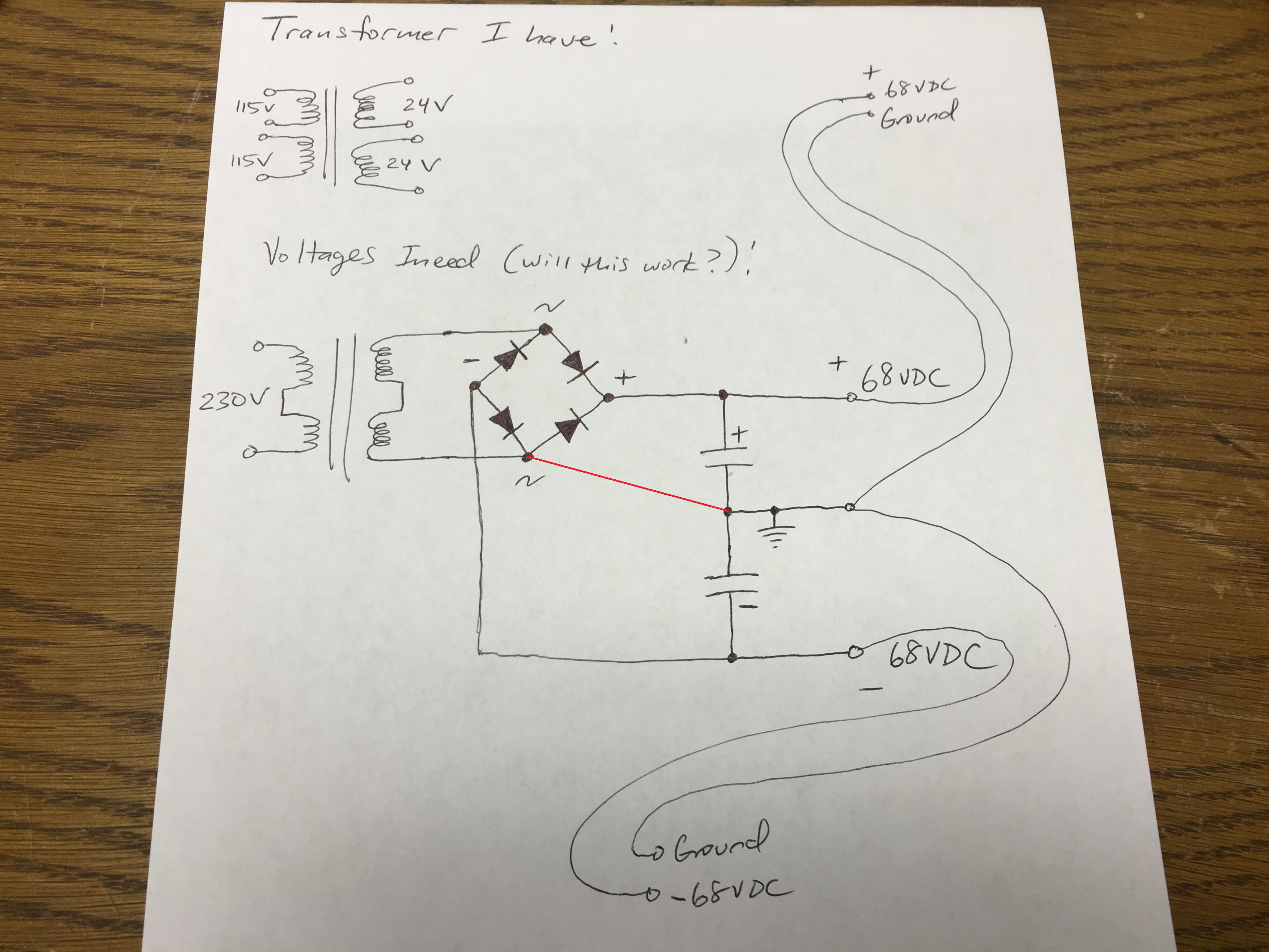

Need help to double check power supply.
I want to use a transformer that I currently have to get the voltages I need. Can someone please double check to see if this looks good? Or if there's a more elegant solution.
