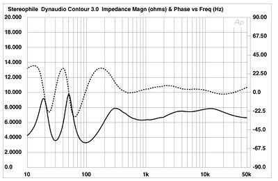

Can a link to the impedance curve of the speakers be provided? Dips in the curve, at low frequencies could easily cause what you hear. Unfortunately, my instincts tell me that synergy between these (presumably) otherwise satisfactory items is not to be had.

I can't find a curve for my specific model, but the most of the impedance curves I find for other Dynaudio speakers have dips in the lower frequencies. The contour 3.0 would be most close to my speakers and the curve looks like this:
attachment.php

Not disagreeing with other members, but one needs to be careful in comparing 'other' amplifiers and 'other' loudspeakers. You live in a big city; is there no one where you can take your amplifier for a direct comparison? In the graphs you have given there are two peaks in the bass region, and it might be that those influence bass audibility.
