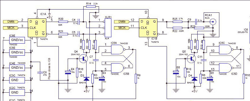

I received this from CEC today. Looks like the CEC needs a little work inside.
"When TL51X detects a DA converter via digital cables it makes the output, but some DA converters may have no such standard trigger in the digital input circuit.
If you may put 1k ohm resistor in your digital cable, the condition will mostly solved. Our service department for domestic (Japanese) customers is adding this 1k ohm resistor inside of the CD transport on digital output board instead of outer cable.
Location of new resister to be mounted:
RCA (inside): one resistor between center (cold) and one four corner (hot)
XLR (inside): total two resistors, one each between ground and hot/cold"

My job was simple. While the transport is turned on, use a screw driver to short the center pin and ground of the coaxiel cable, plug the cable to the D/A which is already at on mode. Press the play button and there it works. However, you have to repeat the same procedure if you turned off your CD player.
