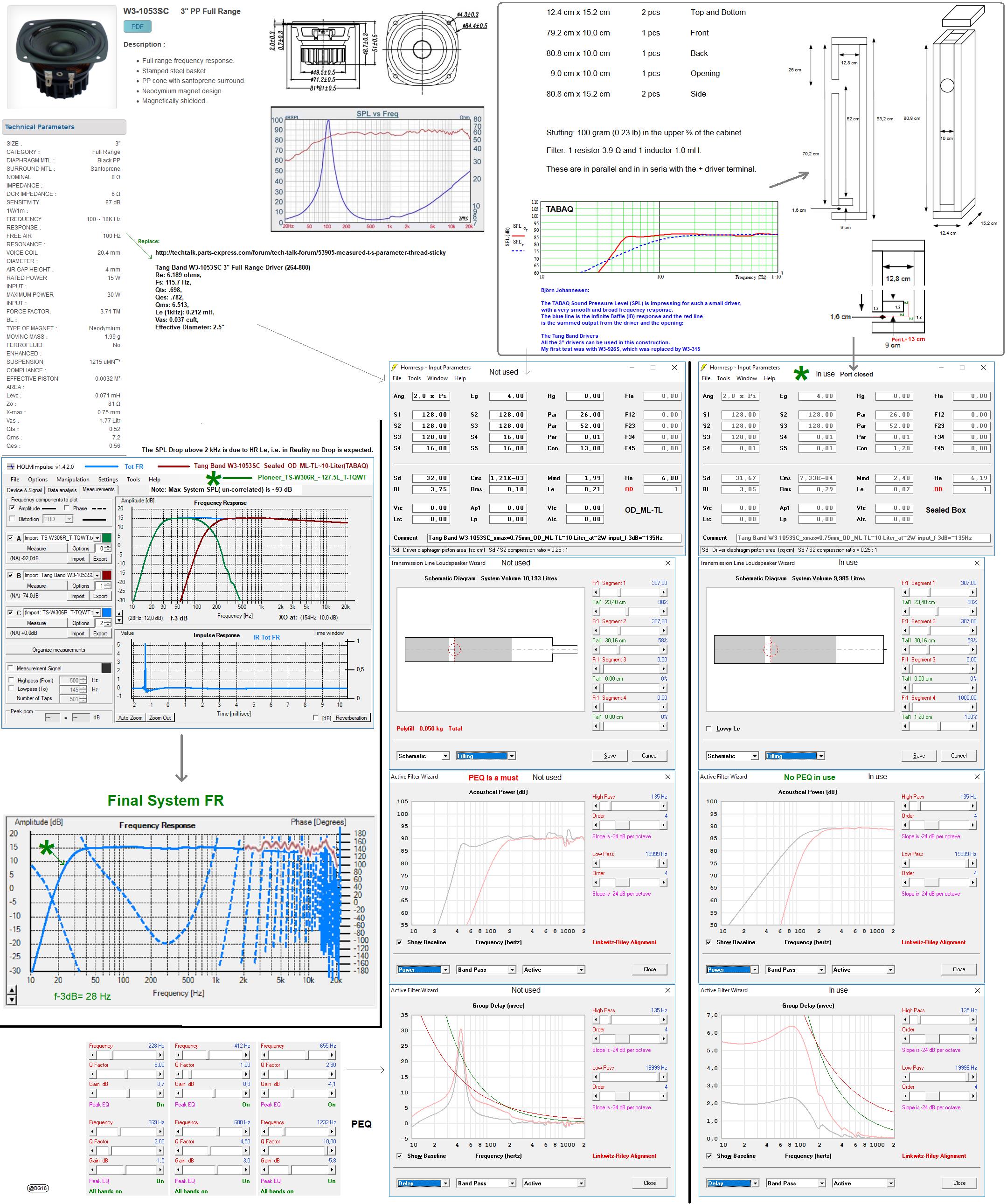

Hi All,
FYI:
b🙂

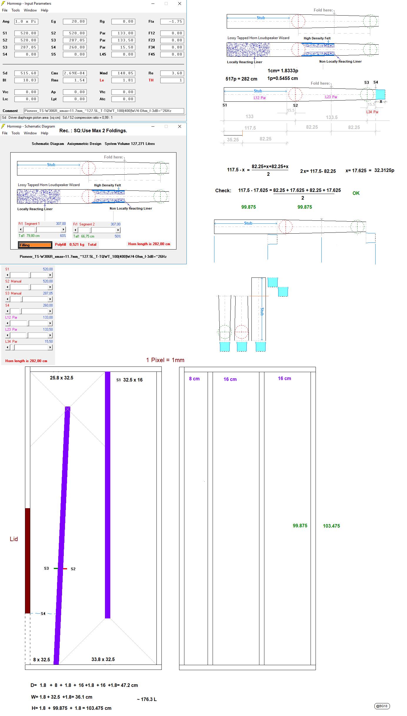

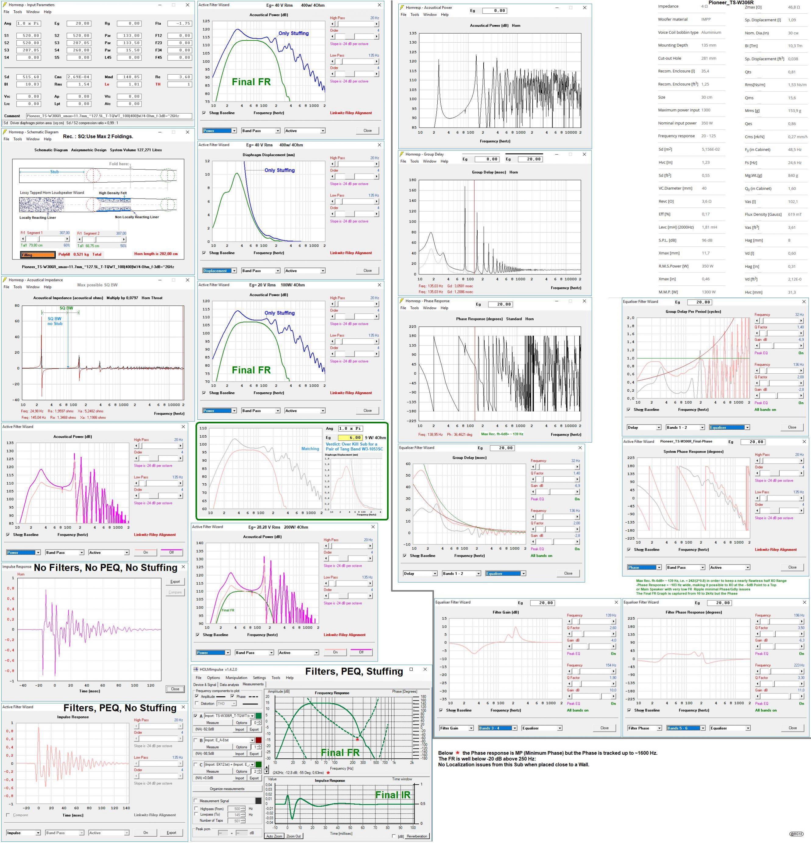

Hi All,
FYI:
b🙂
WOW ! Lots of graphs 😀
Thanks for taking your time out modelling the design. But, sorry to say that I'm not knowledgeable enough to understand what your graphs and charts say 😱
So, let me type what I understand from your post.
1. You have modeled the sub in band pass type enclosure.
But, what could be the dimensions ?
I just cannot decipher anything regarding dimensions of the enclosure from that graph.
Can anyone help me ?
2. The ideal cross over point is 154 hz.
Ok, so, I need to set 154hz as the XO in the amp, right ?
The 2.1 amp I bought is still in transit. I'll check it out when I get it.
3. You want me to close the port hole of the TABAQ ?
Look at the second picture in the link. It is the driver frequency response with (bold black line) and without (thin blue line) RLC compensation. The biggest effect is at 3-4 kHz, but it is very broad - from 500 Hz till 10 kHz, to produce rather even and flat frequency response.
