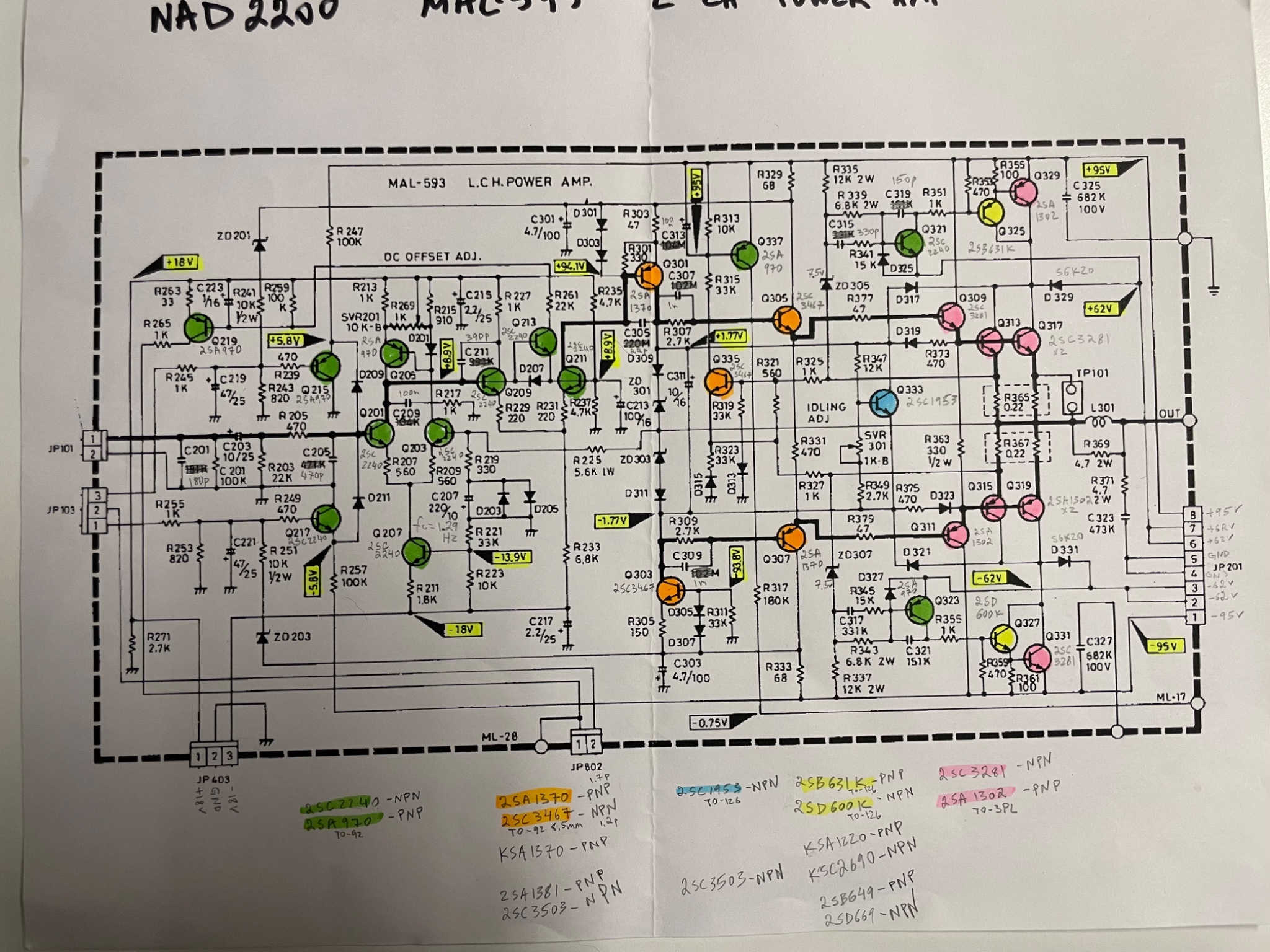

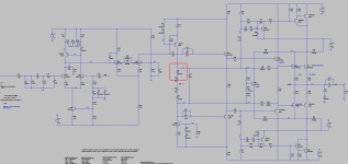

Hello all!

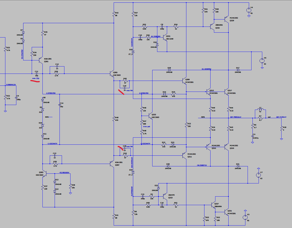

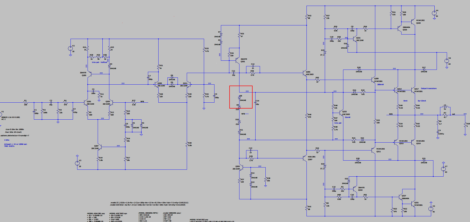

I have recently purchased NAD 2200 amplifier but was wondering if I could improve on the schematics. It is probably as good as it is already, but I still wanted to try.
So I have put together simulation in LTSpice from the service manual.
Unfortunately it doesn't word.
Will appreciate if someone could help and point at why it might not work!
Attached are sim files and schematics from the service manual.
Thank you!

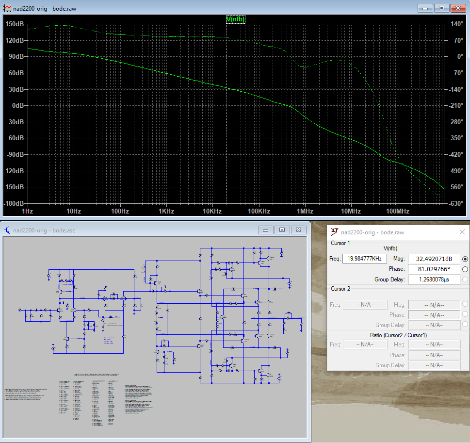

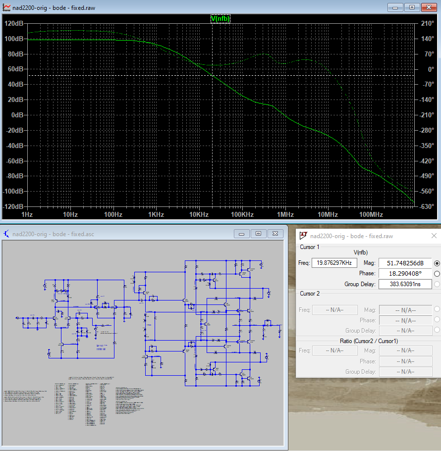

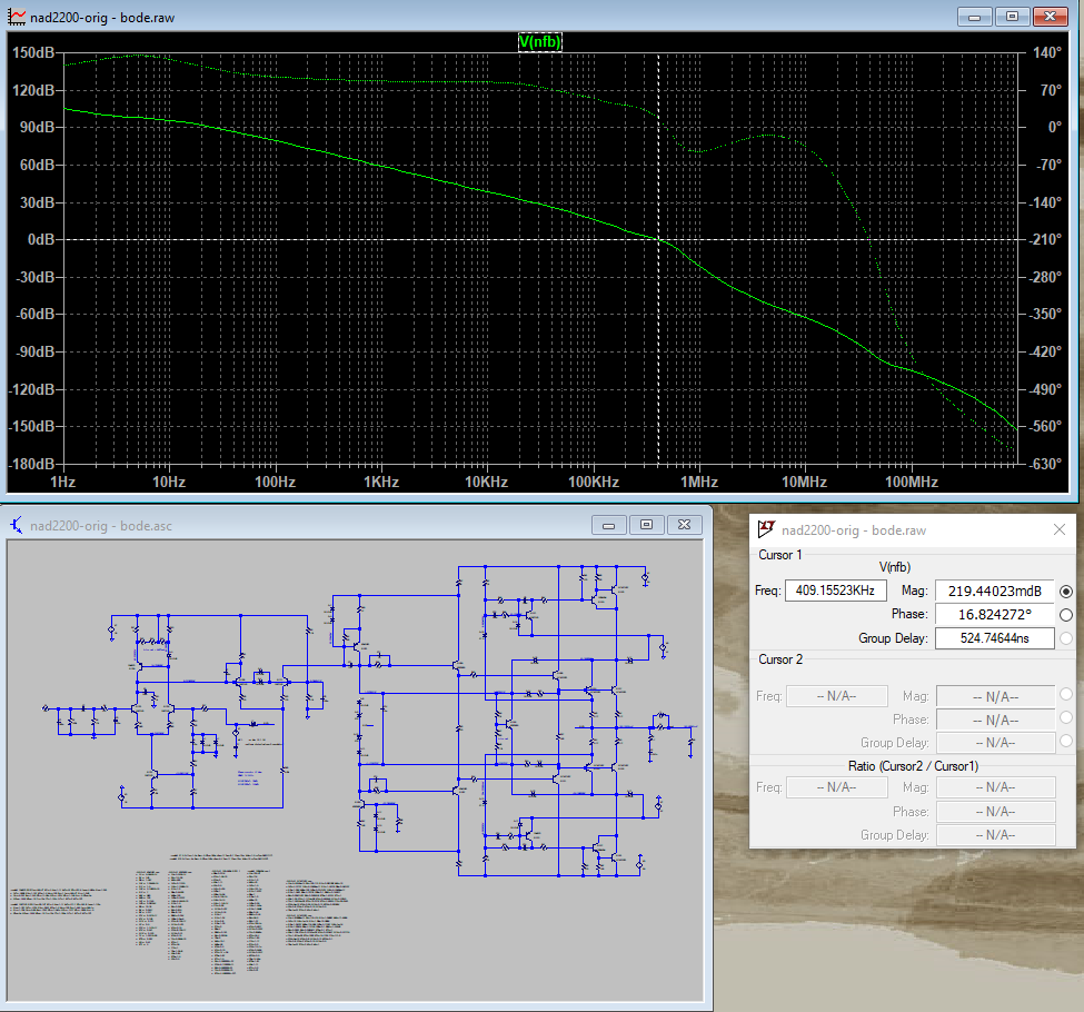

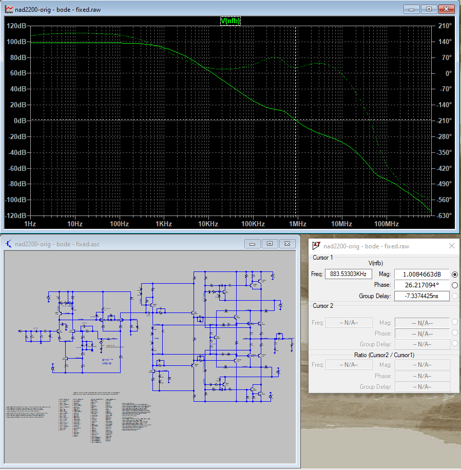

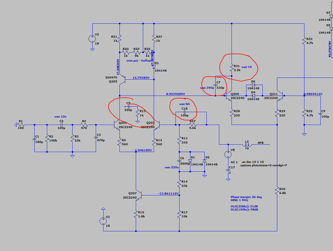

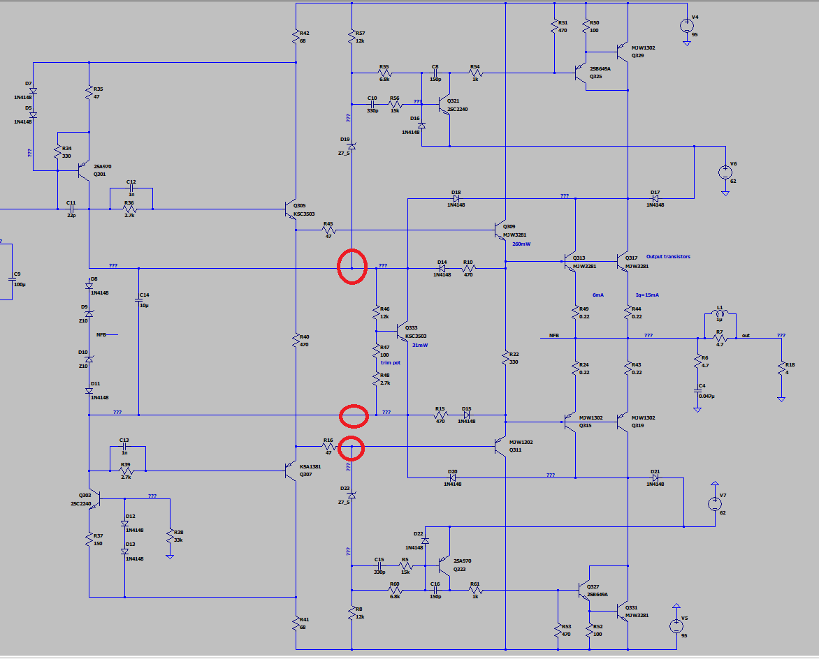

Ok, I think I was able to get max phase margin vs open loop gain out of it.
Phase margin was only 16 deg.
Increased to 27 deg.
While extending OLG from 30dB to 50dB at 20kHz.
