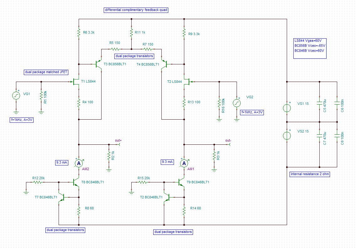

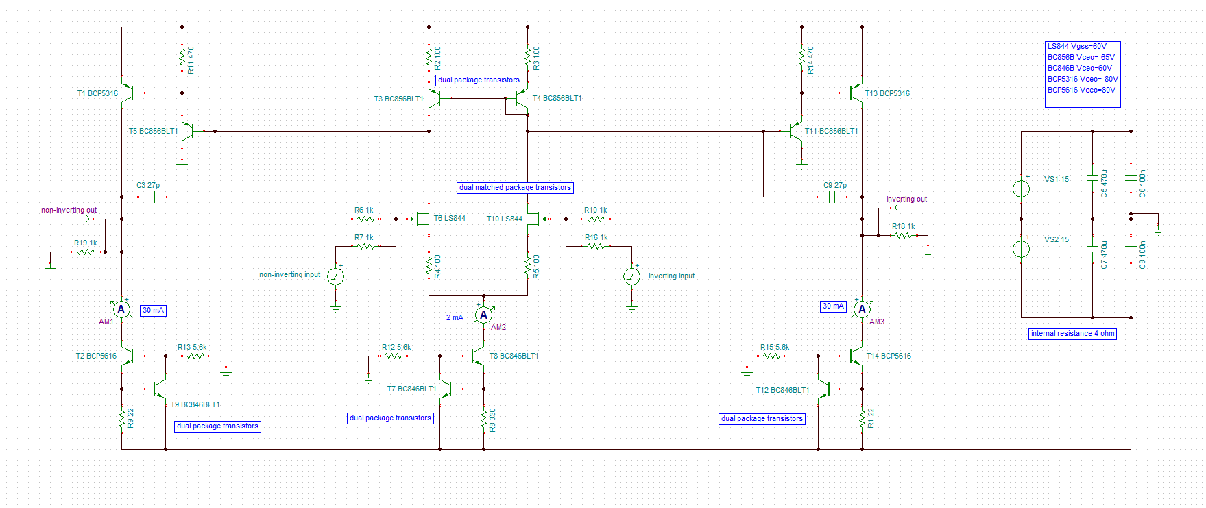

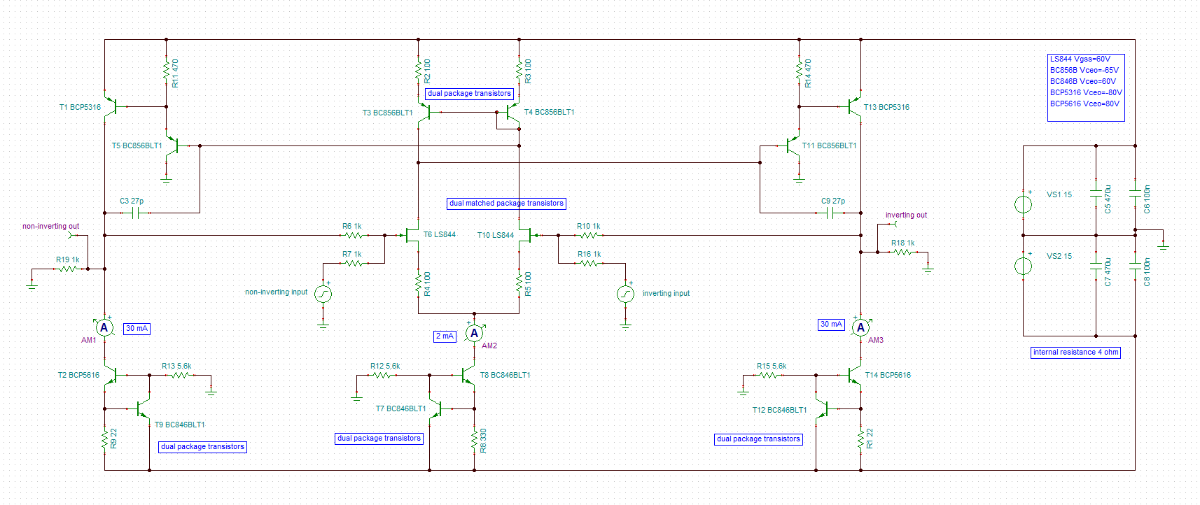

I have been doing layout for the balanced inputs using previously discussed voltage follower schematics.
Basically was making two exact copies for each side of swing.
But then upon thinking more on it, I think there should be a better way.
Fully differential discrete voltage follower.
I have put together schematics in TINA TI, but I am still in lack of experience to make it work. just relates the concept
As always, attahced
Maybe I should do something like this for LTP?
As always, attahced

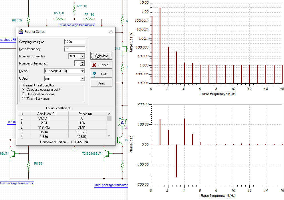

Complimentary feedback quad for balanced signals.
Less parts, same result.
Just what I needed for my balanced input LM3886 boards.
By adjusting resistor values it is possible to make it produce 2nd harmonics. Still pretty low distortion.
