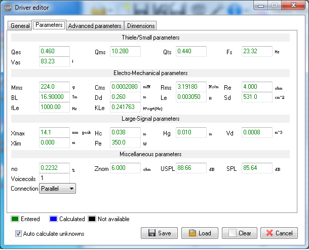

I have attached WinISD simulation for this dual series arrangement. however WinISD only give parallel option, it can't be changed. with Q 0.707 the volume will be 112ltr, do you have any target Q estimation for that compensation? increasing the volume into 140Ltr resulting Q into 0.664.
btw, I find that T/S parameter for Vas provided by WinISD (83Ltr) vs is different with downloaded PDF (100Ltr). which one is usually correct?

Not really beyond make it as large as you can tolerate since in some HIFI/HT apps the driver's Qts can double in bass heavy soundtracks, requiring this driver to be tuned to the transient perfect 0.5 Qtc and maybe still technically too small, so some form of hi-pass EQ is normally used.
Probably neither since apparently WinISD calculated Vas Vs the pub's measured spec; IOW they should have matched and a good way to check accuracy if enough specs are provided; so again, when in doubt go with whichever calculates the largest cab for any baseline cab alignment to start with if for no other reason than it's a lot easier to 'shrink' it than enlarge it, though sealed is much more tolerant of cab net Vb tolerances than vented alignments.

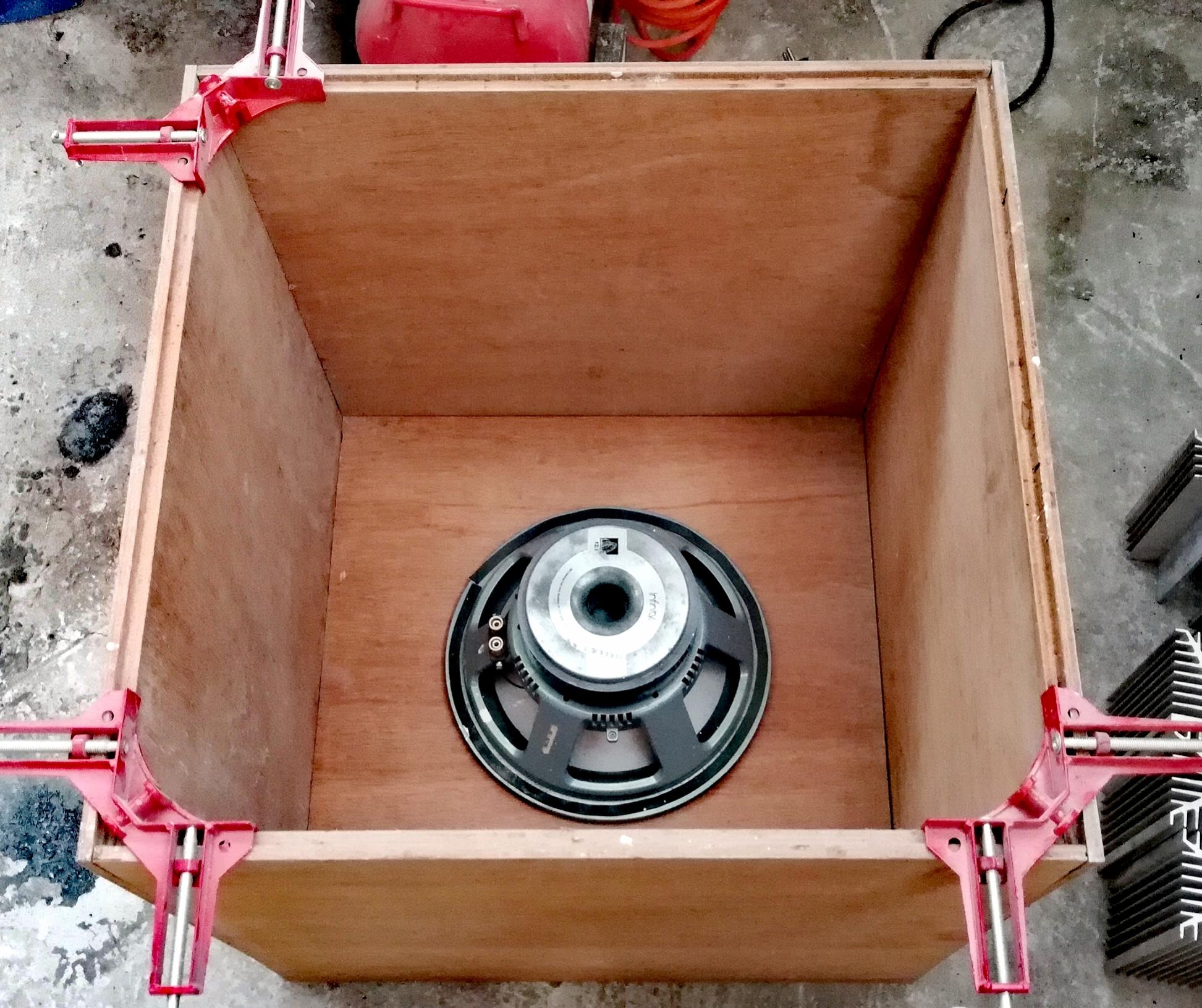

after almost 1yr finishing my renovation, started to continue this build. dry fitting outside walls with 18mm ply 55x55x53cm which roughly around 145L volume to get 0.7 Q, stuffing might be added or not later
I'm still planning and making layout on bracing and adding 1 more plywood to make thicker wall

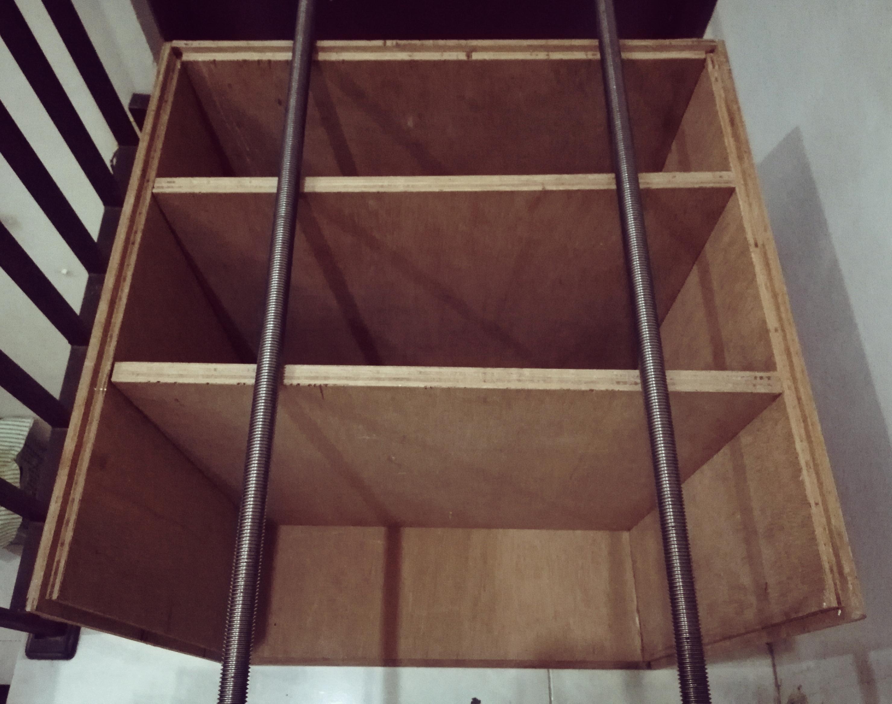

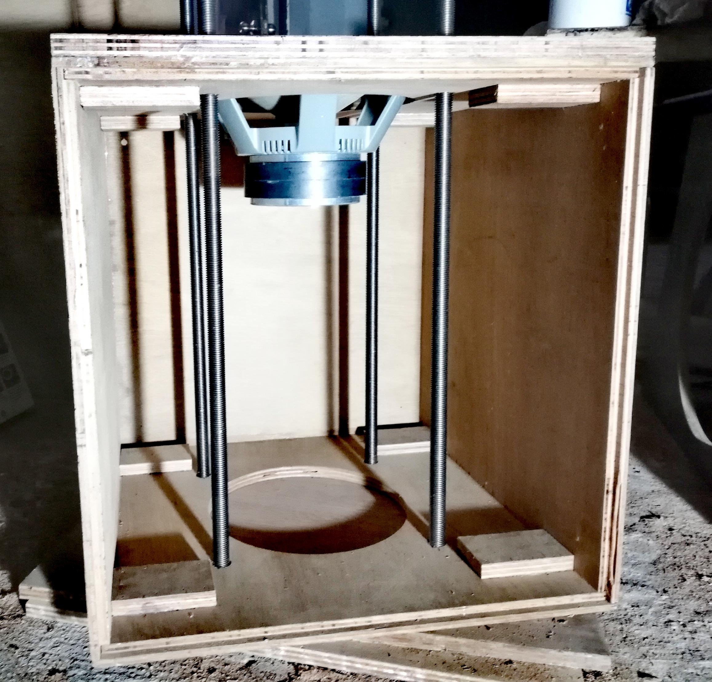

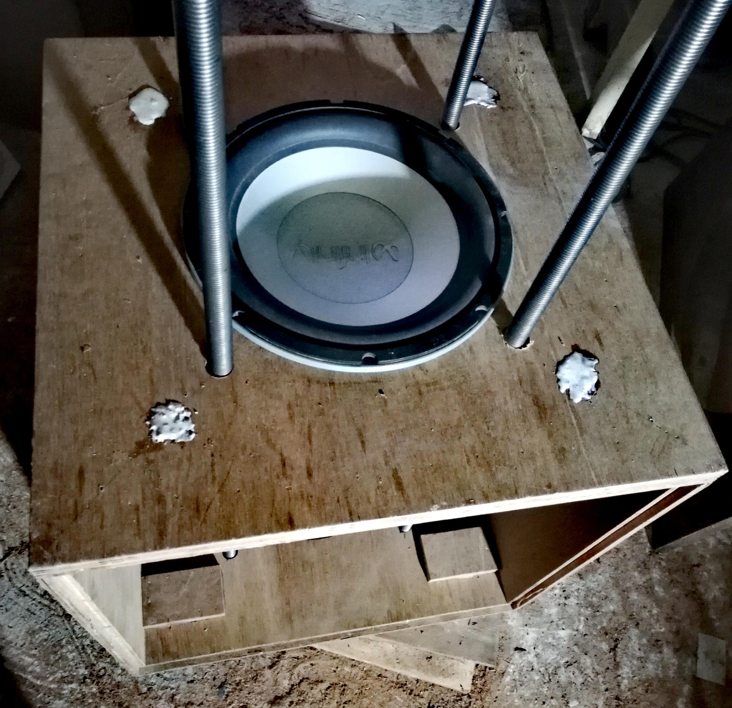

there will be 2 braces plus 4pcs of 20mm threaded rod connecting the walls that driver set and the braces will be locked thru threaded rod.

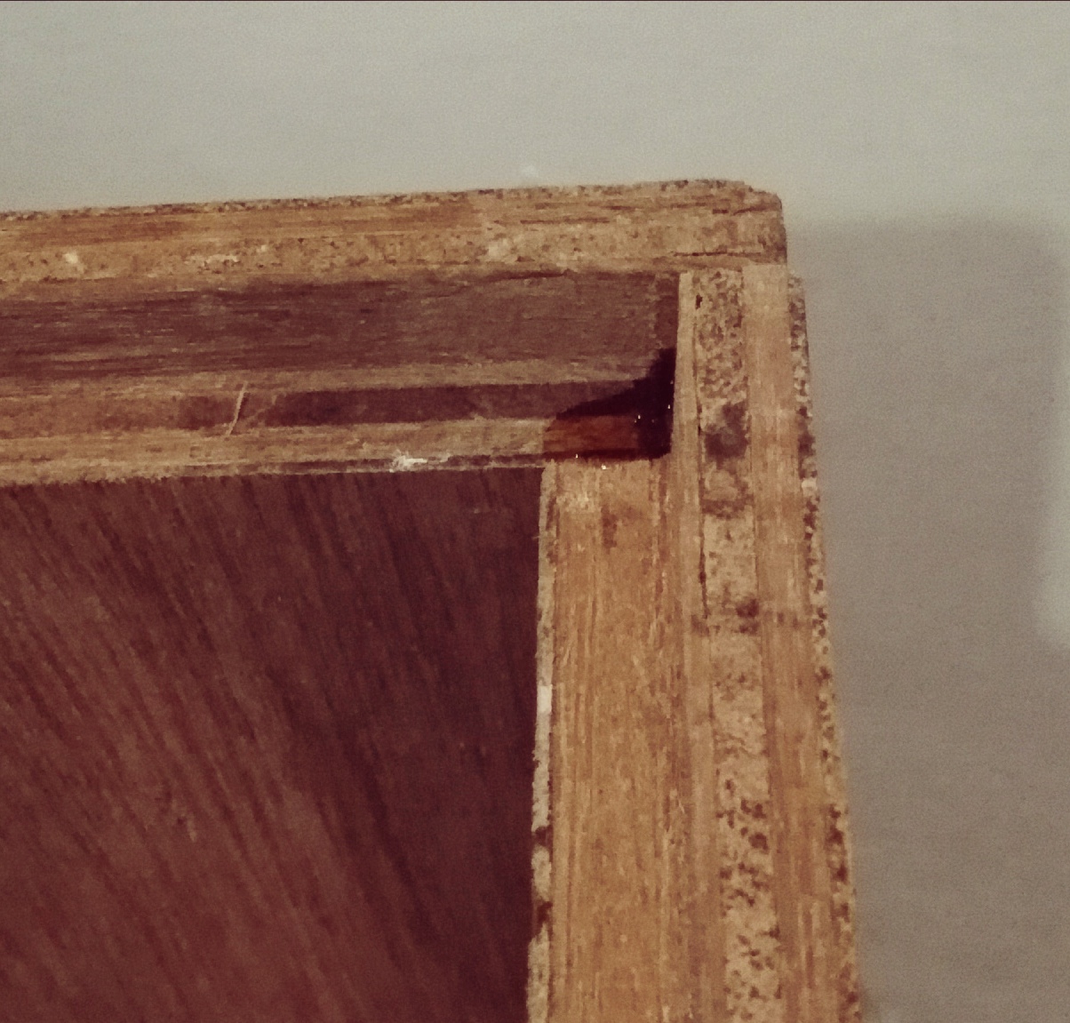

because I'm using rabbet join, alot of fine adjustment required to lock the panel accordingly. I spend alot of time to do allignment with corner clamps and belt clamps then I decided just hold it by hand then use nail gun. the result is incredibly good for first time build.

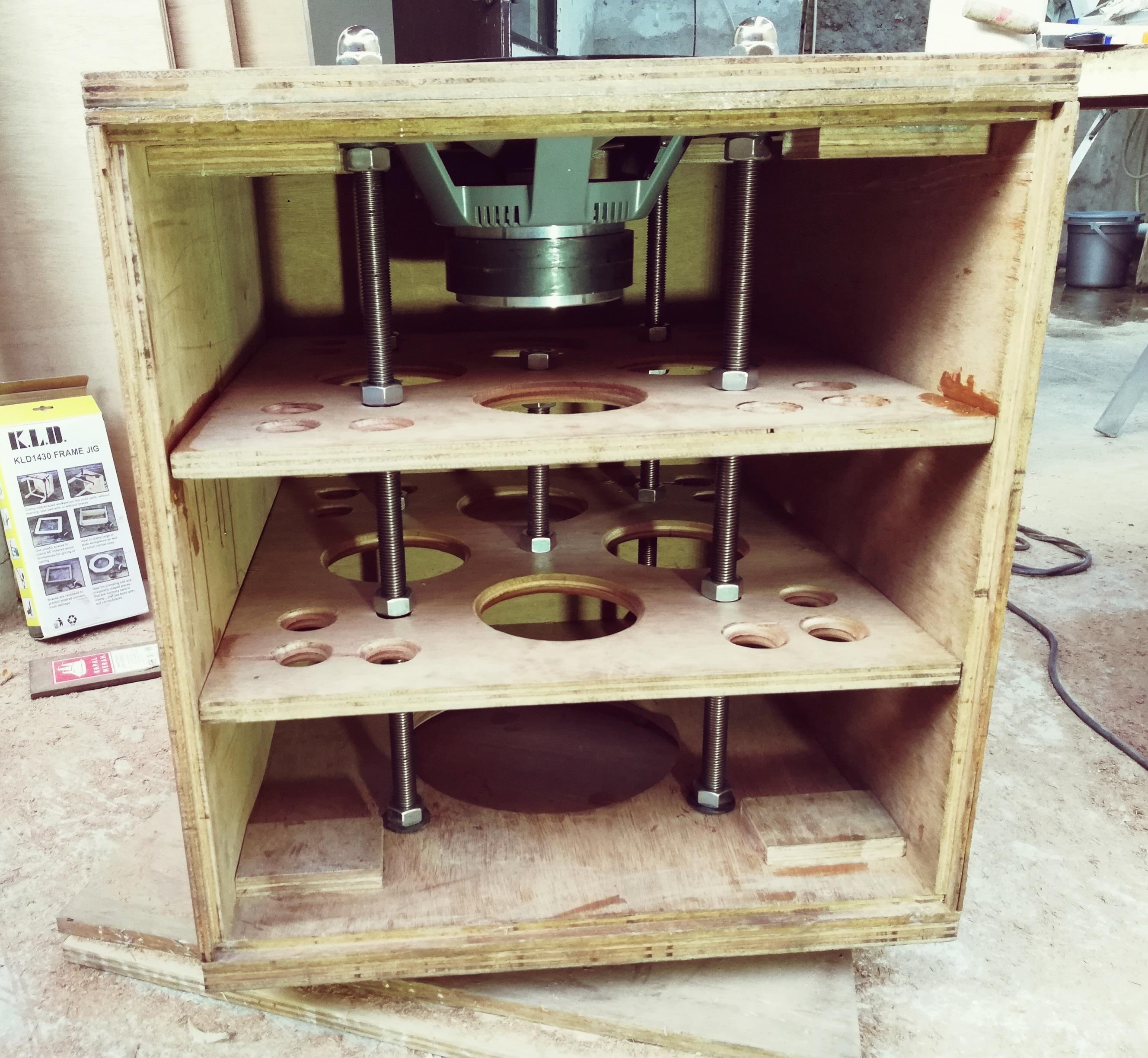

glueing 2nd layer plywood and now i realise threaded rod hole is too far away from the center. that is the result of drilling holes before fitting the driver. I have moved it closer to the center and it's very sturdy now.
lifting 1 sheet of plywood was very hard alone, but now when thay are packed then center of mass make it easier to lift, not as heavy as i thought

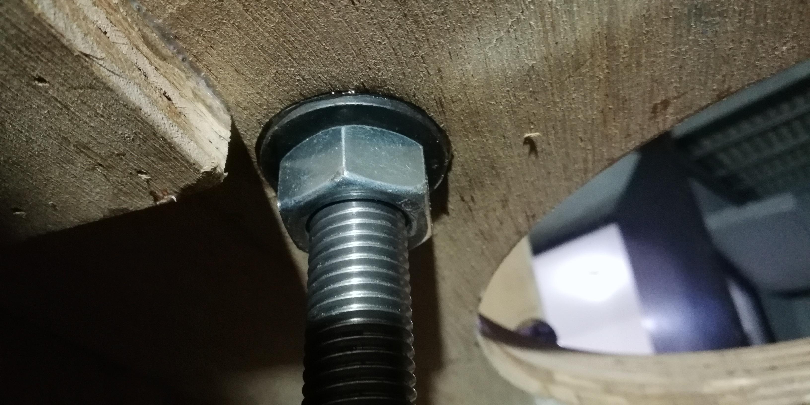

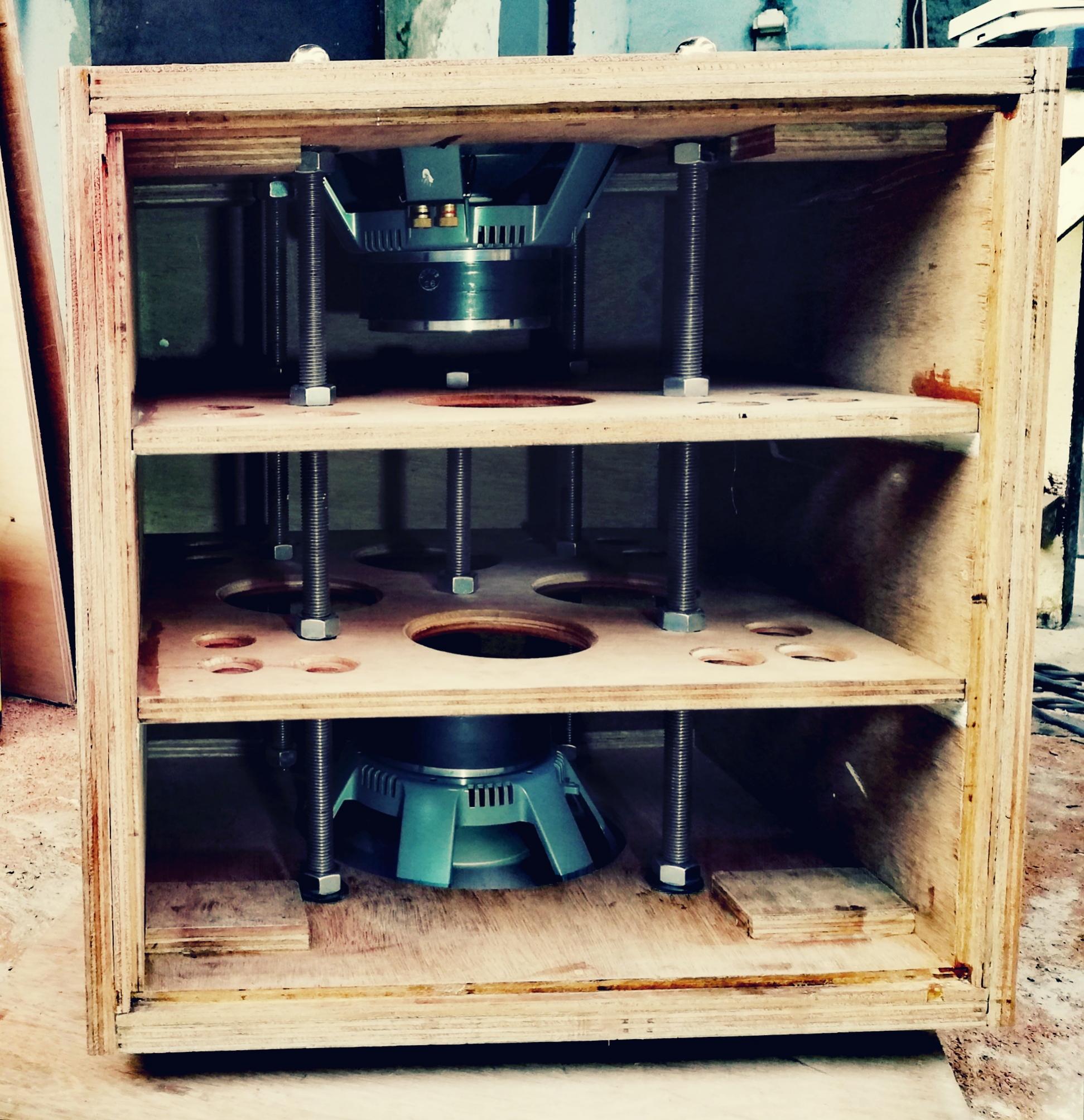

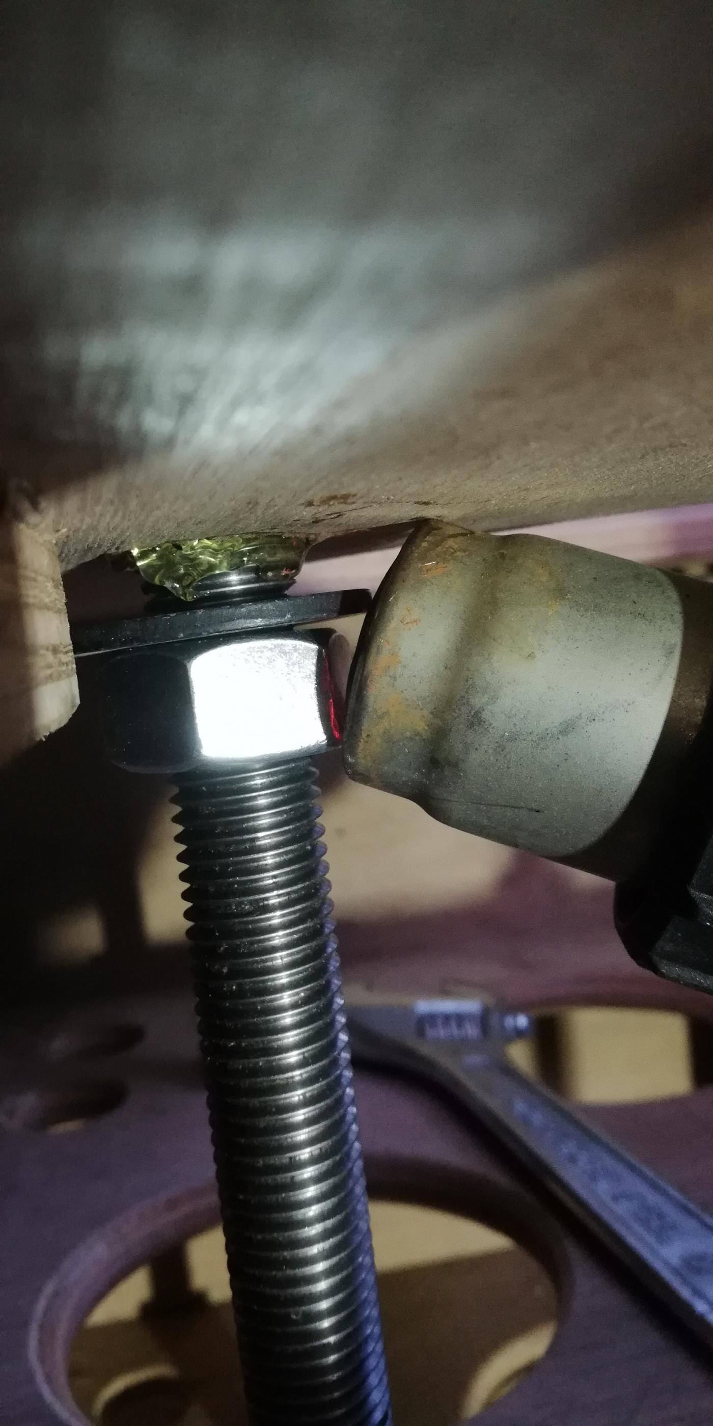

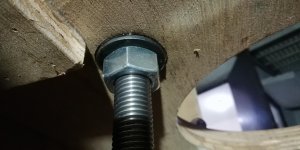

brace assembled but not glued yet, i have to ensure sealed threaded rod by giving plastic glue gun and melt it with heat gun. there should be no more air leak.
overall basic shape is done, next will add another 5 more plywood walls and this is gonna be a very heavy box

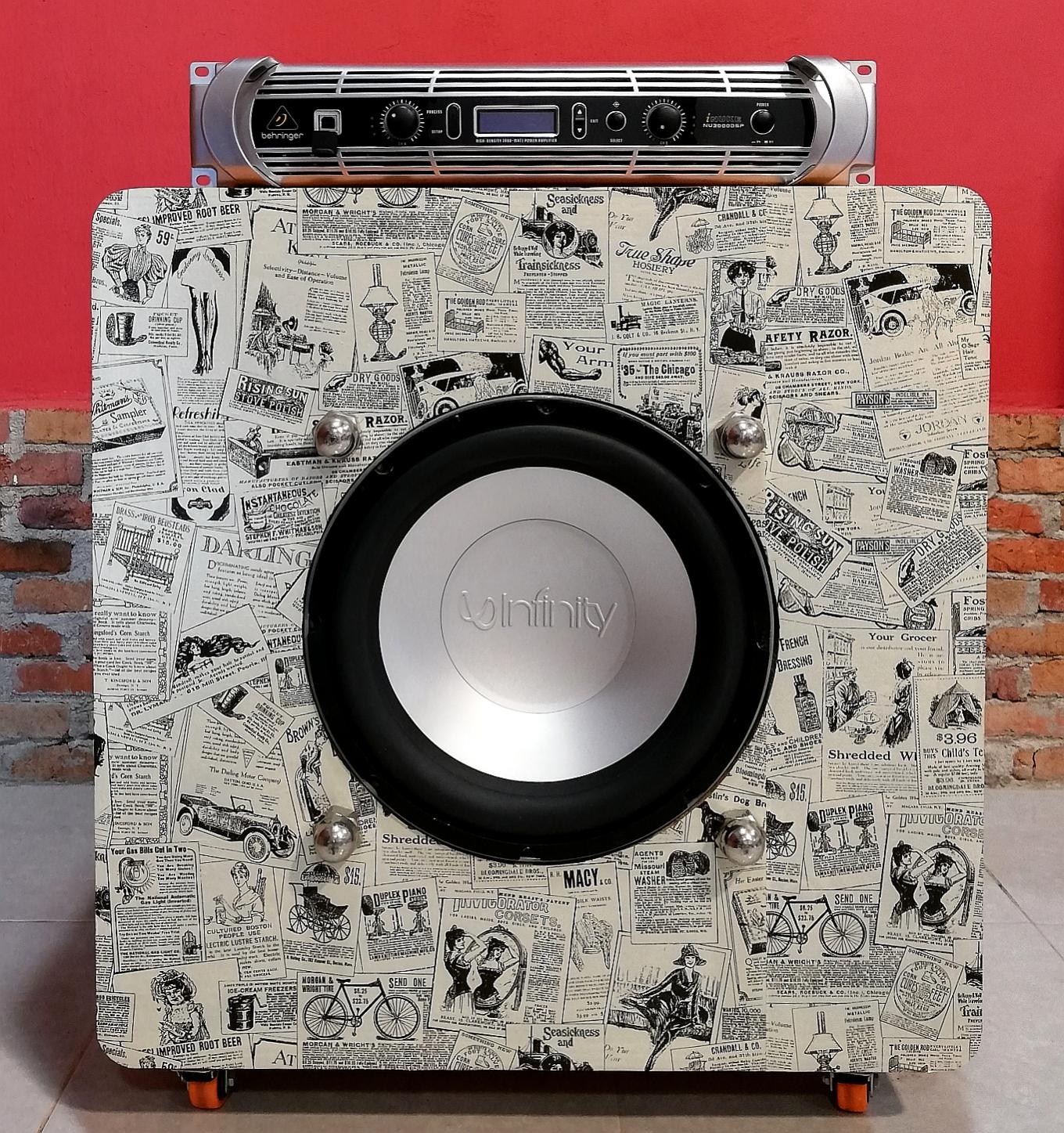

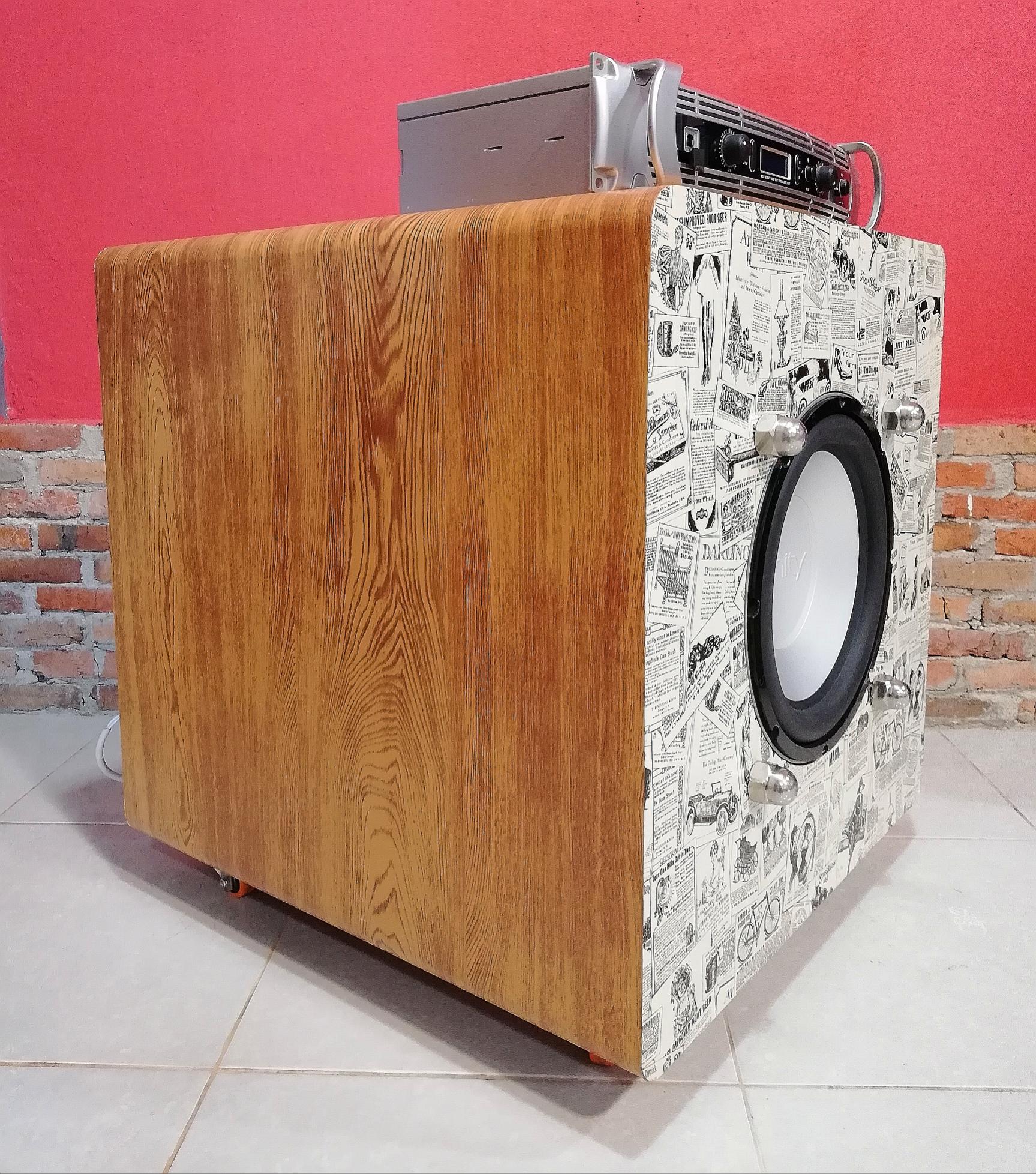

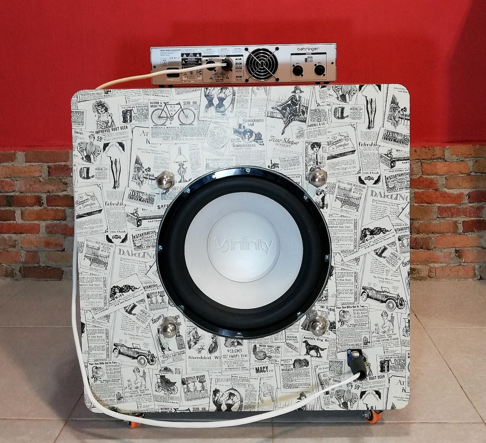

completed this build and sounds good, powered by behringer nu3000dsp and drivers connected in paralel. i haven't tested to max volume yet because it started to rattle my kitchen hod badly
now i have to prepare to build 2nd subwoofer to utilize 2nd channel on behringer
