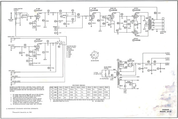

A very good design for a 6BM8 PP is the Calrad AP-15. 1 12AX7, 2 6BM8 per channel( these are mono blocks and there is a Sam's Photo Fact on the AP-15).

Is the 12AX7 there to drive the tone controls, because in a set of monobloc poweramps it is sort of an extraneous stage. Got a schema?

Hope this loads

Thatch_Ear said:
Kind of interesting in that 1/2 of 12AX7 is for phono stage and the other for tone, volume. The amp itself is all 6BM8, notice the feedback circuit.
If you didn't need the tone you could use the 2nd 1/2 of the AX7 as the 2nd stage of a passive RIAA. For a power amp you could just start at the 1st part of the 6BM8.
Any chance of mailing me a larger readable gif of that circuit?
dave

Thatch_Ear said:
And I will send you the whole photofact. They are nice little amps, and sell for low prices, but have only recieved 2 out of 5 worth paying for.(Ebay)
