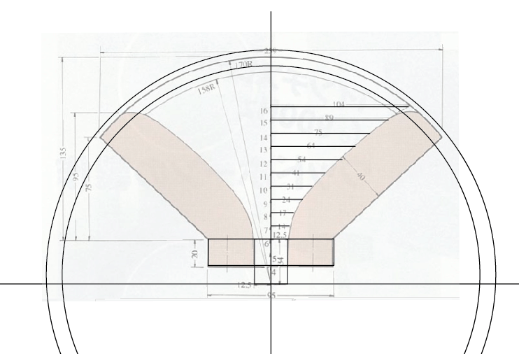

Hi All. I just bought a wood lathe and want to build a pair of 1Khz Yuichi horns. On the blue print there is a center line that is ticed off at some increment but I can't figure out what the increment means.
See the pic below. The increment starts at 4 and ends at 16. I've been reading blue prints for years and have never seen where a segment is not marked for length.

All units of measure are in mm unless otherwise noted.....the only otherwise note is the thickness of the side blocks in cm (4cm) or 40mm.
The radius origin point is not really on the paper as it's a vanishing point and is located 34mm down from the STA mark 6 at the throat entrance.
Each STA mark is 10mm.
If you measure from the throat entrance starting at the 6 mark (zero) the 16 mark is 34mm+100mm=134mm.
This type of drawing is very common in ship building and is done in the "lofting" fashion in order to depict compound curves.
It's sometimes better to only show a half section with these though rather than the full section as shown....a matter of preference as they are mirror.

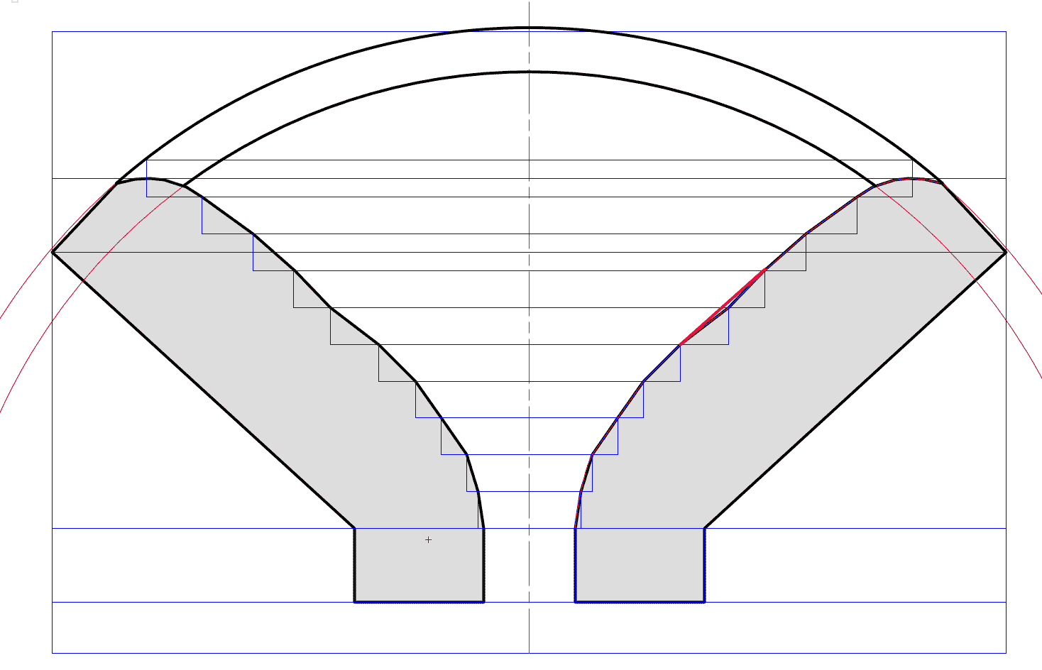

So in the one view at STA 16 the "loft" (or curvature) is 104mm from the center line and in the other direction the loft (curve) is 35. You need point points to get the compound curve correct. You need to use a "french" or "lead" curve to layout the actual curve between points they are not straight lines as someone depicted in the staircase step drawing.

I've built tractrix horns with the lathe. It actually work very well and out of one disc I get 4 horn halves which is enough to build two horns.

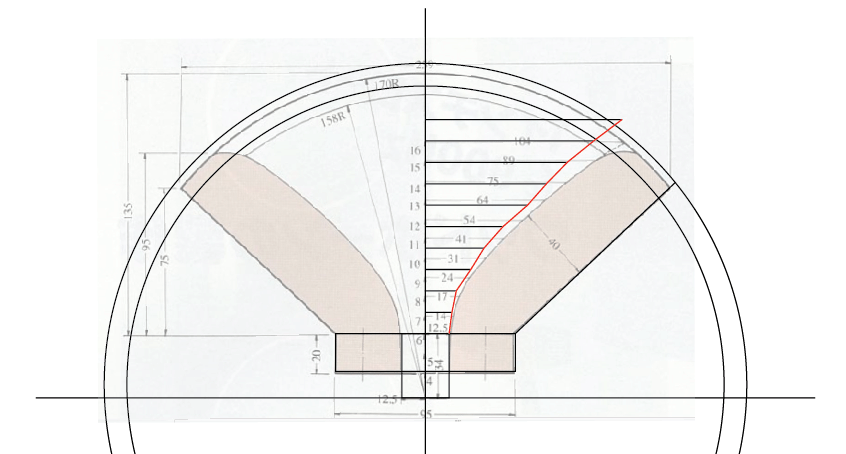

I think that little red dip in your drawing shows the picture might not be accurate, but I'm not sure there should be a dip there either.
OK...I think I see your use of the lathe
So what your planning would be a solid block of wood roughly 260mm in diameter and 150mm deep and then turn that on a lathe similar to gouging a bowl but working from the center base outward to the flare creating the horn shape?....correct?
Then you would cut that into quarters and then fabricate the end plates and throat adapters...2 horns!
That would be interesting and a cool way of doing it!
Would you need to bore a hole into the center of the block first?
That would be a fun video to watch!
