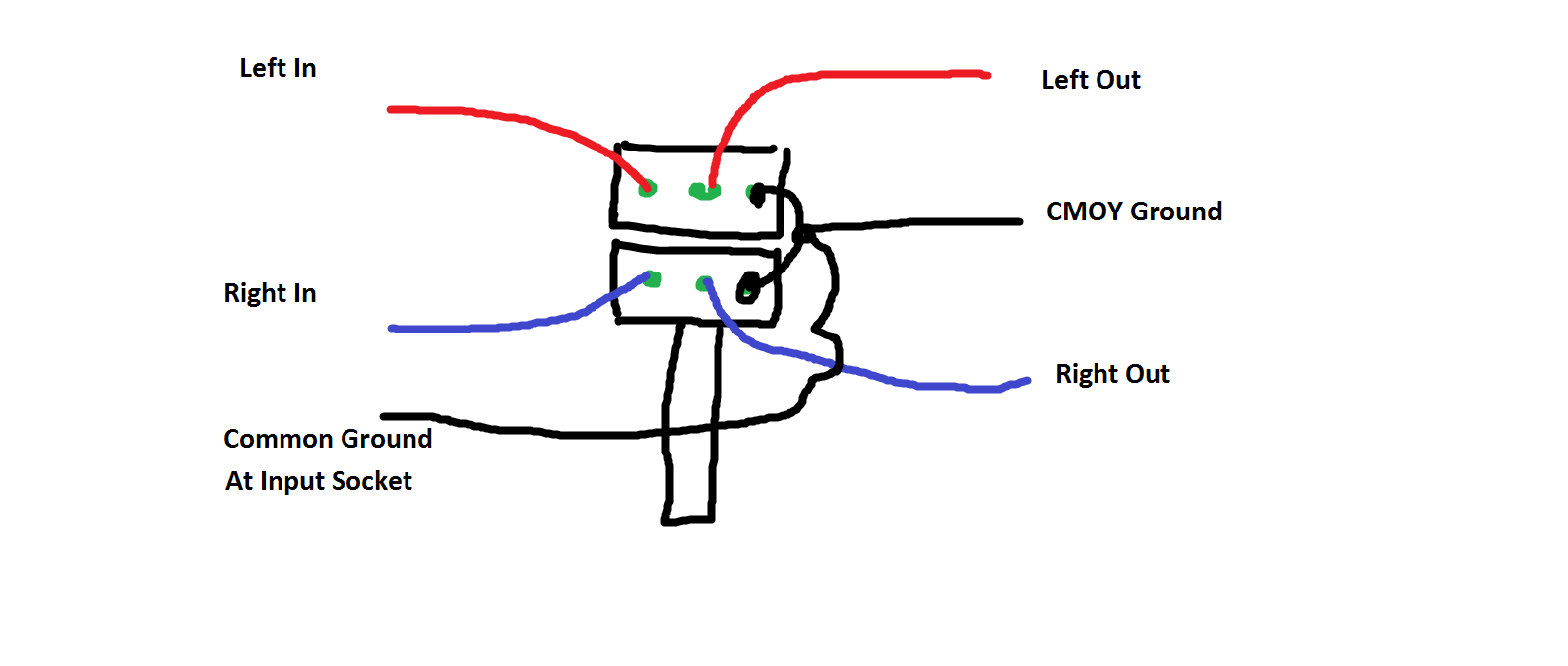

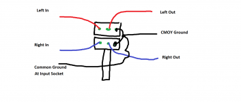

Back again with more questions! I'm just now getting time to mount the off board components, like audio in and audio out etc. Well, i'm not really sure where how to wire left/right channels to the pot then to the out, and same with the audio in, How do i know what is left and what is right channel? There was no info in the product page i got as pdf :V

The pot is easy. Place it in front of you and with the pins facing upward. Attach the wires as shown. There is no 'left' and 'right' as such. Its up to you to decide which is which when you connect it all. If you found the channel reversed when listening then all you do is swap either the input or the output wires over.
The output socket also has a common ground that goes back to the CMOY ground.

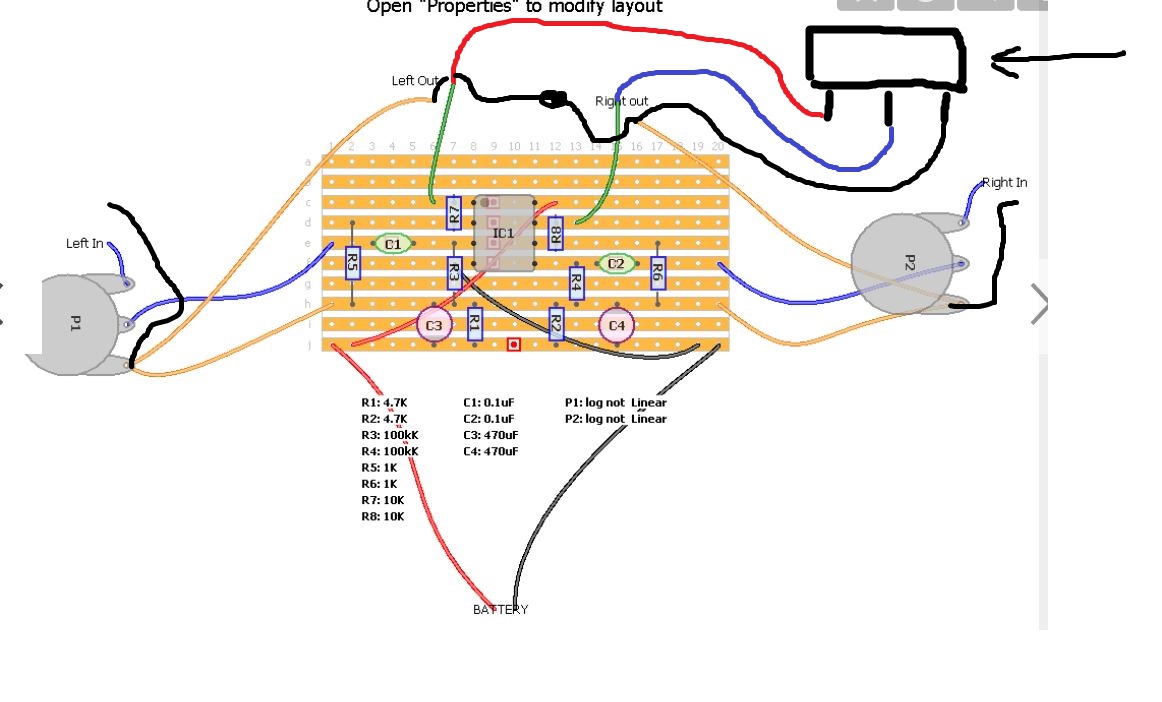

Well, I got all the cables on the pot and in/out. But I'm a little bit lost where I connect all the ground wires. Also I did not understand what you were saying about the output ground ☺️
Either I'm blind or he didn't show on this render where I put the ground wires
Those orange coloured wires are the grounds.
Its much much harder to describe than to just do it. The rectangle at the right is the headphone socket with the plug coming in at the right. All you really need is a single wire for the ground returning the headphone socket ground to the virtual ground on the board which is the junction of C3 and C4.
The input ground is wired the same way to whatever sockets you have chosen.

Well, i connected this wire to my stack of pot ground wires, so it would be easier to cable manage it later. but it is connected to the virtual ground. Same with the input. If you check the second picture the red wires conected to the "ground pins" are input and output wires, and the 2 blue wires are the ones that are connected to the virtual ground.

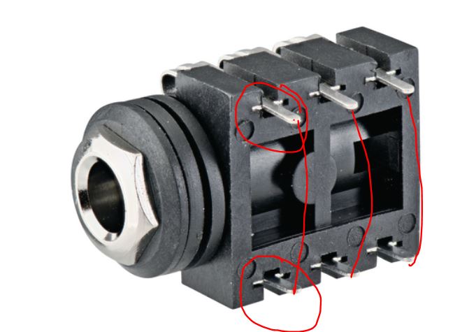

Done it. and everything looked good, 8 and 4 is shoring 9v and the rest is at 0.02ish. But there is 1 thing im not sure about. My 6.3mm output, if i use my dmm and try to measure between the points marked(https://gyazo.com/4a1cdac7c91e423cd065b3b7bf42f0e6). i get no reading at all, which means that i don't have a connection right? Can this be the problem?
In the 5th photo down at the bottom left of the board, there looks to be an unsoldered wire. Also between tracks 5 and 6 from the top, to the right of the chip, there may be a whisker of solder.
Give the board a good clean with a tooth brush and isopropyl alcohol (or vodka) to get rid of the soldering residue and drag a blade between the tracks to make sure there are no whiskers.

On the socket I can't say for sure which of the row of pins is the correct row to use but if you link them across then it removes any doubt. The ones circled would be the ground and so these go to the virtual ground point.
