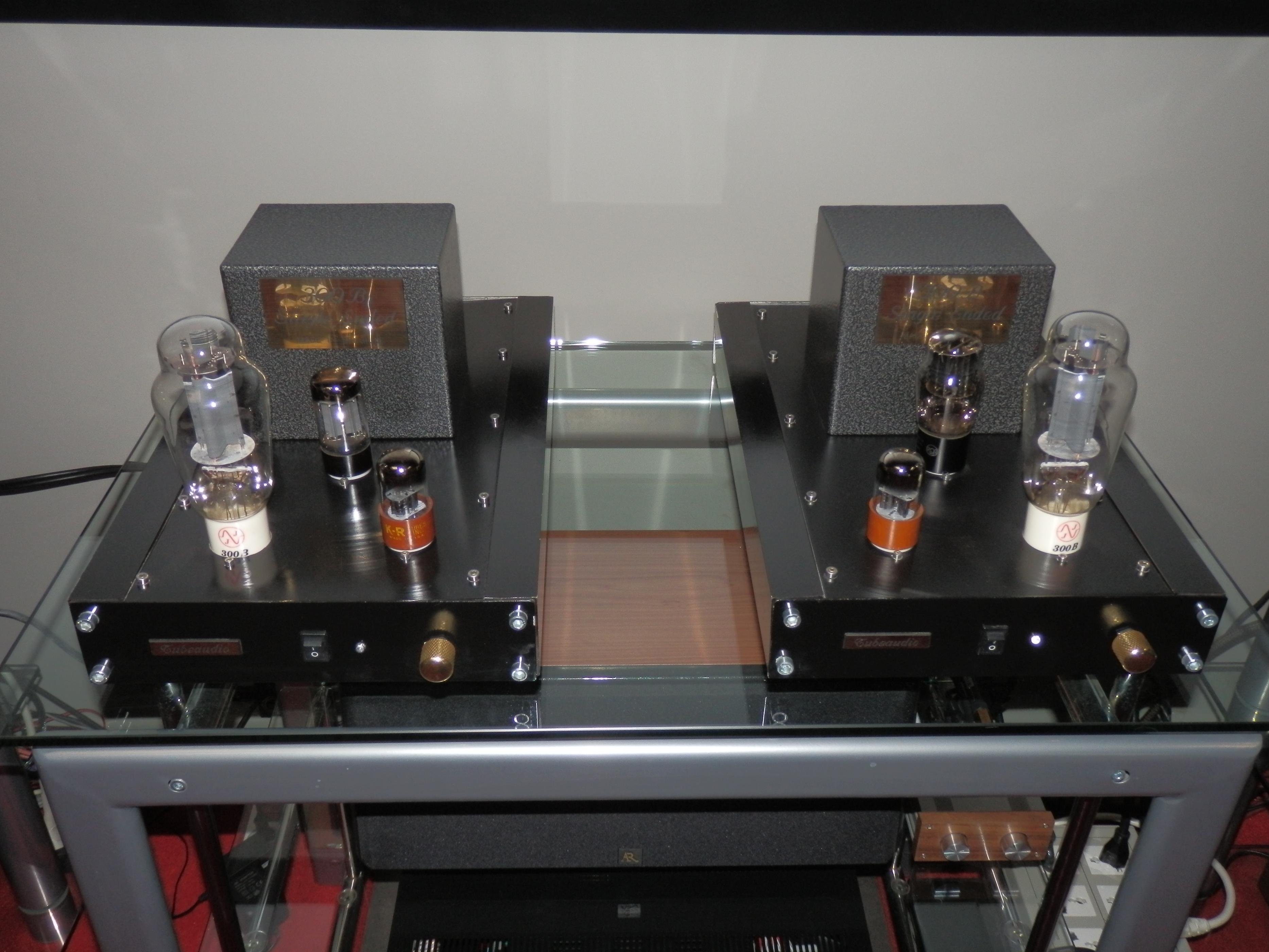

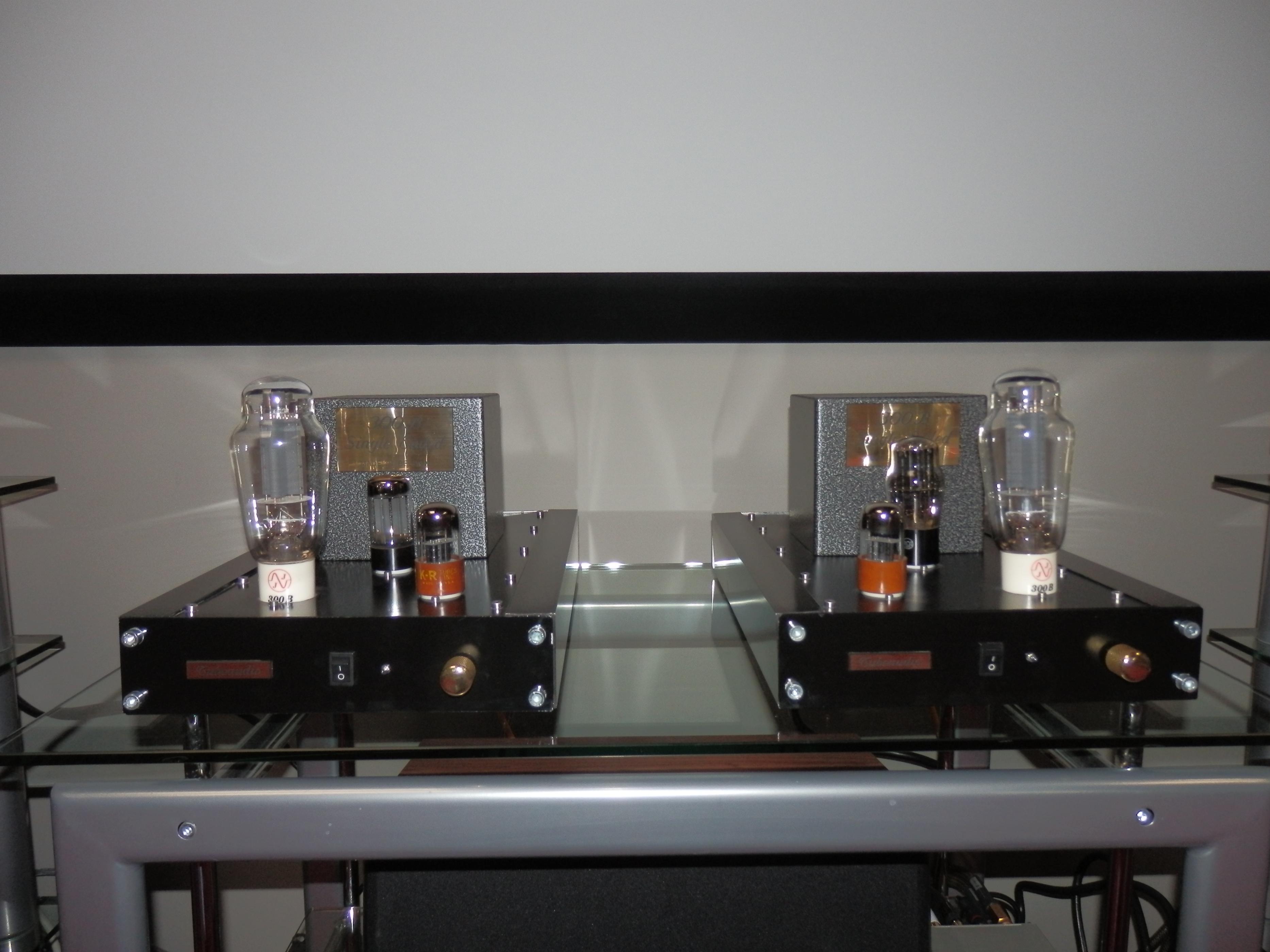

Well, the amps finally arrived. I took some pictures (see attachments). In the end I decided not to try them with the Martin Logans and neither with the Acoustic Research speakers.
I found a pair of used Klipsch speakers RF-52 for 200,- euros, which have a sensitivity of 96 dB. And man these 4W tube amps just make them sing. Perfect soundstage and crisp highs. The amps don't even need the full signal fed into them, it would just become to loud.
So, yeah I'm happy with them!
You'll notice in the picture that the tube in the back is different in both amps. It's the rectifier tube (5U4). The one in the right amp should be the same as the one in the left amp, but the seller used it for a repair job so he lent me an RCA black plate, while he's searching for the right replacement.
Anyhow, thanks for all the comments!
Alvin
