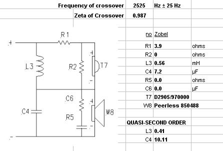

Hi Jennice
See the drawing below for some good starting values for the series xo.
Download Andy Graddon's great series xo spreadsheet.
http://users.tpg.com.au/users/gradds/SeriesXO/series_cross-overs3.htm
With your 2 bass woofers you have to make sure that the SPL is not greater than the tweeter mid combo, so I'd suggest that the you need to bi-amp with level controls.... 1 for the tweeter/mid and 1 for the woofers. You might have to crossover to these a bit lower depending on the 850488 F3.
For first order just use L=R/6.28f..... use the actual impedance for R (for 2 drivers in parallel will be halved) at the xo frequency, f.

Hi Rabbitz,
Thanks a lot for your help 🙂
There must be an error with the sheet, though (or your manual calculations). Surely R2 shouldn't be a short circuit !?
Also, R5 - C6: am I supposed to forget about R5, or what is the idea of this part (looks like impedance correction)?
EDIT: I got the sheet. Interesting tool, but what's the "Your aimed X-O zeta" all about?

Rabbitz, regarding your attached screenshot

Greets!
Zeta 1.0, etc., just defines the alignment. Anyway, here's the formulas, an elaborate designer w/tutorial, and a fairly in-depth article on the subject with measured comparisons:

Suppose I better jump in, if no-one minds. 🙂
I suspect that Rabbitz has picked up the data from a data file, the zeros really should read, "n/a" or not applicable.
The use of zobel type impedance compensation, while in theory seems to be a 'must', can often be ignored. Depends on the woofer. It can be used to tame an overly aggressive upper mid response. You just have to remember that it does put a tad extra strain on the tweeter.
So if your woofer has a broard rise in the top of its response range, you may need one. If its reponse drops slightly through its upper range of use, you may not need one.
And of course , if you woofer has mountains etc.. you shouldn't be using a simple series !!
Think of a series x-o as a combining network rather than a controlling network (ie parallel) and you will understand their attraction, because that is what they sound like.

Sorry about the confusion Jennice but that little schematic is normally only used in my spreadsheet and I know that 0=not used.... I'll change it to a text note so if I do post one in the future it will be easier.
I don't use the R2 has that forms the part of a normal L-Pad and I only use the single resistor. Andy's spreadsheet show both options and I prefer the single resistor.
R5 and R6 are the Zobel values.
As far as Zeta goes just think of Z<1 (peak on the crossover area)is lively and forward and Z>1 (dip in the crossover area) is laid back. It's all to do with the overlap of the tweeter and woofer. Z=1 is basically your standard butterworth 1st order values.
Series are really nice.... just something about how they present music and so simple in construction (3 components in it's simplest variety) and Andy's spreadsheet is a blessing and a great starting point.
Then you listen and test and alter values. I have a test rig outside the speaker and I normally get the resistor value sorted out first so the top end is right, then play around with the cap value... as you increase the cap value the tweeter crosses over lower and vica versa. I don't tend to play around with inductor values too much as I've been through that learning process so have a good idea where I'm heading. My first series had about 20 variations to get the one I wanted and that changed again after living with them for a while. Now I normally jag it in about 2 variations. Each builder does it differently but that's how I approach it. The main thing is to use the impedance value at the crossover point for each driver.
The only thing is that series doesn't give you is tweeter protection of a cap, but I've never damaged one yet even with some stupid levels and a mistake once of crossing over at just above the tweeter's Fs.

Rabbitz,
Thanks for the exlanations. 🙂
I thought that the L-pad used tweo components for adjusting sensitivity AND linearizing the "apparent" impedance (the driver impedance seen by the XO-components. Doesn't the use of only the series resistor leave the impedance curve of the driver as non-linear as it originally is?
What's your experiences? Are 5W resistors OK for L-pads, or should I go higher, especially considering the resistor in parallel with the tweeter?

Most of the info that I have found on series state that they are better with the single series resistor and not an L-Pad and that's what I have found. Even in the parallel world, a lot use the single resistor including Vance Dickason. Yes L-pads do provide a constant load with leaving the tweeter impedance constant no matter what the attenuation is on a parellel network but I'm not sure if that is the case on series network.
The spreadsheet takes the resistor into consideration during the calculation and with your drivers with the series resistor (R1) only gives almost equal impedance on the tweeter leg and woofer leg of the network which is a good thing.
5W resistors are fine and most of mine are non inductive wirewound. Use R1 only (the one in series) as it will sound better but try the L-Pad with R1 and R2 if you like, but that will alter the cap value. As you reduce R1, C4 becomes larger and visa versa.... it's all linked together.
