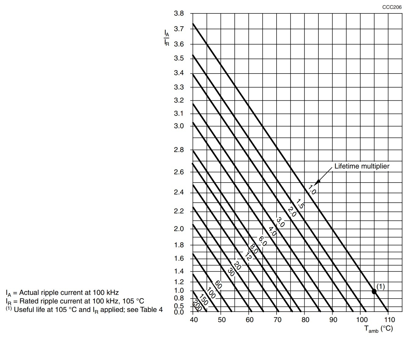

the nichicon ukz look good but there only 1000h at 85c
where Panasonic are about 3000h at 105c
I would not care too much with that diffference. Those data are valid with maximum ripple current and max temperature. If you can keep your caps at 40C, they will last even 100times longer.
Reactions: JMFahey
ya that's why I'm going to grab a few as you still get the remaining stock on digikey

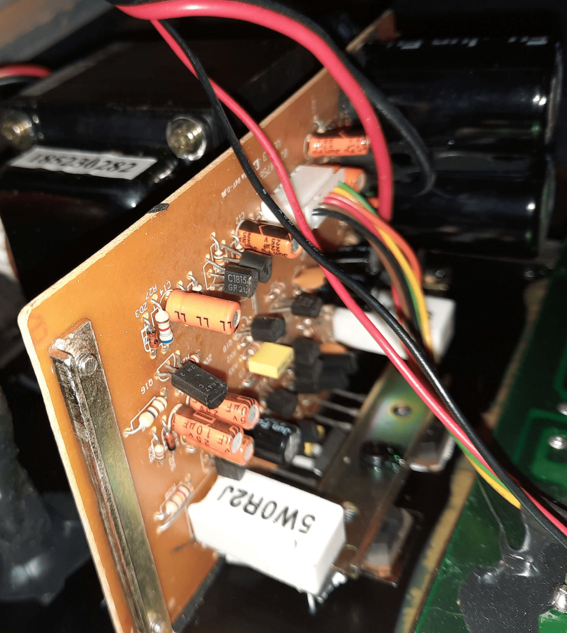

well I'm going to order the caps for the amp but i thought ill look in my sub as it hums and it bugs me in the quite parts of music. the caps were jun fu branded and glued in (why glue). as this is like more then 15 years old (mission ms8)
I though i might as well replace it, it needs 4700uf 63v main caps so i picked the Nichicon LLS as they have the size i need.
there are other caps on the PCB branded jun fu but I'm stuck what to pick for them as Nichicon UFG is cheaper or should go long life Nichicon UPX
i have no idea what is signal path or power there's no service manual for it
but there are black caps and orange caps.
so if i replace the black caps with UPX and orange ones with UFG? how does that sound?
