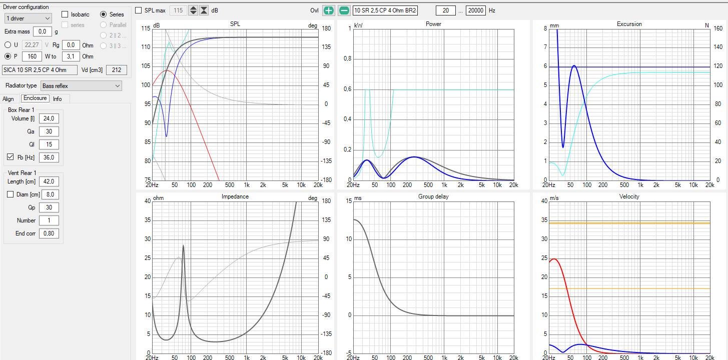

I hope I am posting in the right category. So I've been trying to design an enclosure in VituixCAD and WinISD. I've got some difficulties making it meet my desired specs. The cab + subwoofer are designed to be in a car trunk.
From what I understand it would be best fit into a rather small enclosure (max 40l), I've tried many things and past 45l f-3 keeps getting higher.
I just achieved something pretty good. My biggest problem is the cone excursion though.
The speaker I have is this one :
Sica 10 SR 2,5 CP 4Ω. Specs are attached.
I would like to get a solid 40Hz @ f-3. Here are the specs of my actual simulated enclosure :
Actually pretty good IMO. But then, as you can see, here is the problem : the cone excursion.
This @200W (which is the maximum power I can get from my amplifier)
i get roughly the same result in WinISD.
Is that a problem ? Is there another problem I don"t see ? Do you see a better alternative ? I'm a total beginner so I would be happy to get as much info as I can.

This driver gives a clean 40Hz at 111dB before running out of xmax at about 100w. You will never go that loud in a hifi setting except when you want to be deaf. And you don't want to push the amp to maximum neighter as it start to distort (even if the driver can handle it).
And even if your amp would be more powerfull, the driver will not break, the bass will only be more distorted as xmax is the limit of linear excursion, mostly the driver can handle way more before hitting xmech and go in physical overexcursion.
So i would not worry.
Btw, i come to a 50L ported cabinet with 2 10cm diameter ports of 51.4cm long for your tuning.

As already noted, normally will just distort more till eventually the VC will hit the back plate if no high pass filter is used to protect it, which may/may not damage it enough to need re-coning, but if you look at the 54 m/s vent velocity that ideally should be at < 17 m/s, the vent will be 'choking'/'chuffing' so bad it will be limiting its excursion, which in turn is making it heat up [thermal power distortion] to the point where the amp will be overload clipping, so if this distortion 'sounds' good to you [and IME way too many 'boomers' do], eventually the amp's protection ckt. will shut it down, assuming it has one.
In short, just protect it down low and use the largest/longest vent you can tolerate and 'it is what it is'.

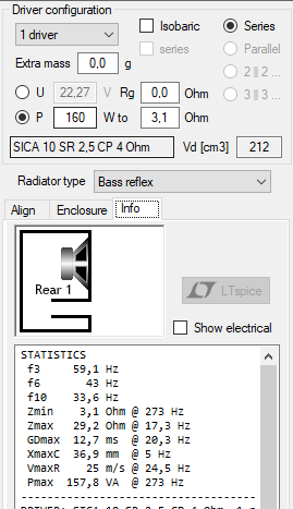

So I've come to this now, @160W which would be the max power I'll give from the amp to the driver, to prevent clipping of the amp:
See attch1
As you can see, no more cone over excursion, velocity is better, but, f3 is sooo damn high... (attch 2).
If I make vb bigger, I then again go to over excursion and all that stuff.
It is a 10" speaker, that can take 300Wrms, is there nothing better I can do with it ??? I believe I am making a big mistake in my simulation, because I can't believe I can only have that kind of result from the specs that speaker has. Or it is not made to be a subwoofer at all.
Please, please someone help me understand this !!! Thanksss

1: putting a speaker in a car gives you a degree of free bass boost known as "cabin gain", which means you probably can live with a response that's not flat in the model because if should reach a bit deeper in the car. Exactly how much gain you get is variable though, you may want to do some research on it before committing to a particular design.
2: The difference between 160W and 300W is less than 3dB, which in the grand scheme of things isn't an awful lot - I wouldn't worry about that. Like waxx said in the very 1st reply, 111dB @ 40Hz (before accounting for cabin gain) should be more than enough for normal enjoyment IMO.
3: It's quite normal for drivers to only be able to handle full power under certain conditions in real life - the power rating is only what it can take before damage, not what it can take while still sounding good - that's where the modelling comes in to assess excursion, vent airspeed etc.

Yes, you can still get a lower f3 than at present, but the trade-off is that you will have a lower maximum volume before running out of excursion, and probably a box that uses up slightly more of the space inside your car.
(In loudspeaker design, just about everything is some kind of trade-off, FWIW.)
Cabin gain may well mean that you can still get loud enough however, so I'd start by looking into that if I were you.
