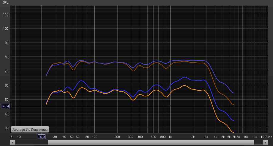

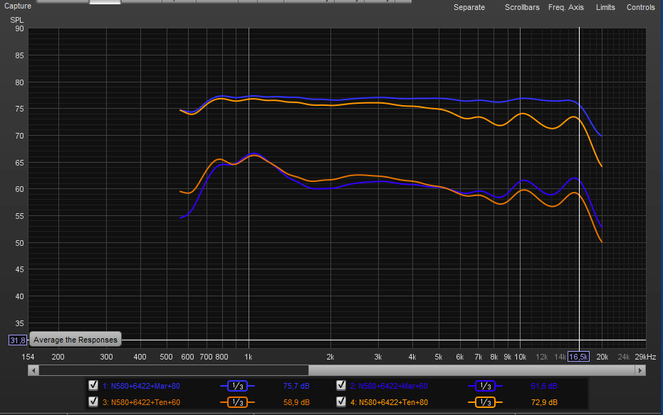

I am finally posting some measures. The measures were taken with two different amps just because I wanted to check the different frequency response of the Marshall 9200 compared to a solid state hifi amp.
Measures at 1m, on the speaker axis, into the listening room, at two different spl level, Behringer 8000 Mic + Behringer UM2 interface.
The SPL db absolute values are not accurate as the SPL calibration was made with an spl meter for the Smartphone.
Smoothing 1:3
Woofer RCF L18/551 , in 250 liters box, bass reflex @ 40Hz, according to original RCF project
Blu Marshall 9200 tube amp, orange SS amp.
Compression driver RCF N580+Horn RCF 6422
Blu Marshall 9200, orange SS Amp.
As I said earlier in this thread, according to RCF original project these two units should be crossed at 800hz, crossover design & specs on page 1 of this thread.
Currently I am crossing at 900Hz with an hardware active crossover, since the nearest crossover frequencies available are 720 and 900.
Would like to build a passive crossover in order to use the tube amp on the whole range, and wonder wether the original crossover design is indeed accurate or it can be improved.
Of course I can now take more measures if necessary.
