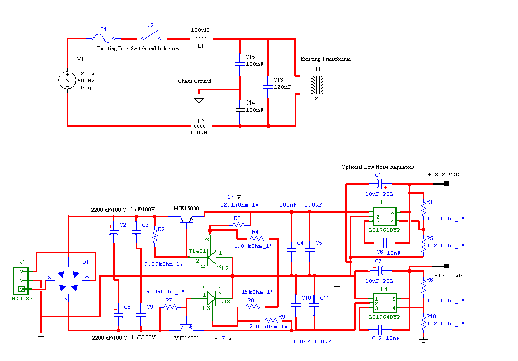

I have come across this schematic for a +/- TL431 with pass transistor implementation.
The positive cycle is easy to understand and calculate, as the calculations is in the various data sheets
However, I have problems in the negative cycle and have mainly 2 questions.
1. Is the output voltage of the TL431 in the negative cycle dependent on the input voltage?
2. What is the calculation for the negative output voltage with the setting resistors R8 and R9?
Thanks for any help 🙂
Have a nice day 🙂

Not a direct answer but...
TL431 is just a shunt regulator. It's being used to supply a fixed voltage to the base of the series-pass transistor.
Use the TI design utility here to make the TL431 work in isolation ie without the pass transistor, then determine the maximum base current the pass transistor can take (bearing in mind the emitter current and hfe) and tweak the calculation accordingly.
There will be a slight difference between the +ve and -ve implementation because of the control current. I notice that these TL's are being run very "cold" which makes the control current more significant than normal. I normally run them near to max ratings where they are quite warm to the touch.

The positive regulator topology is correct, however the negative one is wrong and it isn't easy to fix. I suggest to use a transformer with two independent secondaries and independent rectifiers. This allows to use two positive regulators each floating relative to the other and symmetric output is then obtained by connecting the negative output of one of them with the positive output of the other, effectively stacking them
Unstability problems may arise due to parasitistic capacitance connected to the output of the lower regulator so frequency compensation or filter inductors may be required
The internal voltage reference of the TL431 is connected to the "anode" terminal, so for the negative regulator, the reference is in series with the pass transistor Vbe. This is not so good, hence Eva's suggestion to use two series connected positive regulators.🙂
