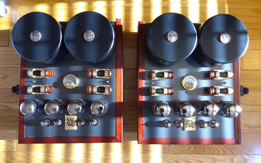

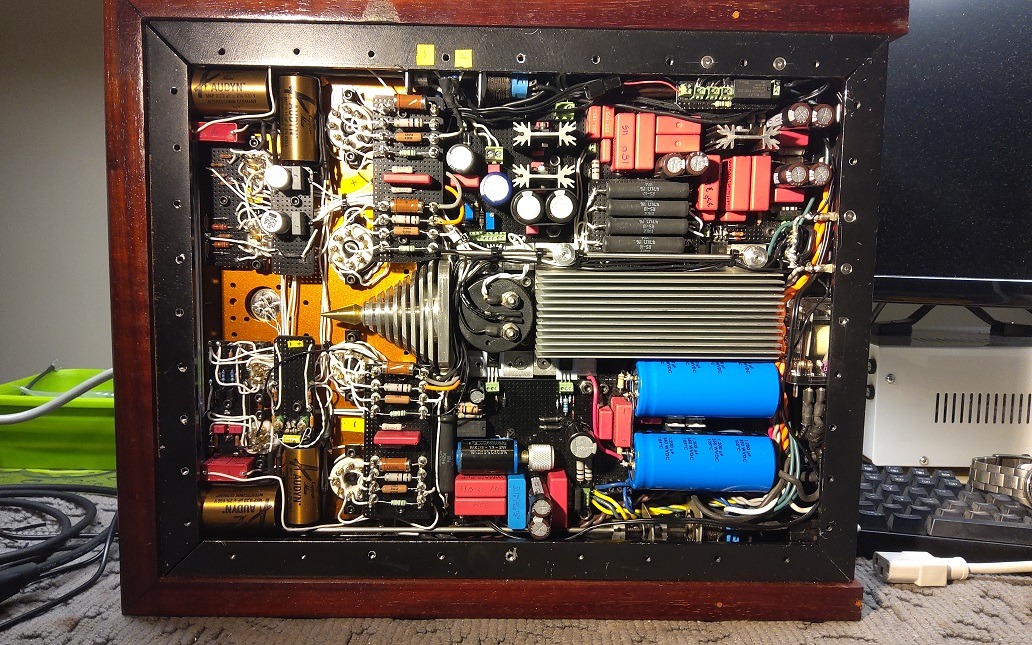

This is a Scratch built Sonic Frontiers Power II from the schematic.
It has a current source for each of the driver valves and the negative bias supply. The driver section has regulated DC heaters.
This is the most complex design I have built to date. Thankfuly there was help and encuragment from the fine folks at the Parts Conexion. The design was originally their project.
