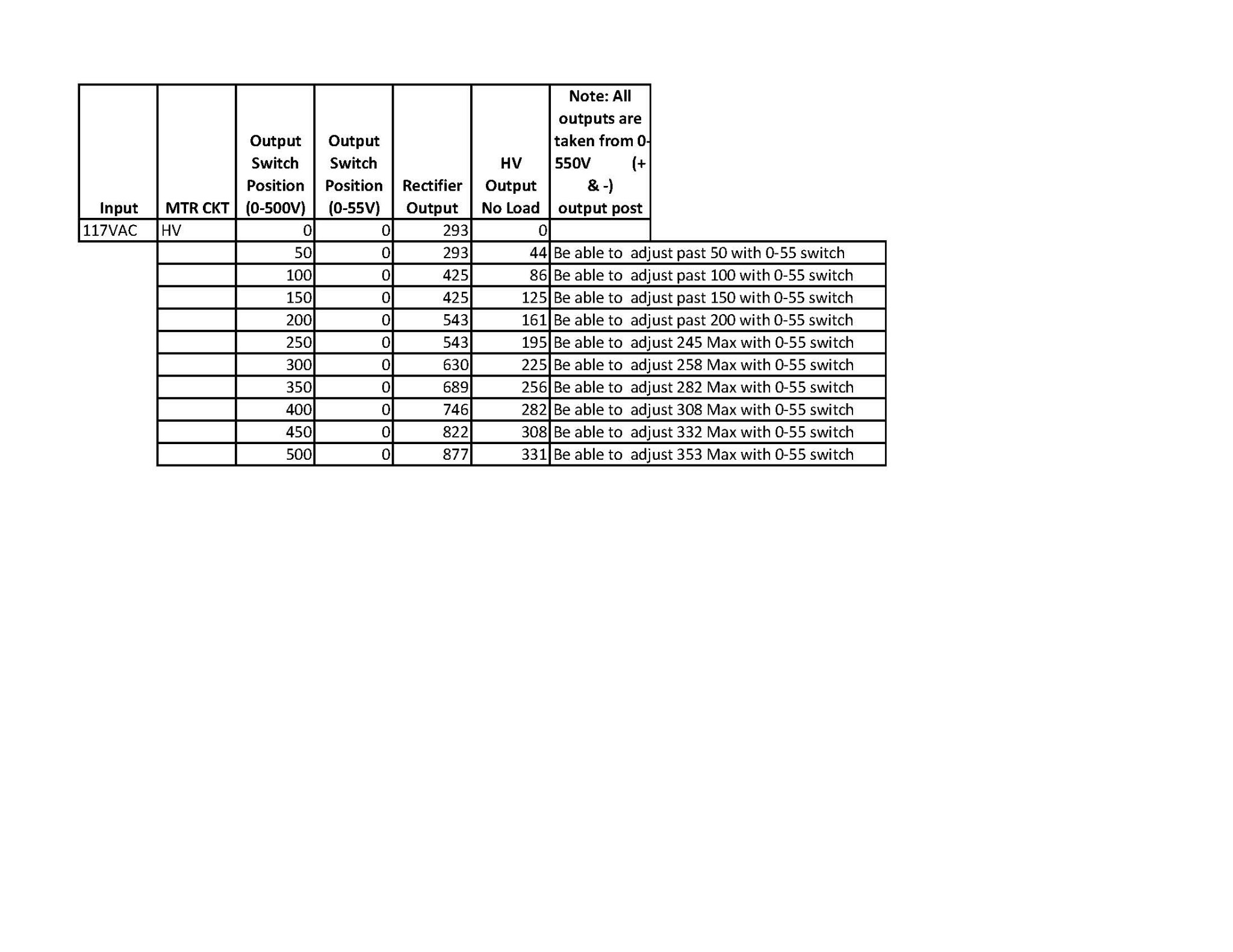

I got this power supply advertised as power up condition only and currently tried to restore it. Replaced some components, weak tubes and checked most of them too. In general most of the components are still within the tolerance. Some exceeded slightly but I don't think it will cause much of the problem and did not replace them. Did not replace any Bumblebee caps since they're still within the tolerance (using LCR meter).

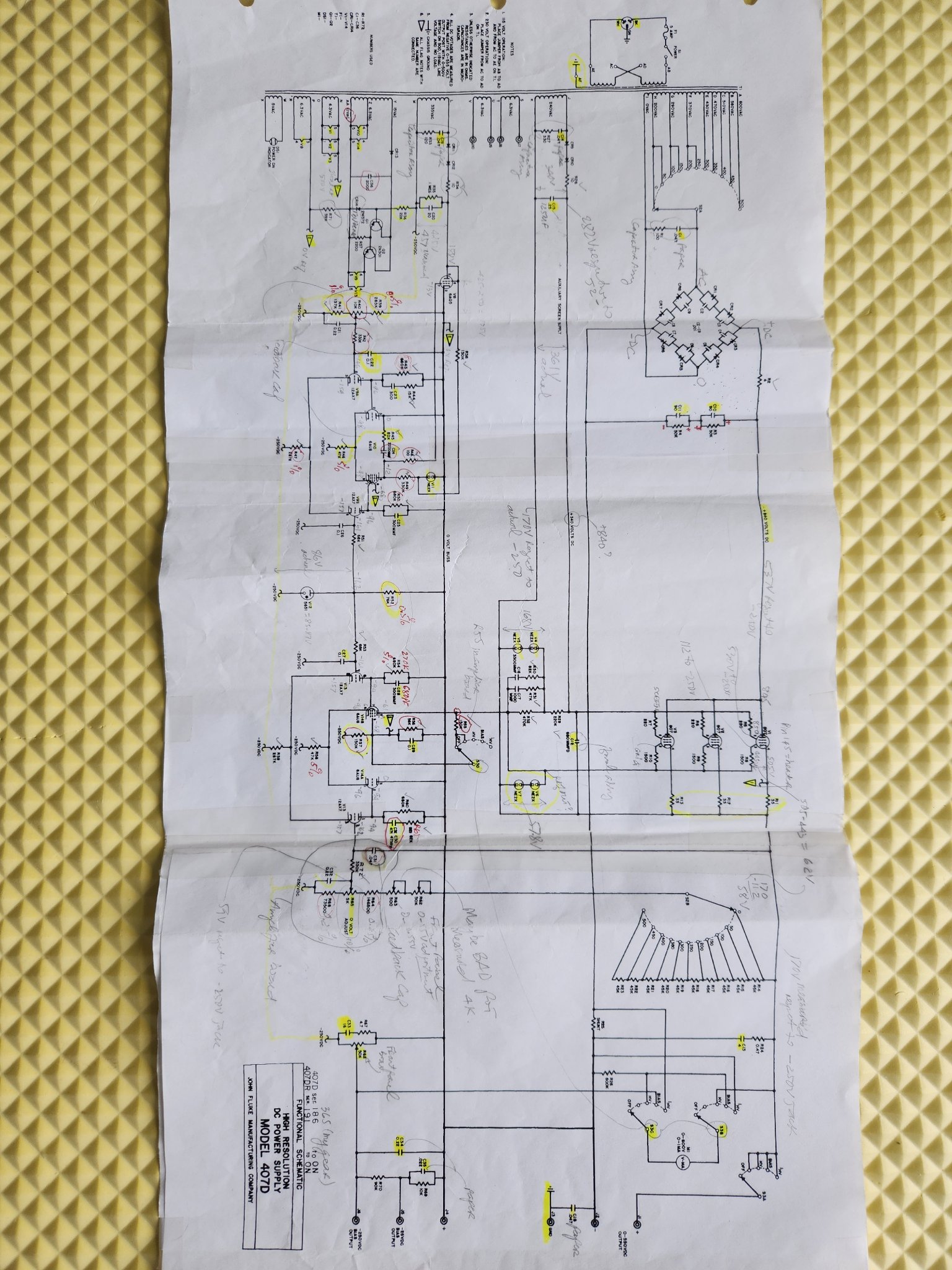

Attached is the output data after power it up. The main issue is it did not reach the max voltage except as noted in my file. Checked all resistors in the sampling network. They are fine. Negative 250V Bias is fine. I also checked out all parameters per Figure 4-2- Tube Voltage Chart on page 4-3 of the Maintenance section. The voltages are not really matched what specified there and don't know and not sure if they are really related to the issue that I have. One thing that's quite different from what specified in the chart is the pin 9 of V14 (6AU8). The chart said -61V on pin 9. It's measured about -61 voltage when Output Switch Position (0-500V) is in the "0" position only and I don't believe it's correct in other positions. My measurement on pin 9 started to turn to positive voltage when Output Switch Position (0-500V) dialed to position 100 to 500. On "500" position it measured about positive 289V. May be it's a typo perhaps.

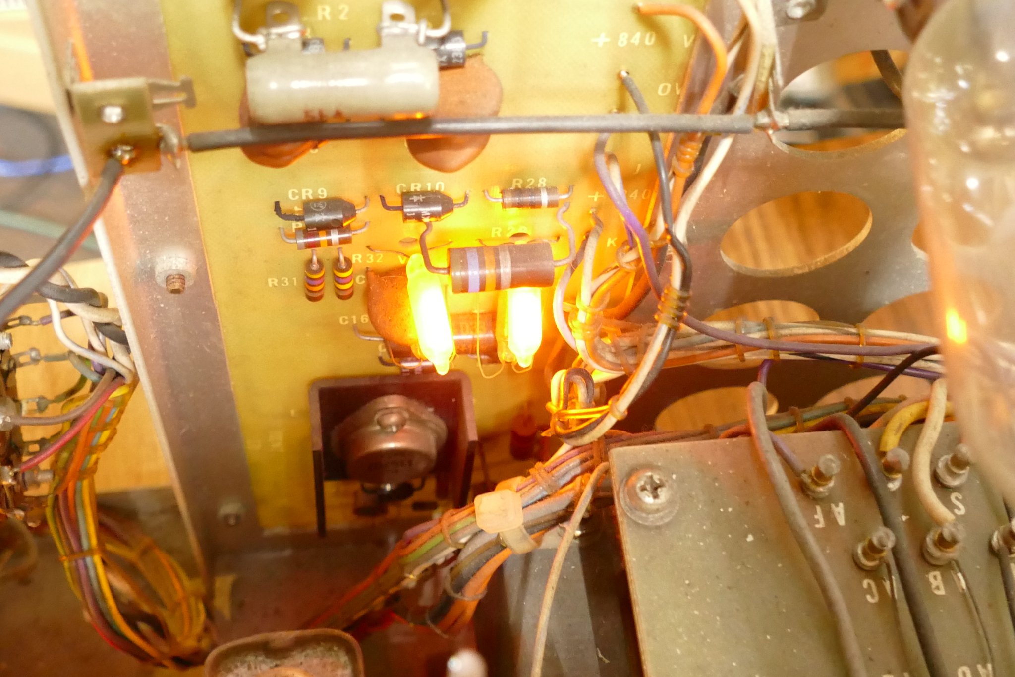

I have a question. Can you verify that the neon lights V4, V5 and V11 are light up during normal operation while V6 and V7 Off? I noted that V6 & V7 are momentary light up when power supply just started to turn on and off during normal operation. I just want to make sure this is how it works. Thanks.

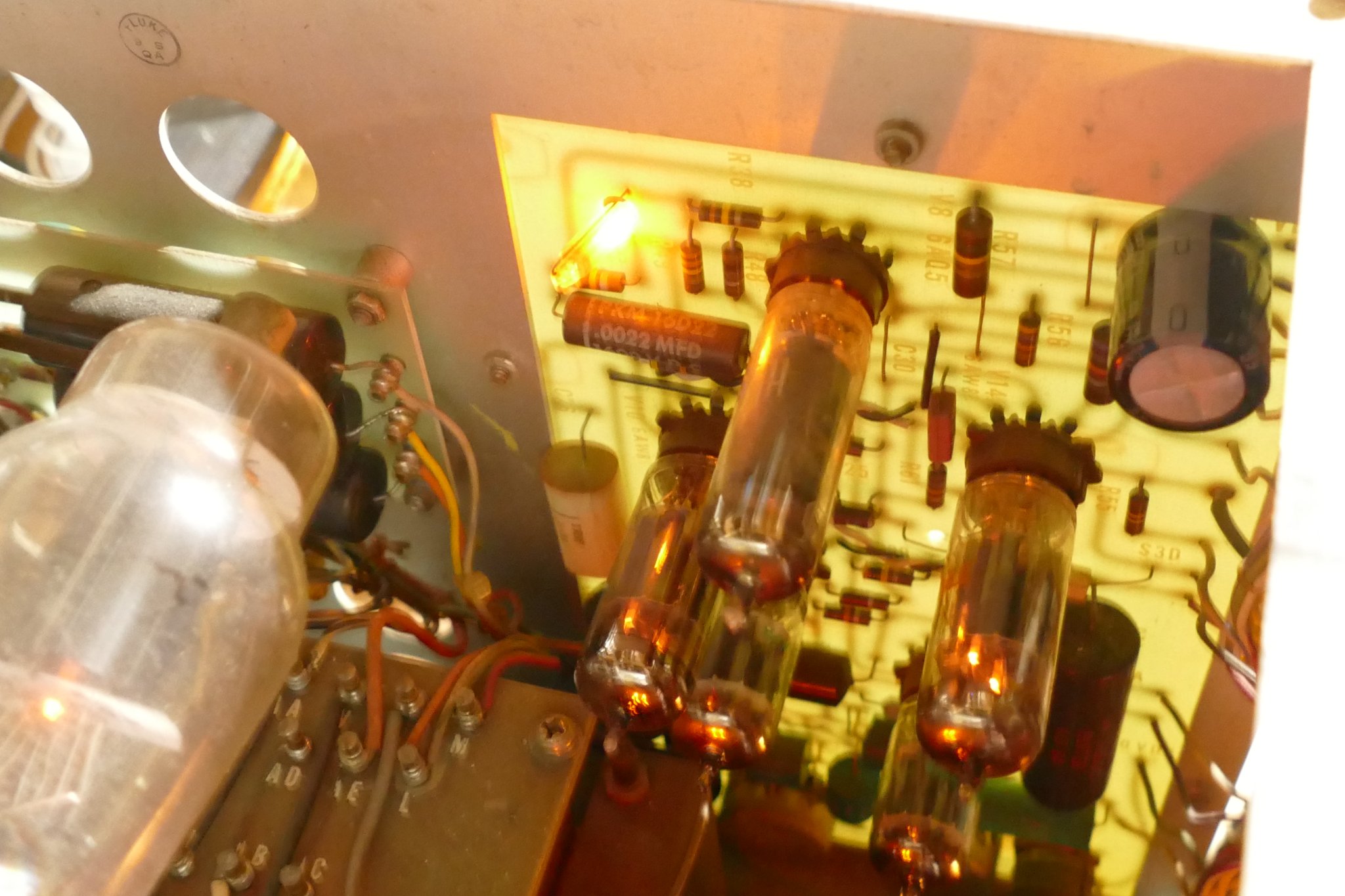

Picture from the top, operational, but unloaded. Board with fat power transistor and no tubes has 4 neon bulbs. Top two are always lit. The bottom two are not lit except for a flash at power up, and flashes when clicking the voltage range switch downward or if the output is shorted. No flash when range switch is clicked upward.
Single bulb near the 6AQ5 tube is always lit.
Want any more pictures while I have it halfway out of its case. This thing was dropped, sat, stepped on, or all three somewhere in its life before I got it. Getting it in and out of the case is not easy.

Do you have one or two modern cheap hand-held battery powered digital meters that you can clip across points in the schematic before powering up, and then much more confidently (and safely) measure important operating levels - compared to probing in a live situation and adding or subtracting individual measurements to derive an important operating level?
For example, knowing that the regulating 807's had balanced cathode currents (ie. voltage across R8, R9, R10) and that screen voltage to cathode was as expected, would be a good start.
All your measured output terminal voltages don't reach their max range specs, that would imply there may be a common output voltage level feedback alignment error, which may mean focussing on the circuitry around the 0V adjust. Can you set the 0V level for all ranges? Did you swap 12AX7 V13 and get the same situation (ie. leakage or balance issues from the 12AX7 triodes)? Did you disconnect or swap C31 (ie. leakage through C31) ? Same with C32. Did you swap V14?

Thanks all for the info and inputs. My power supply was probably older unit since it does not have Silkscreen on a PCB at all compared to other units that I have seen across the web. I finally tear down the amplifier board and replaced all carbon resistors with 1% film resistors (that's what I have in stock) except for some precision resistors there. All bumblebees capacitors are also replaced with film caps even thought most of the resistors and capacitors are still within the tolerance.
Cross my figures and Fired up again. This overhaul finally paid off. Now it works as it should. All ranges are very accurate. Don't really know which components contributed to the problem. May be carbon resistors are drifting due to thermal and capacitors are leaking during operation but not shown up out of circuit measurement.
