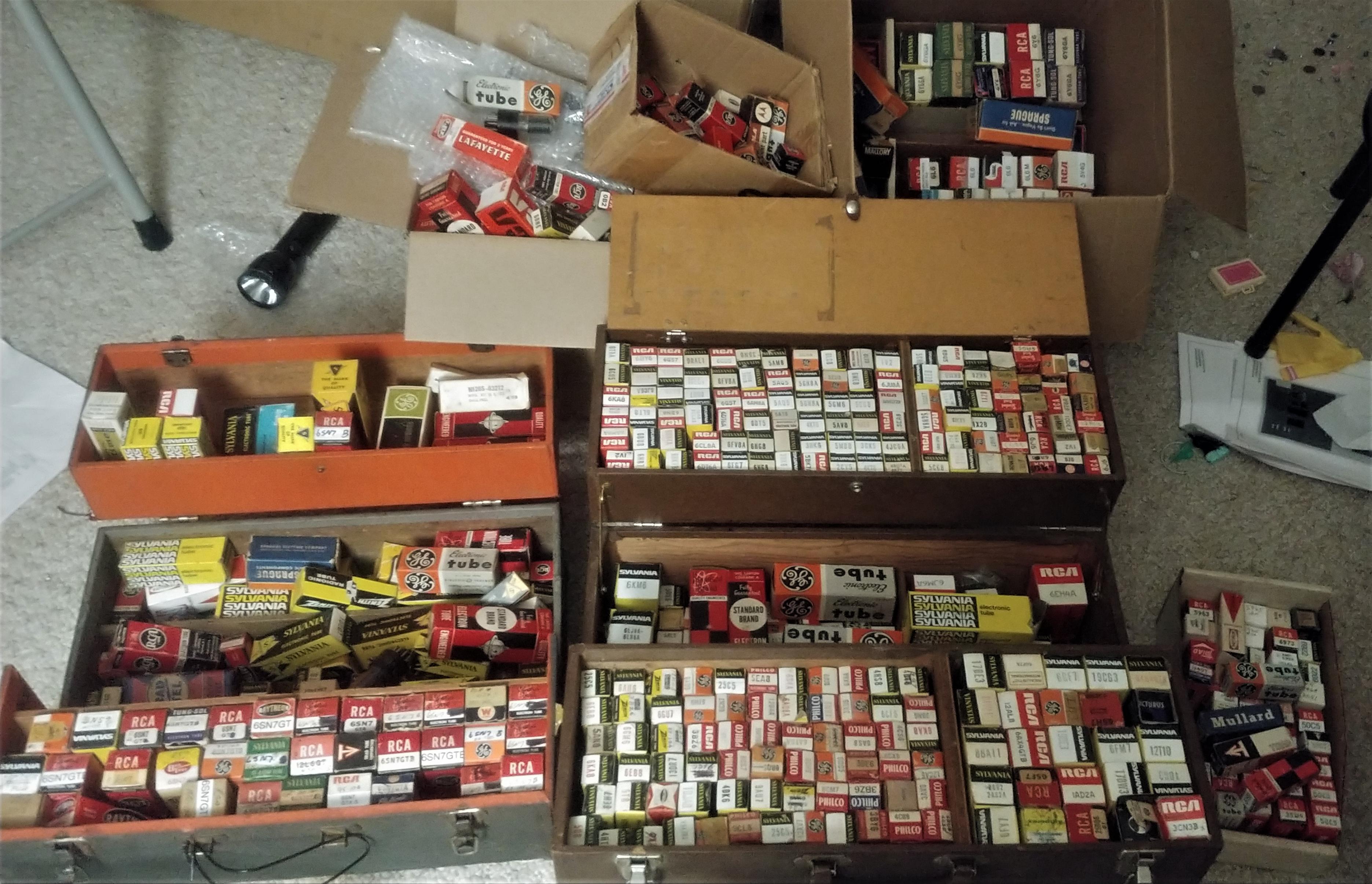

Hi guys. This is my first post but I have enjoyed the exchange of ideas and creativity here for some time. I recently purchased an enormous number of NOS tubes from an estate sale and I need help testing them. I am more than happy to compensate you for your time in cash, tubes or what ever you're comfortable with. I would prefer to do them in batches starting with some valuable ones to recoup my costs from the purchase. If anyone can test volt and trace curve that would be wonderful. There are 100's most in the original boxes and I may have something you're looking for. PM me or respond to the thread and I will get back to you shortly. Thanks in advance.....Kyle

100's literally. Lots of them in the original boxes 6SN7's almost every model variation as well as 6V6's, 6Y6's..more 6's than I can list. Then 12AT's 12AU's....can probably find quite a number of matches. Wondering if it would be worth getting an etracer.
