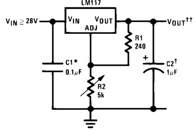

Hi Minion, i suppose that i need 18v 0v transformer
from below attachment, to output 24vdc. how to calculate R1 and R2?
need another RC to reduce hum or something? whats the recommended value for this RC? 100ohm 2200uF?

hi there
actually, whats the different between regulated and unregulated power supply unit?
whats the advantage of regulated? if regulated psu provide better result, why some still use unregulated psu?
for dac application, which one is preferable? thx
An unregulated supply has an output whose voltage will vary with the load that is attached to it. A regulated supply will keep roughly the same output voltage over a wide range of loads.
Whether you need one or not depends on what your DAC requires. Is your current dc adapter regulated or not?
Thanks paul to bring this up.
i manage to build one really simple psu unregulated. btw the DAC can take both regulated and unregulated. so its no issue. will play around with regulated psu later.
some suggest regulated psu tends to be noisier than unregulated one. opinion?
