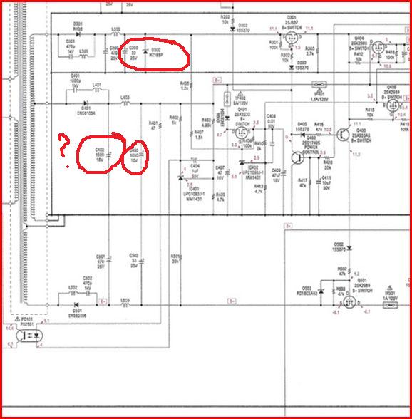

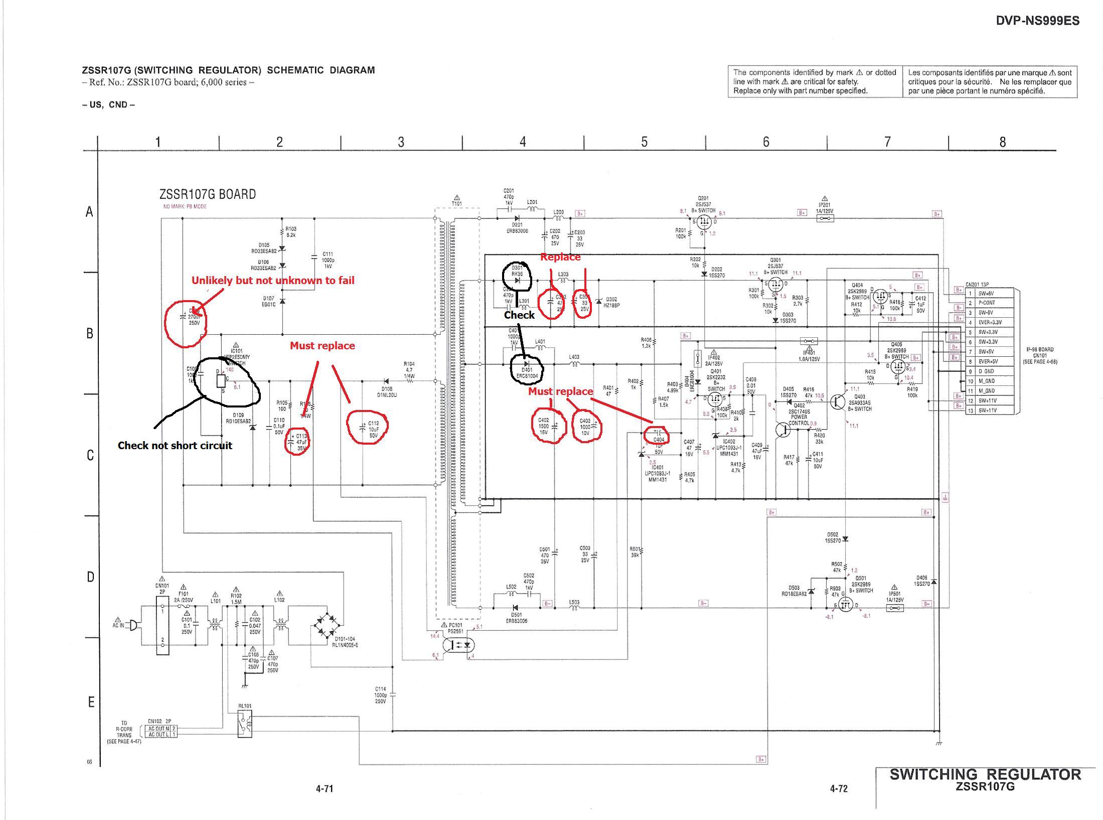

I’m bumping this 10 year old thread because I just bought a Sony DVP-NS999ES from eBay as “not working for parts or repair only.”
It had precisely the same failed parts as noted in this post. The 1500uF capacitor was bulged out at the top and had “vented.” The 18V zener was shorted. After replacing both parts the player is up and running. I’ll check the rest of the electrolytic capacitors and replace all which have high ESR. I have an ESR meter.
My Sony DVP-NS999ES is now operational after recapping its power supply.
