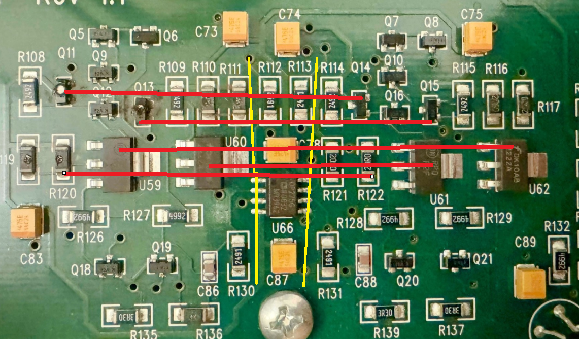

The circuit appears to have horizontal symmetry (merge along the yellow axis). This allows for the identification of certain passive component values, as well as those of the two transistors, etc. I have marked in red the relationships between symmetric parts. Also, replace the OP27. This is probably the headphone amp of the DAC.
This may help, but it may not be sufficient if the root cause cannot be identified.

There are also some other resistors that look fried, but a test with a multimeter would show those up in a second.

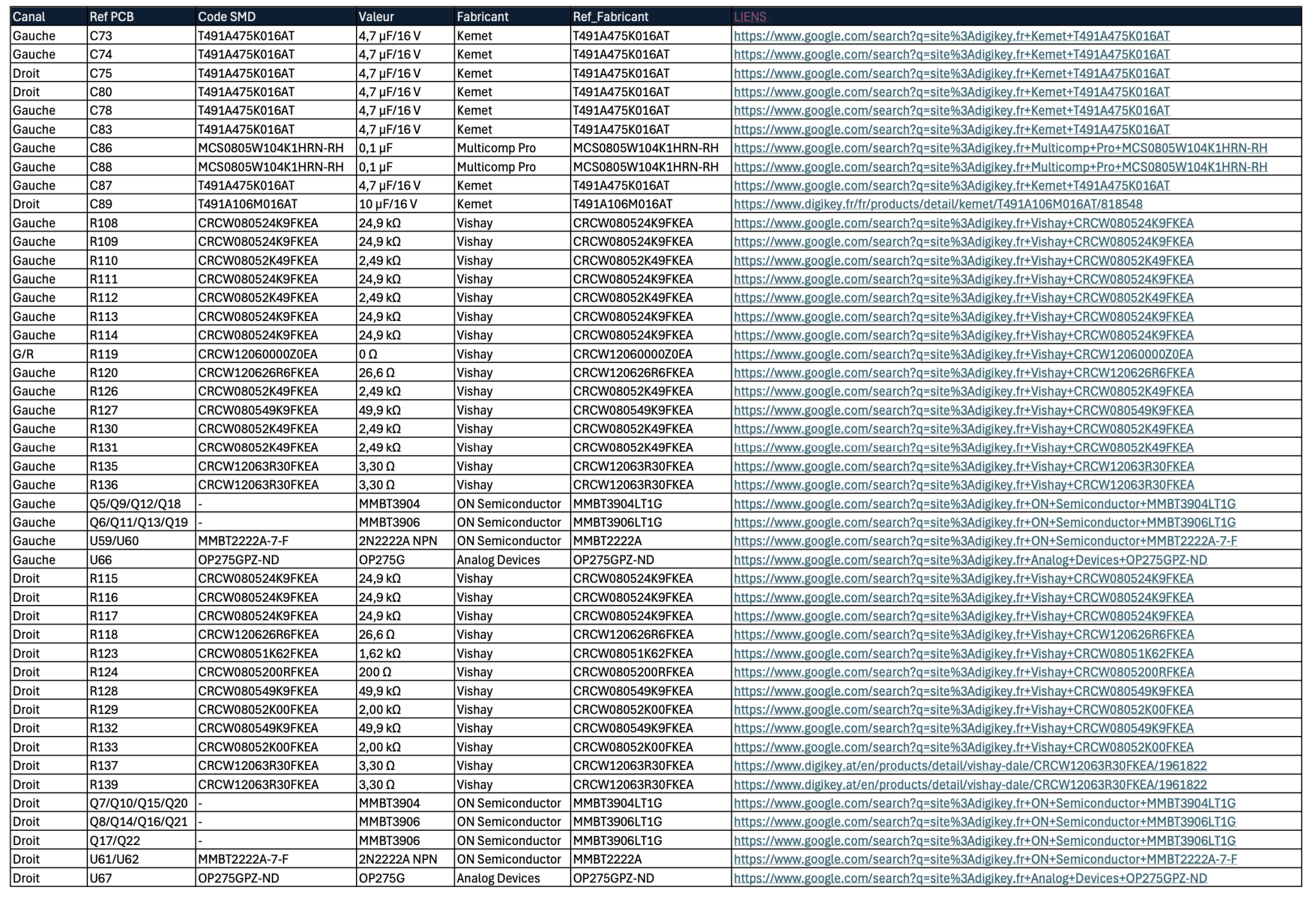

I followed your advices and did this BOM. But Lavry Eng doesn't want to check if I am right.
