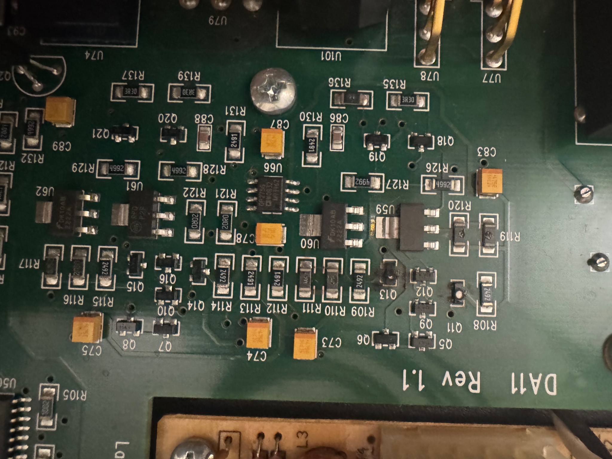

I hope you’re all doing well! I’m reaching out to this wonderful community because I’m in a bit of a pickle with my beloved Lavry DA11 DAC.
The headphone output has stopped working, and upon inspection, I found several burnt components (transistors, resistors, and capacitors) in the headphone section. Unfortunately, the markings on these components are now completely unreadable.
I’ve tried contacting Lavry support several times for component identification, but haven’t had any luck getting a response. As a former Lavry dealer in France (2007-2010), I really love this DAC and would hate to see it end up in a landfill over something potentially fixable.
What I’m looking for:
• If anyone owns a working Lavry DA11 and wouldn’t mind taking clear photos of the headphone circuit components
• Any repair technician who has worked on these units and might recognize the components
• Someone who might have schematics or component list for this section
I’ve attached photos of my unit showing the damaged parts. Any help in identifying these components would be greatly appreciated!

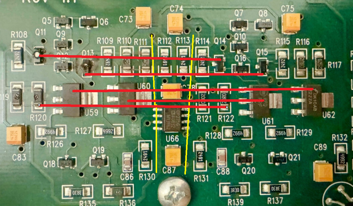

The circuit appears to have horizontal symmetry (merge along the yellow axis). This allows for the identification of certain passive component values, as well as those of the two transistors, etc. I have marked in red the relationships between symmetric parts. Also, replace the OP27. This is probably the headphone amp of the DAC.
This may help, but it may not be sufficient if the root cause cannot be identified.

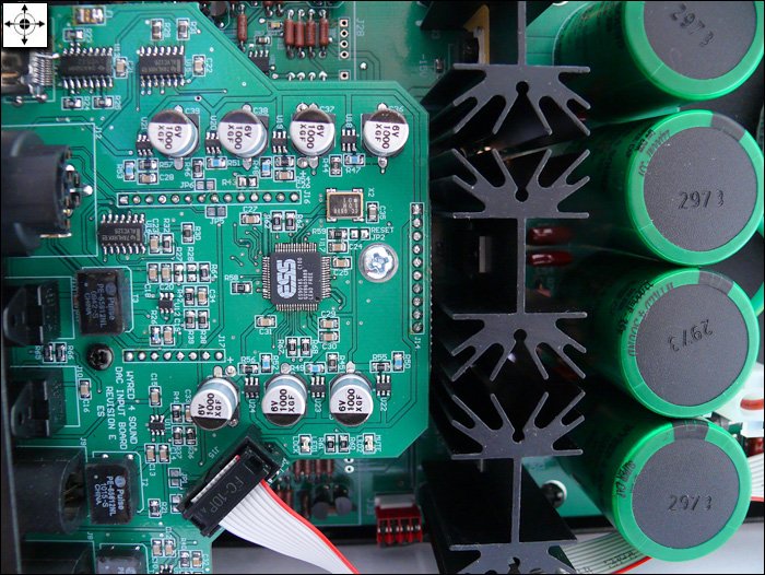

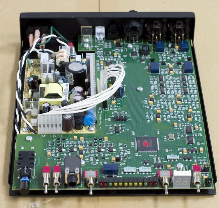

some images of DA11;
first image show a power supply modification (maybe the right solution for the problem mentioned in post #1).
Did the issue occur after connecting a new pair of headphones? If not, does the headphone you usually use work properly with another amplifier?
The first question to answer is whether the problem originates from the DAC or the load (the headphones).
I don't know. When I sold the DAC, I didn't test the output for headphones. The buyer received the Dac and told me that it didn't work with his headphones. I refund him and I retrieved the DAC. It works very well with the other output line. Maybe his headphones is the root of the problem.

If you cannot find any reference information, you can still try to replace the components based on those used on the other channel. For the two power transistors are SOT223 1W versions of the 2N2222 and 2N2907 (P2F marking) . For example, use PZT2222 and PZT2907 for U60 and U59, respectively. For the small SOT23 transistors Q6, Q5, Q9, Q11, Q12, Q13, and Q19, you will need a multimeter to test them (except for Q11 and Q13...). For the damaged ones, replace them with generic NPN or PNP transistors after determining whether they are NPN or PNP and confirming their pinout using their counterpart on the other channel. The PCB layout is identical for both channels; it is not a symmetry but rather a translation.
Counterparts :
Q6 <- Q8
Q5 <- Q7
Q9 <- Q10
Q12 <- Q16
Q13 <- Q15
Q11 <- Q14
Q18 <- Q20
Q19 <- Q21
For generic NPN I'll use (if pinout is teh same) : BC817-25 for NPN and BC807-25 for PNP, or identifiy marking on the good transistor and identify exact part number with the marking.
Also change OpAmp : OP275. for the resistors, value is writen one the good ones, ex: R120 and R119 are 20 Ohms,
I admit that this approach is somewhat random, but if you are completely stuck, it may produce a result.
But before all, you should check supply on pins 8 and 4 of OP275 regarding to ground, one can reasonably expect to have +/- 8 to 15V DC and 0V AC (no ripple), and does one of the two chanel
