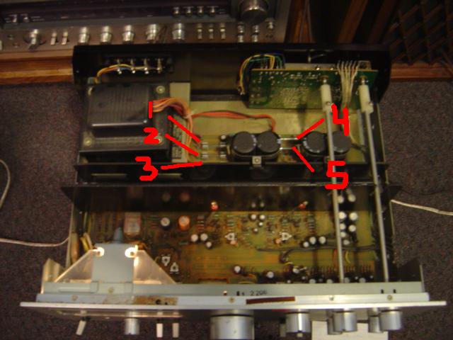

Sorry for providing half-*** info...thanks for responding anyway. They are all 1 1/4 X 1/4. From the pic it looks like this:
1 - 250V 0.5A
2 - 250V 4A
3 - 250V 4A
4 - 250V 313 V4A
5 - SOCV "A" 4A (The "A" is in a circle)
That's all of the markings on number 5. Again, thank you very much for your help.
