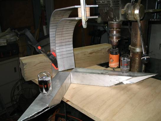

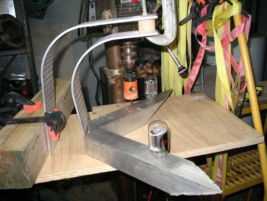

I started this project years ago but life got in the way. Here is the basic structure of the chassis. It will be sided and all welded up in the next week or so. The layout is:
-on top of the armature will sit the PTX
-right bellow that pointed down will be the rec tube
-the OPTs will stick out the sides like ears
-the signal path will be in each leg of the base
The square base tubes are 2" square by about 8" usable so there is not a whole lot of room under there.
When I get it welded up and all the holes drilled and certain it is how I want it, I'll have it anodized....maybe gold.

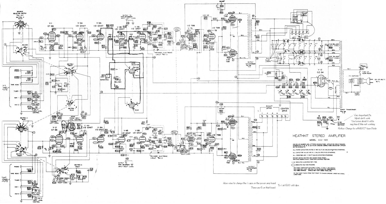

The AA-100 is a 7591 amp. The O/P transformer primary impedance is correct for the 807 (a 6L6 family member), but the power handling capability is too little. You will have to wire the 807s to operate in triode mode.
SS rectify the B+ and CLC filter. The 7199 has gone the way of the dodo. However, you can use Heath's topology, with a member of the 6U8/6GH8/6BL8 bunch.

Hi Eli. Sorry for my lack of knowledge. When you said "the power handling capability is too little" does that mean the 807 can't handle the amount of volts the PTX puts out?
Also, if I use SS rectification, will I get more volts out of the PTX?
Is the 807 part of the 6U8/6GH8/6BL8 bunch?
I am looking for a design that uses just one tube beside the output tubes. So, can you put a splitter and driver out of one two sided tube?
Finally, what does eLinear mean?
