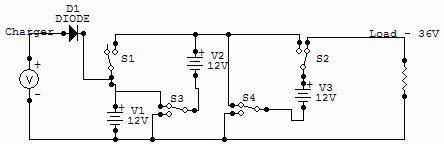

I have 3 12V SLAs arriving in a few days (my phono stage needs 36V - 45V). I also ordered one charger, because it said it could charge 4 batteries in parallel. So I need the batteries hooked up in series to drive the phono stage, and in parallel to be charged. This is where things get complicated, and I need help. I figured I could do it with a 6PDT switch. Hook up the batteries to the 6 contacts in the middle. Put the charger on one side and wire it up so the batteries are in parallel, put the phono stage on the other side and wire that up so they're in series. That should be doable, right? The problem is, I can't find any 6PDT switches. The phono stage has about 120,000uF of PS capacitance, so I want a switch that's rated for a reasonable amount of current just to be on the safe side.
So... does such a switch exist? If not, is there any other way of doing it? A separate charger for each battery and 3 DPDT switches? A 36V charger - does that exist? Will the batteries be OK if they're charged in series?
I'm sure other people here have hooked up SLAs in series to get higher voltages. How do you charge the batteries?

I think this circuit will work for 3 batteries, 1 charger, and a 4PDT switch. We ended up switching to using 2 batteries, so I never used it. So please check the circuit carefully before you try it.
The switches are all part of a 4PDT switch, which is shown in the "play" position. "Charge" is the other position.

That 4PDT schematic is pretty clever 🙂 Looks like that should work.
Thanks for all the other suggestions. I'll see if I can find a 36V charger. If not, I think I'll stick with a switch. How much did you pay for that charger, if you don't mind my asking? Also, when is your switch arriving? Once you figure out how that works, I would appreciate it if you could let me know.
