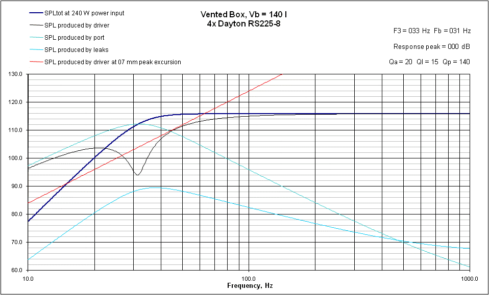

Woofers:
2x SB29NRX75-6 140L vented at 30Hz - just can't beat the compactness of dual 10"s

Is the MR16P-4 sensitivity (92.5dB @ 2.83V IB response) high enough keep up with 2x parallel SB29NRX75-6 (94dB @ 2.83V IB response)?
The SS box simulator shows a 32cm wide baffle would drop the IB response by ~5dB to 89dB. That doesn't account for any room gain.
