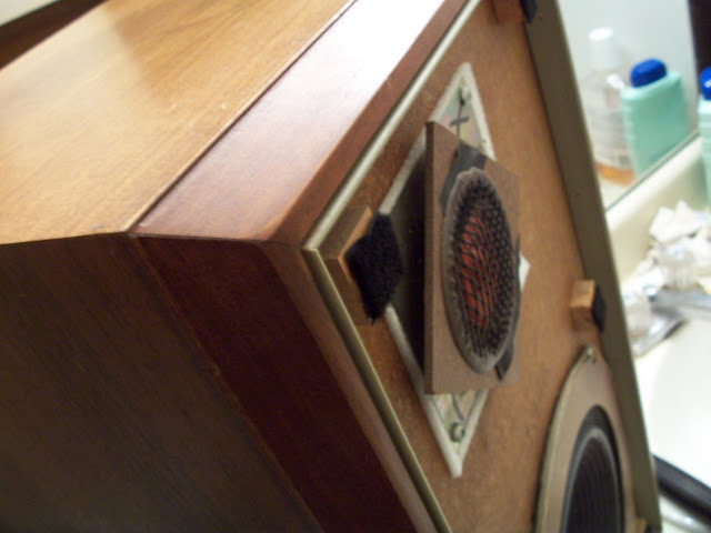

Hi there��. I don’t know where to post this Q’ regarding on tweeters. I’d inherit an old advent speakers which I believed built way back on the 70’s. Just recently while listening to the music of Michael Franks I’d noticed that one of the fried egg tweeter is not working. Try to swap the other working one to see if works and it did works. So now I’m planning to replace it with the different tweeters. I don’t know nothing about measurements but I’m leaning on buying a tymphany Vifa xt25BG60-04. Can I put this one on my advent speakers. Thanks and more power.

The specifications of the Vifa don't match those of the 'copy' Advent.I don’t know nothing about measurements but I’m leaning on buying a tymphany Vifa xt25BG60-04. Can I put this one on my advent speakers.
https://www.falconacoustics.co.uk/downloads/Vifa/XT25BG60-04.pdf
https://simplyspeakers.com/assets/images/pdffiles/P85C00019-spec.pdf
For instance, the Vifa is much more sensitive than the 'copy' Advent.
Unless you have the knowledge and tools required to make adjustments to the crossover, you may be advised to consider a pair of 'copy' Advent tweeters.
That's the original orange 'fried egg' tweeter to be precise.
Actually that is a later much prettier version of the original (i have replaced many).

Yes, thats the one. When they blew they would spew ferro-fluid all over the back of the cone in the area of the VC and all one needed to do to know it was blown was a visual check. Took about 15min to run downstairs, get a fresh tweeter, install, test and get teh ciustomer out the door with a working speaker.

Which Advent speakers do you have msj965?
Attached is an image of the 'Original Large Advent' speaker.

Shoot!! That’s why my fingers have a sticky feelin.I have the same as Galu’s fig.Masonite ring and a metal plate on the tweeter.
