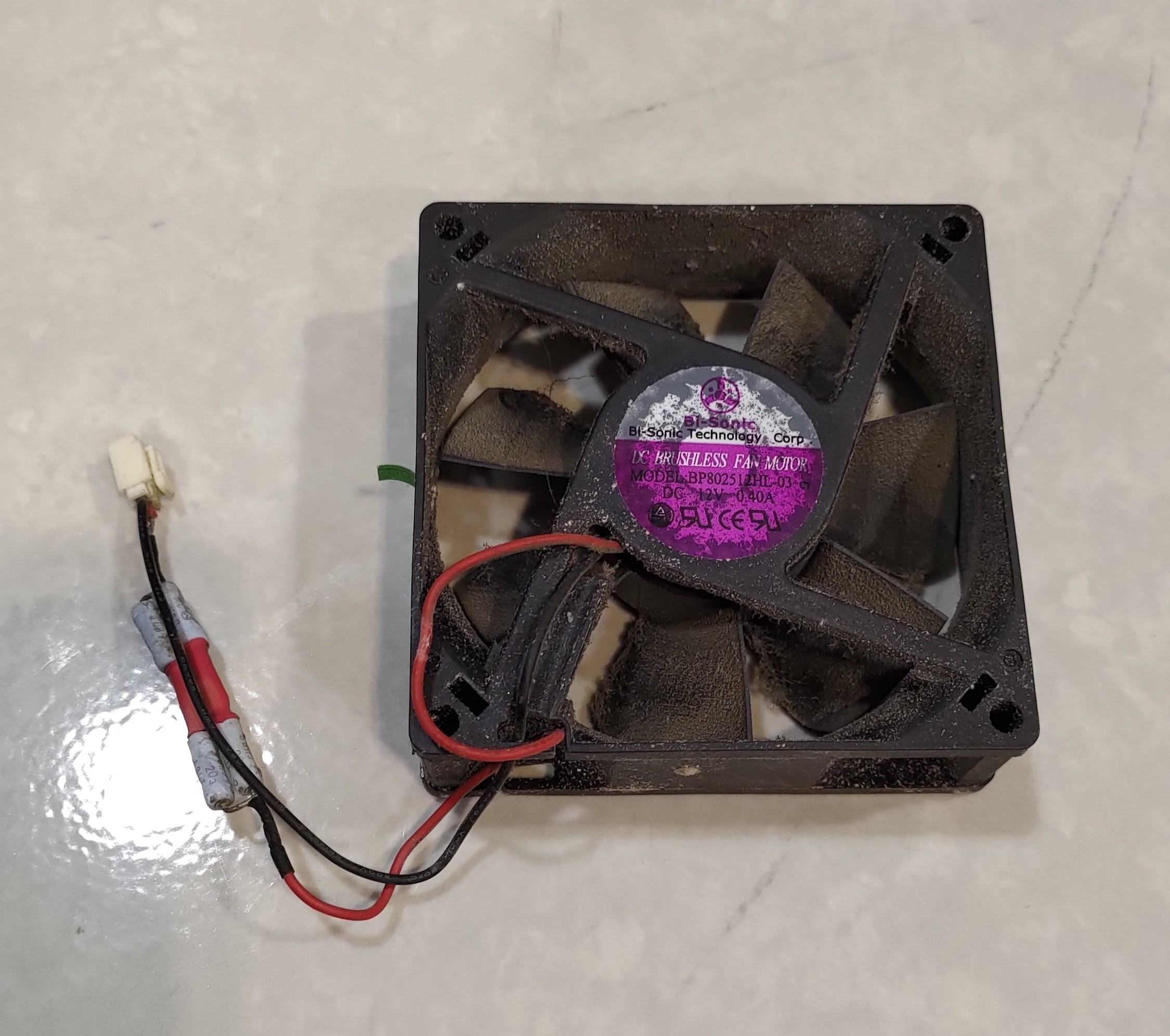

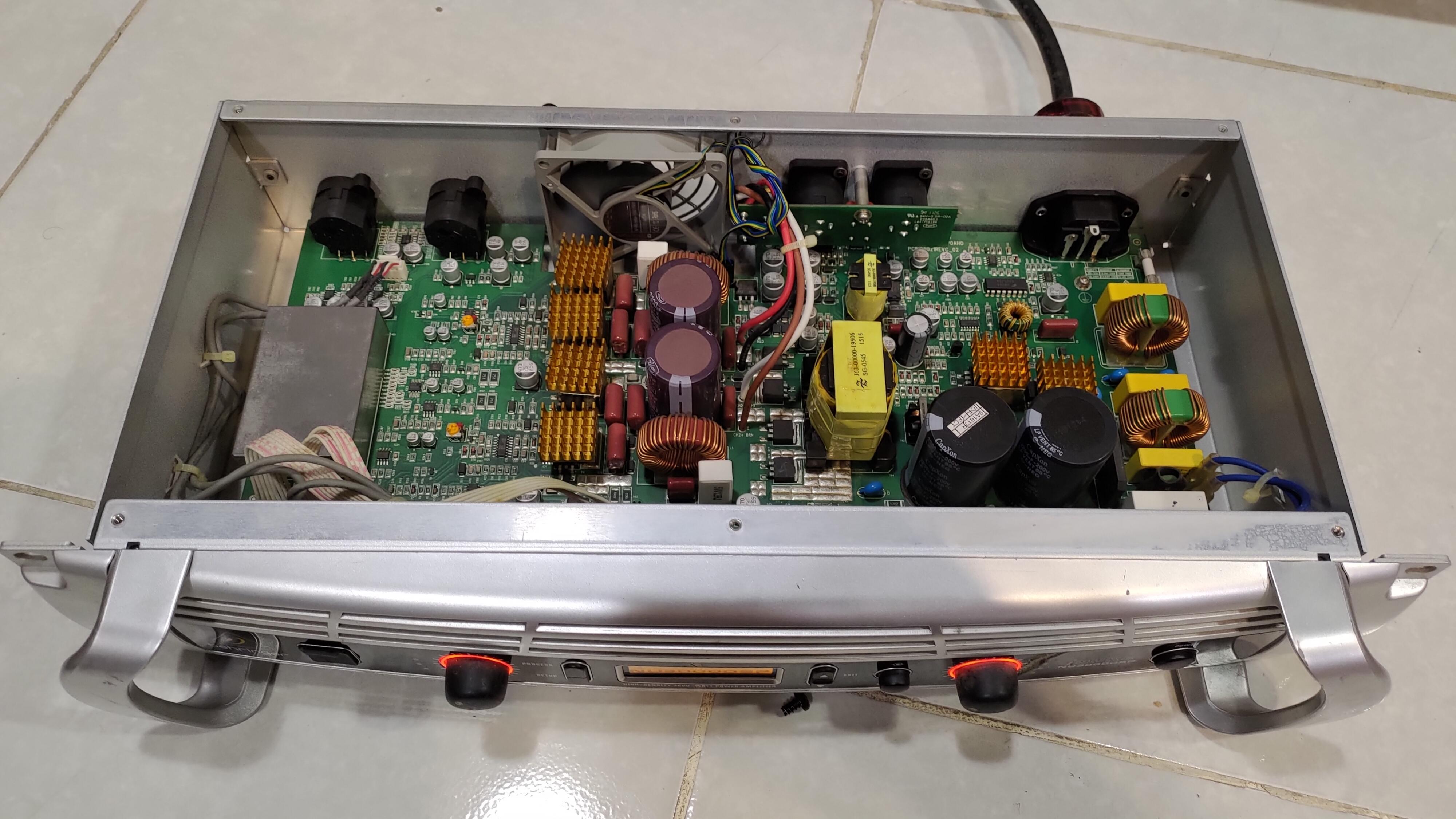

i receive Noctua NF-R8 and replace stock fan that i previously mod with 68R resistor but still too much noise on my seat 2.5m from amplifier. this noctua fan has lower amperage 0.06A compared to original 0.4A. air flow is still good with noctua but very low noise even at front of the casing.
