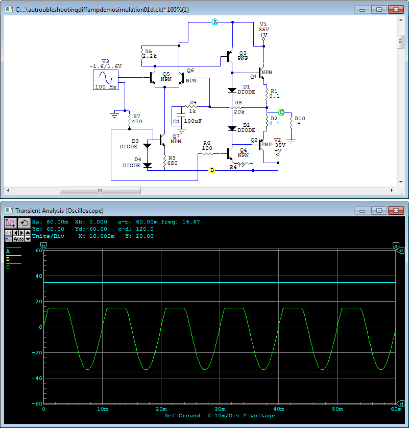

Turn the bias pot fully counter-clockwise and while watching the current draw from the 12v supply, turn the pot clockwise until you just see a small increase in draw. Load the amp with a dummy load and drive a signal into the amp (100Hz is OK) and look at the output of the amp while increasing the signal. If the amp doesn't clip symmetrically, top and bottom (below is under-biased), increase the bias until it does.
