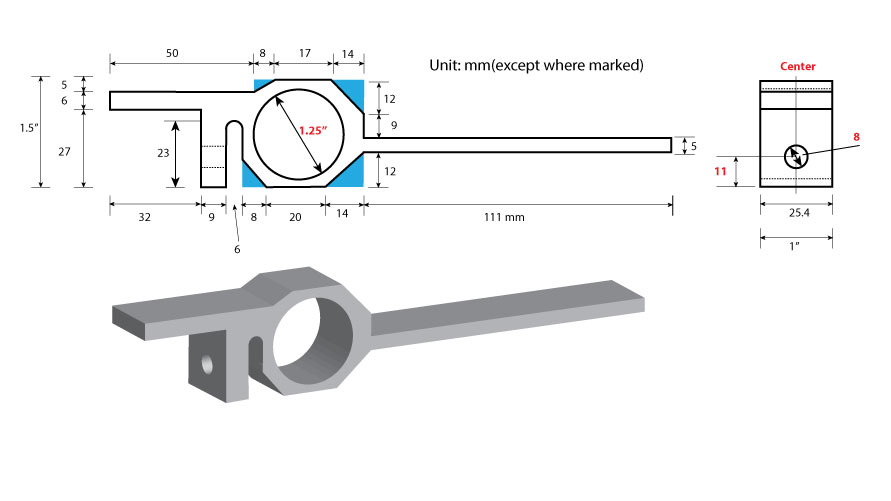

Need Help for Making a Part

If I use acrylic, I can do it myself. But I think aluminum makes sound "punchier" and more dynamic, so I chose to use aluminum. I have limited power tools and can't make the part I need with aluminum. 3D printed is plastic, too.
I could do it, depending upon how involved it is. I have my own Bridgeport milling machine but no lathe. I have access to a lathe but I would have to travel to Prescott which is a 40 mile round trip. Can you post a drawing?
There are machine shops all over the place. Have you tried finding one in your neighborhood?

I have checked with local machine shops. They simply don't want to do one piece at all. I don't think the part will involve a lathe.
Please see attached drawing. The numbers in red are important. The rest are not. They can be in tolerance +/- 1 mm or even bigger. If it is too much trouble, I can use my band saw to cut the blue areas myself. You don't need do it. These corners are really not important. They can be a little or smaller. I marked the dimensions just for the purpose of communication. You will have rough idea about these corners. I don't have any idea how you set up your milling machine. So, I can revise the design to fit your tooling and milling machine if you need. Material is 2024 aluminum. I can order a 1"x1.5" 1 foot long 2024 aluminum rectangle bar and send it directly to you. Please pm me or email me your shipping address and how much you will charge me.

A shop that does waterjet or wire EDM could do that for you. It will not be cheap. Wire EDM will give the best finish. You may have to hone or lap the 1.25" hole. The small hole you can do yourself.
AMT is a shop in Spencer Ma that does wire EDM.
