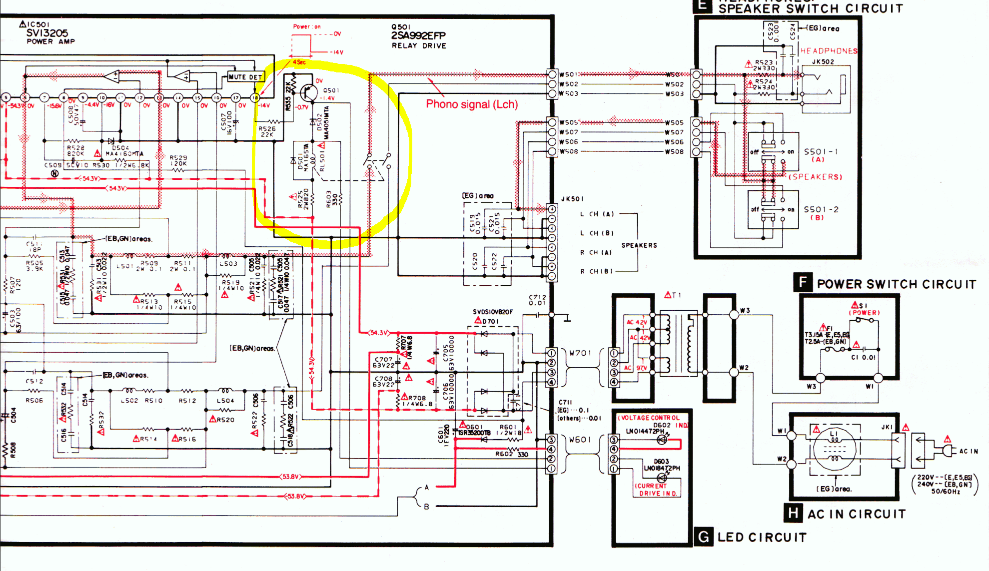

Hi !, I need some help fixing a Technics SU-V660 amp, ( it uses the SVI3205 ic that I read I can't get anymore to replace it ).
Amplifier turns on but no output , the speaker relay does not turn on.
  • The switches for A / B output work
  • No short circuit on the ic outputs
  • No short between the outputs and the Voltage rails
So I doubt the transistors in the ic are burnt.
Might be a problem with the protection circuit ? The SVI3205 ic does that ? , turns on / off the speaker relay.
Any ideeas what to do ?.
Relay measures fine, maybe the transistor and resistors around it needs to be checked.
Thank you, Bruno.
Service manual here:
