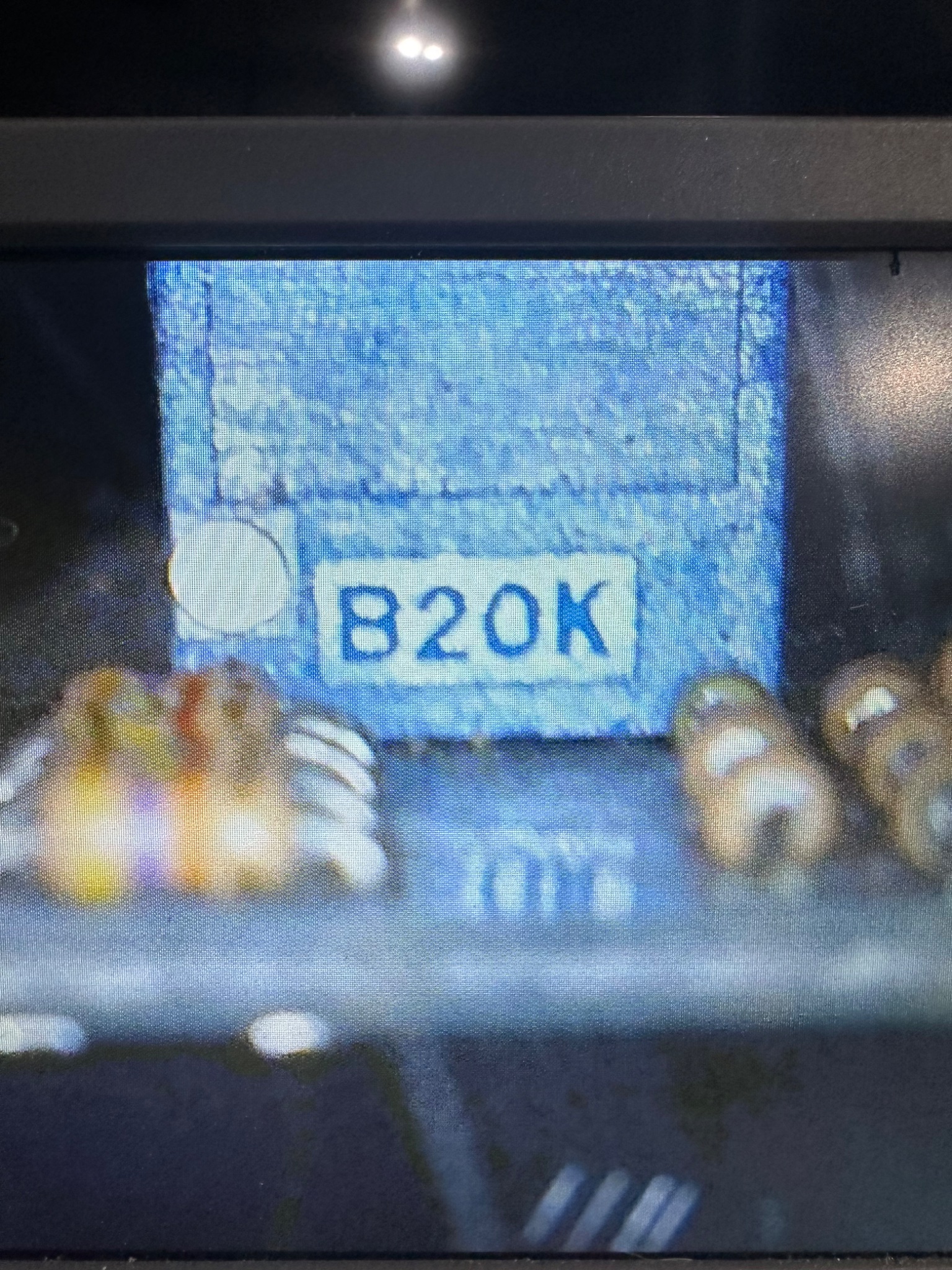

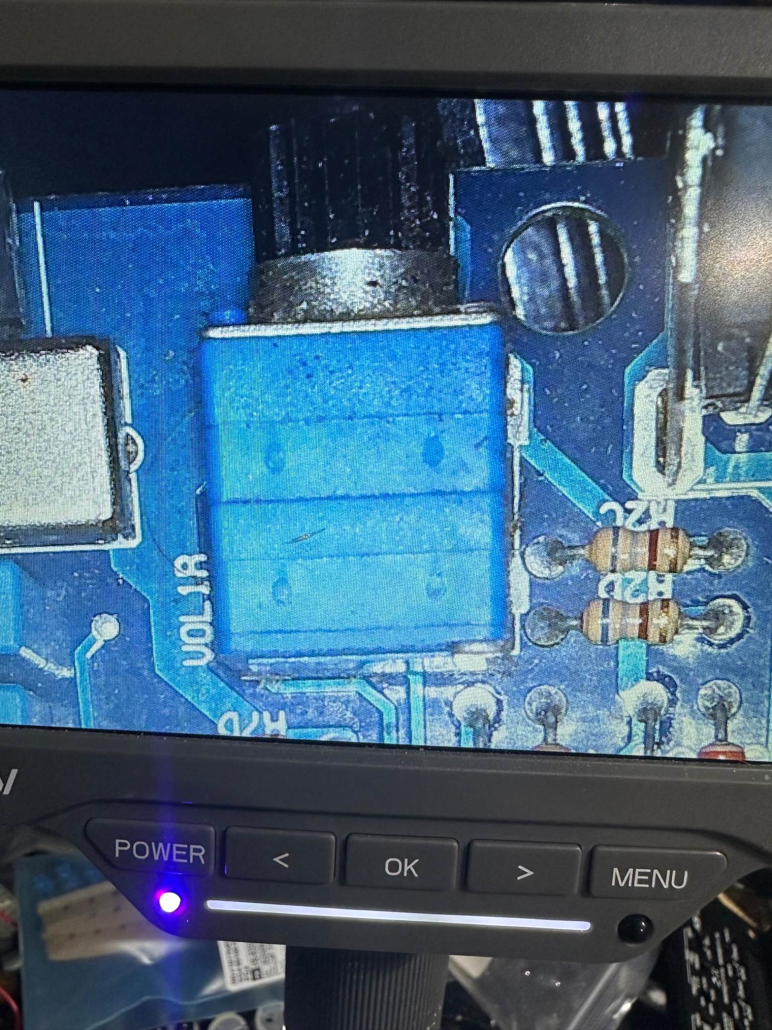

Hi, I’m working on a Digital Design car amp for a friend and I need help getting the same part. It’s a B20k potentiometer it has 6 pins, it’s blue plastic and has a black plastic screw head for adjustment. Reason for replacing is the screw head is stripped. Thanks In advance.

Would need to measure the lead spacings on the other side of the PCB to find a match, the footprint will vary between types. Alas "B" type potentiometer is ambiguous - best to check if its log or linear with a meter. I never understand how this state of affairs came to be, but A and B meaning log and lin has two different conventions - gah!
