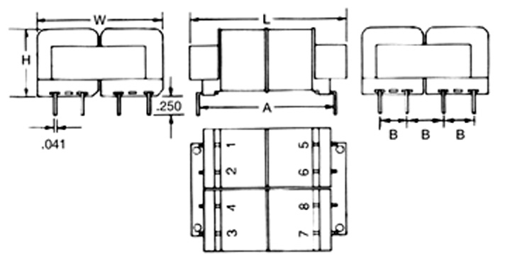

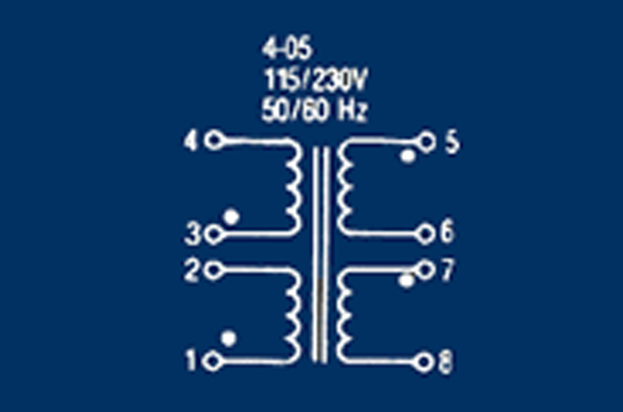

You will see is has two primaries. I know some transformers have 2x 110V to make them more compatible with different regions, but the sticker says "PRI 220V". As far as I can tell, the primary windings should be 1-2 and 3-4 (they have thinner wire than the secondary windings).
Attached is a diagram of the windings and the dimensions found here

Heya. it's approx. 16.3 x 16.3 mm.
Not sure if you might need this, but the external dimensions of the core is 79.5 x 48 x 16.3 mm.
Thanks, all dimensions help, specially to minimize possible errors.
That is a SMALL transformer, only some 7VA so meager 200 mA current, MAYBE 250mA due to semi-toroidal build ... suitable for a pre-amplifier, not a power hungry Class A amp by any means.

EDIT: as of primary winding, join 2-3 , then connect 1 and 4 to 240V mains.
To play it safe, use a lamp bulb limiter, say a 240V 5-7W fridge or sewing machine lamp bulb in series.
A real red hot filament bulb, not a LED or CFL or any space age type.
If connection is fine, bulb will blink and then become dull red or orange, if wrong it will shine bright full power, in that case invert one* of the windings, say 1-2
It shouldn't happen, phase is clearly marked, but it never hurts being extra safe.
