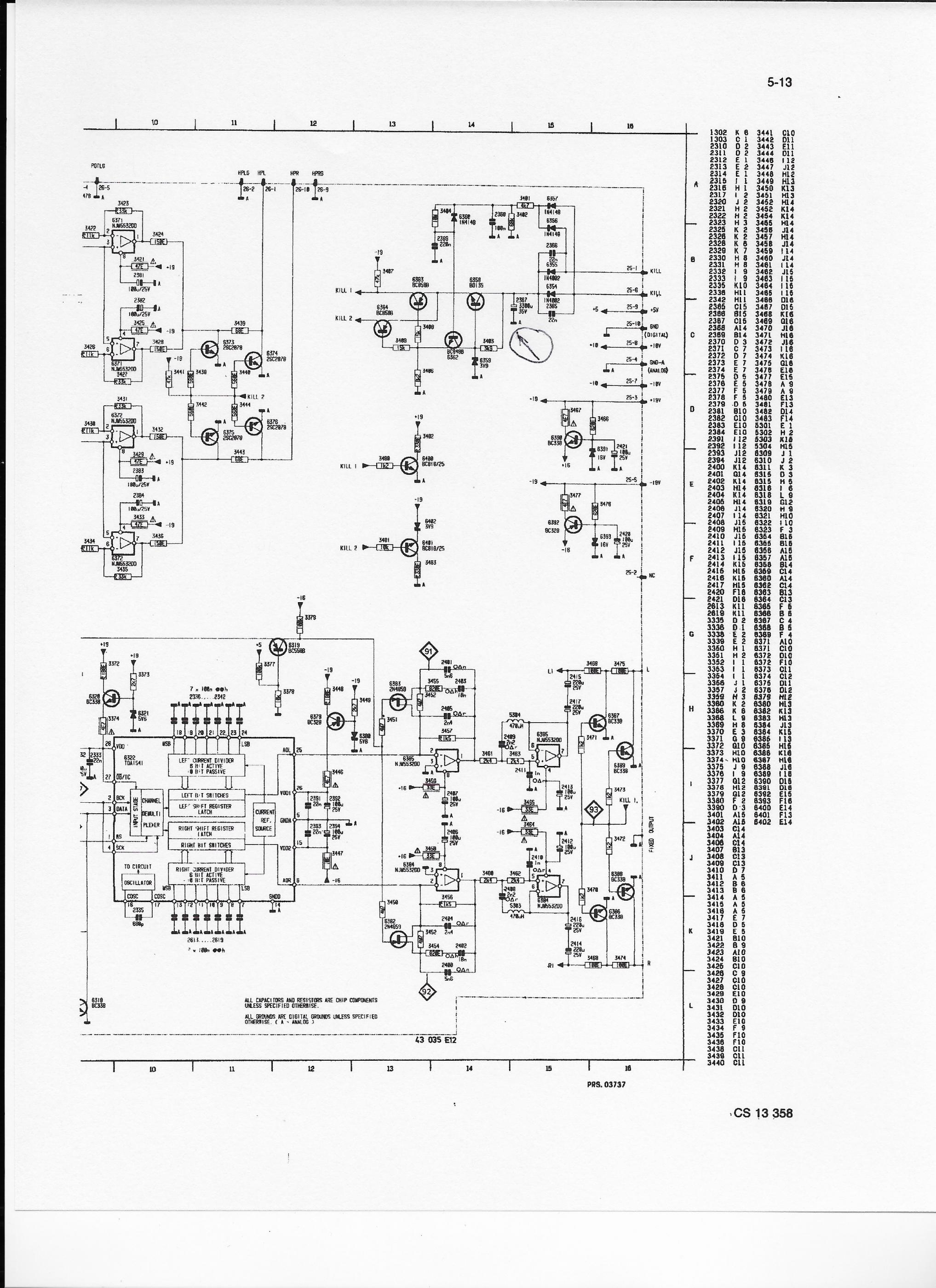

I suspected that the cap was performing a smoothing or filtering function by its size. It is the only cap of this size that is not on the PS board.
I have attached the schematic of the circuit it is used in. I marked it with an arrow. You probably will have to enlarge it to be able to read it.
I don't have the knowledge to understand just what effect it might have on the sound though.

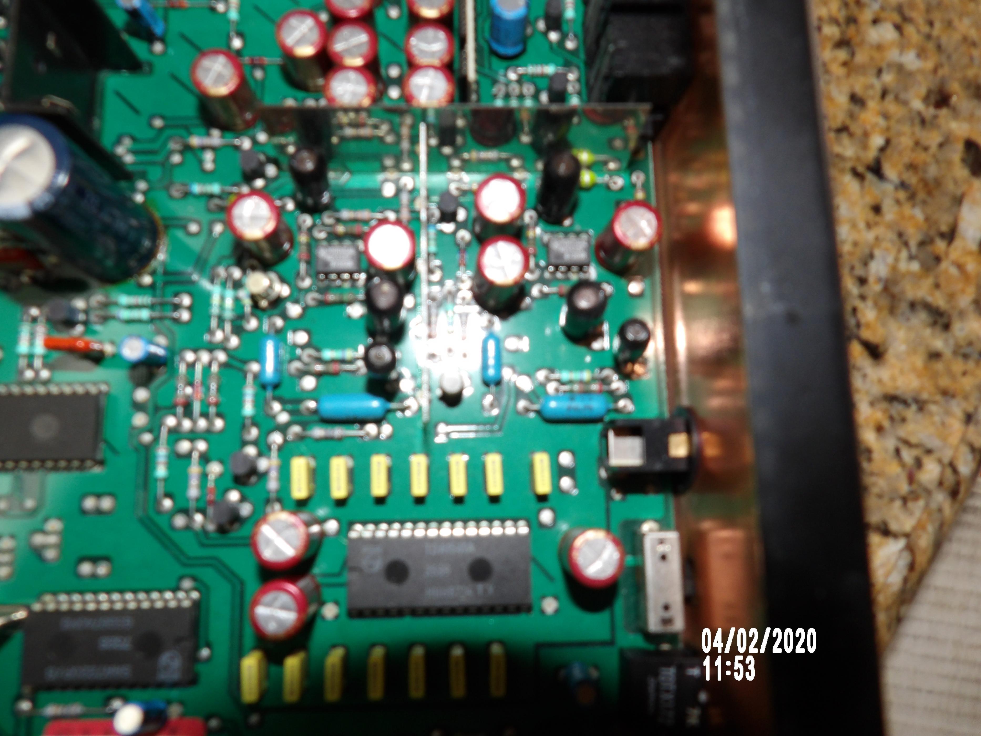

Sounds like the cap was glued in, very common practice to protect the solder joint. Can you post a pic?
Here is a picture that I had saved on my computer. It is not great but does show the capacitor (far left side of pic) I am concerned about. It is actually blue not red as my old man brain remembered. 😉

just glue to avoid vibration or desoldering and cold joint due to the same behavior. Nothing bad, just glue !
Leave it in place... nothing to say here, Philips Blue KP in the curent injection circuit of the I/V with a Fet, Thomson yellow mkt for the DEM matching, BC 8278837 low noise, NJM 5532 very low noise version (double D) ! The cerafine that is lighter match well .
The big Elna is for the SAA filter or close. Nothing bad.
You could pu indeed a Sparkos, or an opa2604, any modern double aop but not on a dip8 adaptator a the rik to make the thing worse and anyway the circuit is complex enough and you could need t adapt things between the I/V and the other oap channel that seem for the buffer... the end of the circuitry is maybe about sound atenuation with the remote but I dunno !
My 2 cents... leave it as it is, it's a high end Philips cd player. Already been there.

At re looking at the shematic, the second stage of the double op amp looks like more a filter than a buffer ! I didn't understand yet if the very low noise bc 728/738 transistors at the end are here as buffer and/or active attenuation spl level (for the remote control).
