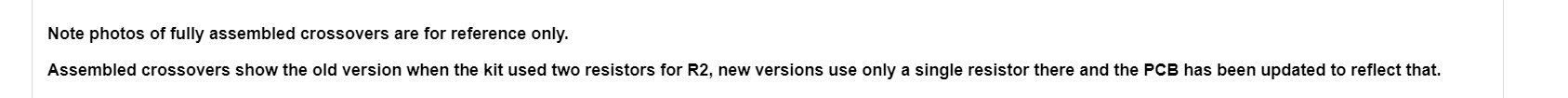

was just looking at the eBay listing for theses crossovers and came across this.
so who ever put this together had got the old version of the pcb with the new parts.
