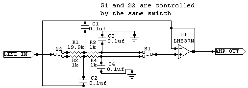

I need to build a low pass opamp crossover. Second order should be good. It needs to have a selectable frequencies of 80, 100 and 150hz. I can take care of wiring the 3 frequencies. What resistors and caps do I need for each? Also what opamp should I use? I have a 741 (somewhere) and a ton of LM324. Any chip from national I can get. I would prefer the 324. Could somebody help me by providing a schematic for the crossover? My plan is to run it off of the +- 28V supply powering the sub amp, and take power from the + and gnd through a 5V regulator (7805) and to the opamp. Any help would be appreciated.

what order of filter are you looking for? the lm324 will technically work, but isn't an ideal canidate because of the higher than optimal input noise. if the noise floor is high in your listening environment, or you just want to make something, it will pass audio though.
What chip would be best for this job? Something from National Semiconductor would be the best. Like I said in the beginning, it needs to be second order.
look for a low noise opamp. i've always used lm837n as they are very cheap and low noise. ne5532 (i think) is another classic choice. the opamps you list will work, but are not low noise type opamps.
in any case, if al you need is 80 - 100 - 150 you could use jumpers to simplify the circuit. i like the modules because you could chnage frequency and Q and even order if you make the circuit right.
there are calculators for sallen-key filters. search yahoo for second order lowpass and you'll find some.

The LM324 has class C output stages with 3VBE dead zones. It generates excessive cross-over distortion unless you take measures to bias it in class A. If you must use it, put a resistor between the output and the negative supply line with a value such that the op-amp output is always sourcing current and never sinking any.

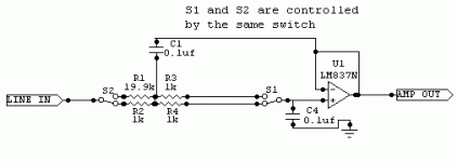

why not move c3 and c4 to the other side of the second switch so that you reduce the number of excess parts. you probably could do the same with c1 and c2.
I think I am sure on the resistor values... I used the active filter designer in WinISD Pro Alpha (a speaker design software) and typed in 80 for the cutoff freq. and 0.1 for the capacitor value. I then used circuitmaker to make a schematic for 2 channels. Why do you ask? Do they not seem right?
now that i look at the picture again, I noticed that you are right. Only the resistors for the top circuit are right... I forgot to change the bottom ones from 1K to the correct value.
i just usually see the circuit with equal resistors and different caps. haven't looked into that cicuit's analysis yet.
what 100nF caps are you going to use?

Here is an off-the-cuff unity gain 2-pole (12dB/8ve) 150Hz low-pass:
The cap values were picked to be "available", not "mathematically perfect". It has a 0.3dB peak re DC, though when you look at 40Hz and up the peak is only 0.2dB. Use 5% caps if possible, though it will still be fine in subwoofer work with 10% caps.
To change frequency, scale both resistors higher for lower freq.
72K = 150Hz
91K = 120Hz
110K = 100Hz
Use 5% resistors, 2% if they are handy. Actually, two 10% resistors hand-picked to 5% matching will work, though the frequency will be "off" by the amount of resistance "error". Take two "100K 10%" resistors, find two that are really 104K and 106K, the -3dB point will really be 95Hz and the response-shape "error" will be inaudible. But the resistor and capacitor ratios should be very close to the design: a 20% ratio error (say 0.01µFd and 0.022µFd) will change the neat corner to a slump or peak. You may not be at all unhappy with 0.01 and 0.022 or 0.033: the corner error is about one dB.

So, I think I will go with the lm837, as long as it will work
theChris-where did you come up with those 100nf caps? I am using 0.1uf.
My schematic will work, right?

well, really what you should do is get a socket and then try the lm837n vs the lm324. this way you can identify how much difference there is with these opamps.
1000nF = 1uF, 0.1uF = 100nF. for crossovers in audio i prefer to keep the nF unit as most of my filters use values between 5 and 100 nF.
