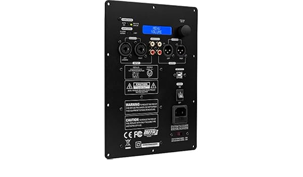

Maybe something like this will be good for bass. It has DSP 😉
Dayton Audio SPA500DSP 500W Subwoofer Plate Amplifier with DSP

That Dayton Audio product taps out its LP at 120Hz. I know because I’m trying to do DIY an active midbass module and read the manual on this specific device.

What we are saying is that going active could be cheaper (& faster) than trying to do a passive. Look at the size of parts you need if you want to try to cross that low. Decent parts are scary. 5-10mH chokes (or larger), 100-400 uF caps.
You could start with a PLLXO for XO duty ($<<20 if you don’t do a fancy case), and a decent Class D amp for the woofer can be built amazingly cheap. 1 have 2 4x100w 4Ω amps, one cost less than $100 to build, the other has a buffered PLLXO built in, it cost $200.
It also solves the big issue with finding a woofer sensitive enuff to do a passive without heavily padding the Tannoy (not something you like to do with a driver being used that low).

If building passives costs anywhere near half as much as a pair of plate amps, it's a no brainer to go active. The plate amps would just have to have high level inputs as to not complicate setup all too much, so the only inconvenience at that point would be one power cord per tower speaker.

With a subwoofer amp that is pretty much how you have to do it. XO will be wherever a Q=0.707 sealed box has its F(-3).
It likely is. Especially since you are not likely to get a passive right on the 1st pass.
You don’t need a high level input (althou if you have a set of variable level pre-amp outs line level is preferable). The subs i have in my living room most often get hooked up with speaker wires coming off the mains terminals.
