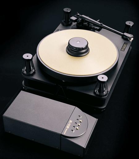

I'm now listening to a SME20 with an SME-V arm. This thing blew me out of my socks.
Comming from a Linn LP12 with a custom VDH cartridge, I thought I reached the top quite close. How far could I be wrong.
The SME20 with the V arm just has no sonic signature at all. It is simply not there. Using it with fairly simple cartridges will already give ashtonishing results.
