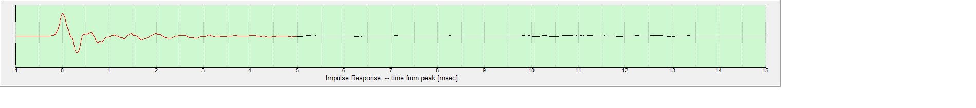

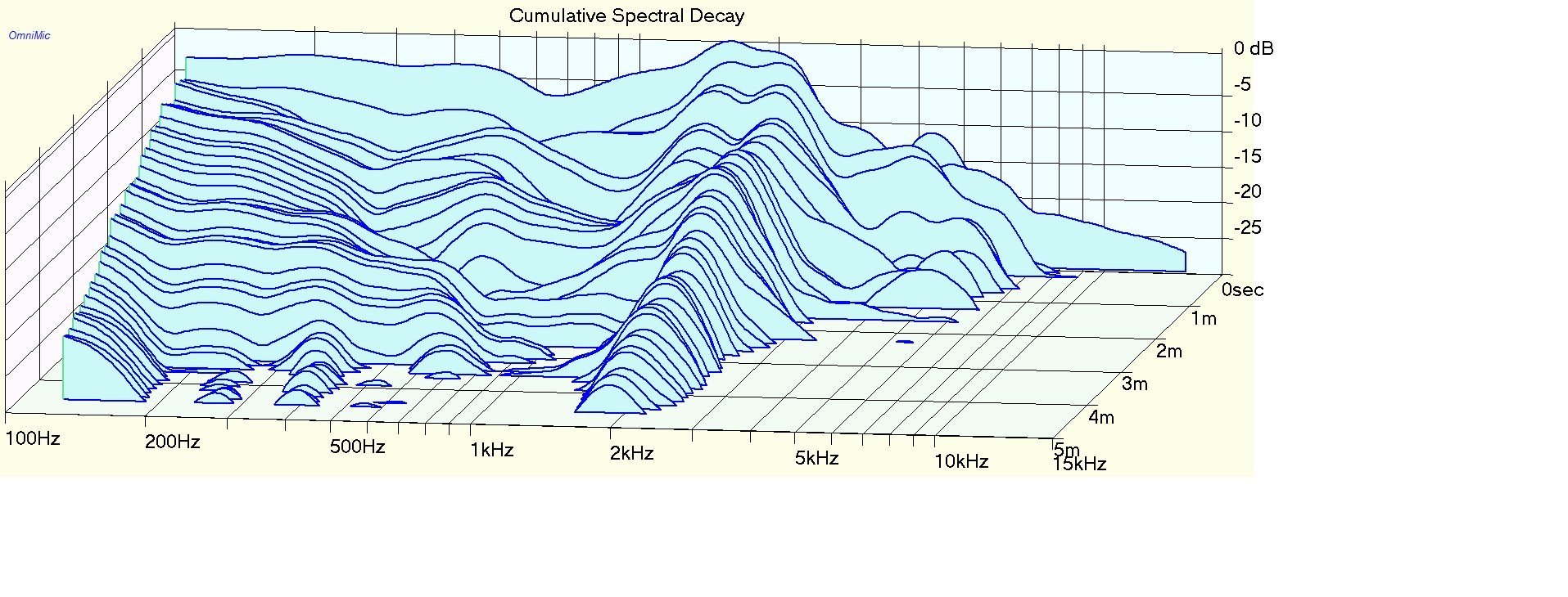

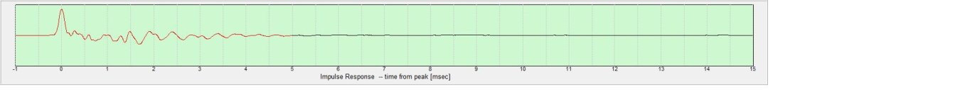

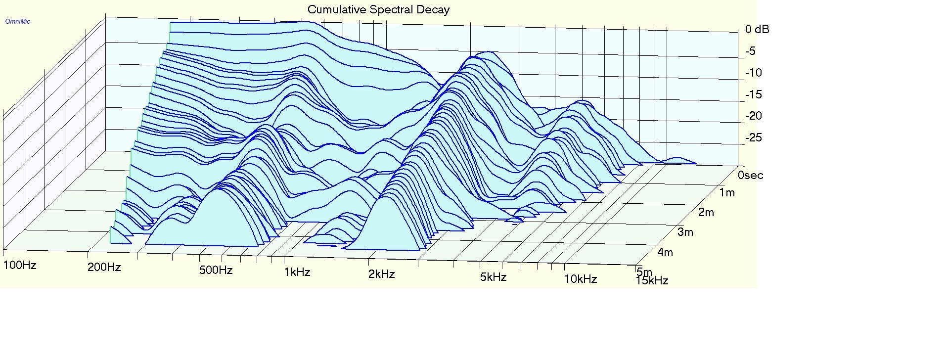

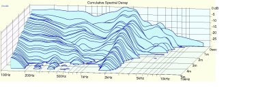

However after much listening and playing with cross points it seemed to me that the woofer may not be quite up to the clarity of the planar in the midrange. It just didn’t seem as clean as the planar and there was some hardness on some male voice and some muddy blurry sound on some drum decay. Things were better with lower crossover points BUT the planar is weak down there.

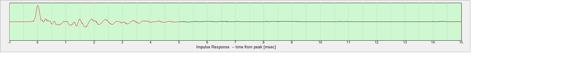

So I did some measurements on the woofer and I see an ugly “tail” in the CSD plot in the crossover region despite smooth FR through this range. (See the tail in attached pics CSD between 300 and 700 hz). At this point I thought it would be great to have a woofer that didn’t exhibit this trait to do more listening test and see if it really matters.
I had two thoughts. 1- a woofer that behaves more like a piston through this region like an exotic honey comb cored skinned thing or maybe an aluminum cone unit ? OR, 2- is it simply that I just need a higher quality and more refined woofer?
After looking, I find that I cannot answer the question on a standard woofer that’s simply more refined. The data is not available. AND I find that exotics like skinned honeycomb or aluminum are rare and expensive and a bit lacking in wanted sensitivity.
So I decided to do a crude brut force test and just make a “piston” myself. I have some experience making foil skinned foam cored “bricks” ha, similar to what was done years ago by KEF I believe. Although my example is hardly to their standard, they do easily exhibit piston like behavior through the region im concerned with here. So, I shaped some polystyrene foam with a combo of cheez grater and the 12 inch PE cone lined with 80grit sand paper strips as the finishing work. See pics for a good laugh. This gave me a solid wedge of foam that fit snugly into the 12 inch cone. From there I sprayed the foam with adhesive (3M super 77) and skinned it with .001 inch thick Al foil, then sprayed the cone and wedged the thing in. Perfect fit.
Sure enough the “tail” in the CSD plot between 300 and 700 hz was gone. Sensitivity took a 4 db hit but I compensated for that by padding down the planar.

The stock PE cone I used has a level response BUT the foil skinned unit has a gently rising response on axis up to point where it rings hard around 2khz.

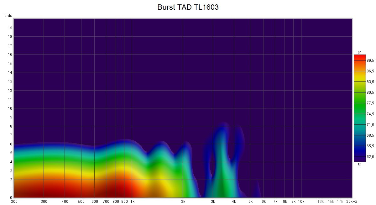

If the OP is focusing on clean decay in the normal band, hes better served looking at a well damped driver, but that brings him to exotics like TAD, Fostex and JBL etc.
