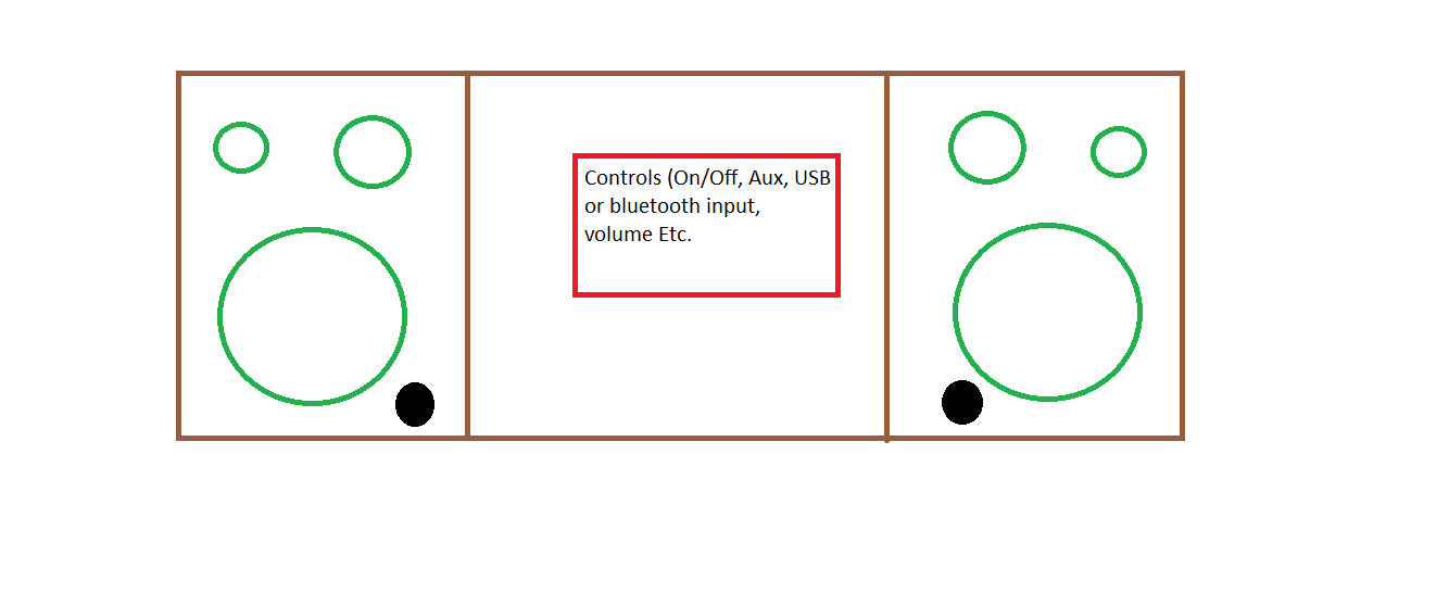

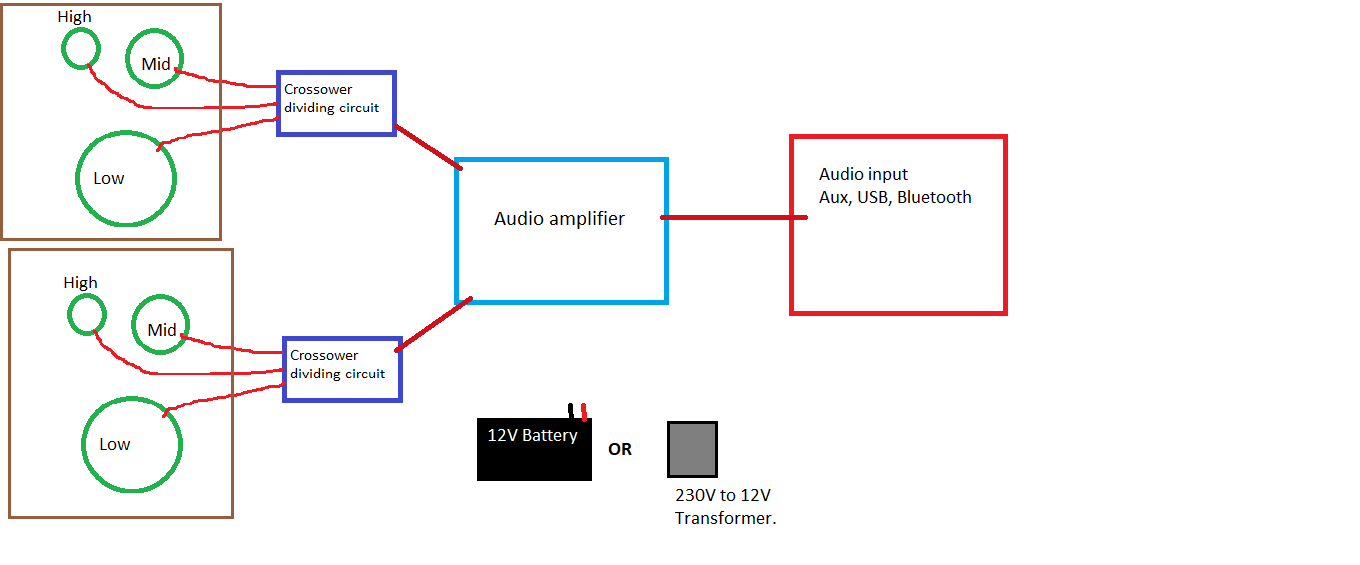

I'm thinking of building boombox/ portable speaker, i have an idea how to make the box for the amplifier, speakers, input board and battery or transformer (im thinking to put 12v small car battery and transformer so i can use it to power it up trough main voltage or trough battery)
this is how i planned building it (this is rough demonstration)
I want to keep it on budget, i don't want to spend a lot of money on it.
What i need is some good amplifier board to run the speakers, 30W-50W per channel will be good i think 😀
What resistance speakers would i need? (4Ω, 6Ω or 8Ω?)
Should i make it with 2-way or 3-way speakers? What is better and why?

There are some videos on youtube building something like this but all of them are using car radio for input and output. Should i use car radio too? 😕
Edit: i fount these amplifier boards on ebay but i don't know if they are good (I was researching for some amp Boards and i found these. If you have some better suggestion for amp Boards please tell me.
XH-M510 TDA7498 Receiver Digital Stereo Audio 2X100W Amplifier Board Module a | eBay
x2 of these for Left and Right speakers ( i want to be Stereo)
TPA3116 D2 DC DA 12V - 24V 100W Mono Channel Digital Power Audio Amplifier Board 827159755946 | eBay
DC 12V TDA7850 4X50W Car Audio Power Amplifier Board Module BA3121 Denoiser | eBay

How big you want or think to build it? that will drive the rest of decisions on what approach to take

Garrbage I'm not sure how big i want the enclosure to be but i think around 50cm-60cm or 20inch-24inch (maybe a little more) in length, height idk depend on the size of the speakers and number of speakers and width im not sure but i will make it as compact as i can. First i want to get the electronics parts, then i will build the box to make sure everything its fitting.
