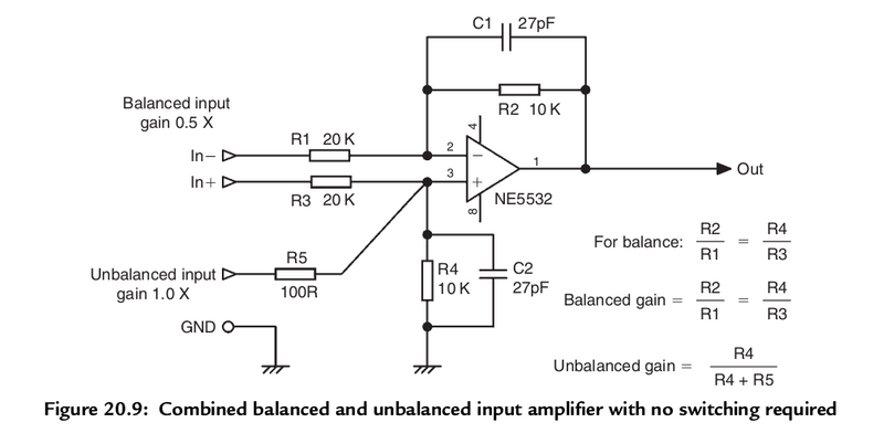

I'm currently designing an 5 source input board. Therefore I'd like to have one RCA and one XLR Input for each source. Is there a way to combine RCA and XLR Inputs without a physical switch or a jumper or a piece of wire inserted into the XLR Connector?
I found Rod Elliotts Circuit for a balanced line input circuit transforming balanced input to unbalanced output.
Source: Balanced I/O
Is it possible to wire the circuits output with the RCA Input connector? Obviously you should then only connect either RCA or XLR, but that's exactly the way I would like to have it.
Each channel would have one of these circuits for each left/right channel, which are then switched by relays on one unbalanced output. I have no problems with the relay channel switching. I just need to know if the above explained way of connecting XLR and RCA per channel per source together would work.

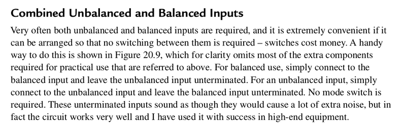

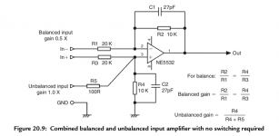

If I'm not mistaken Douglas Self addresses this on his small signal design handbook book related to the Cambridge Azur but I'm not sure..
